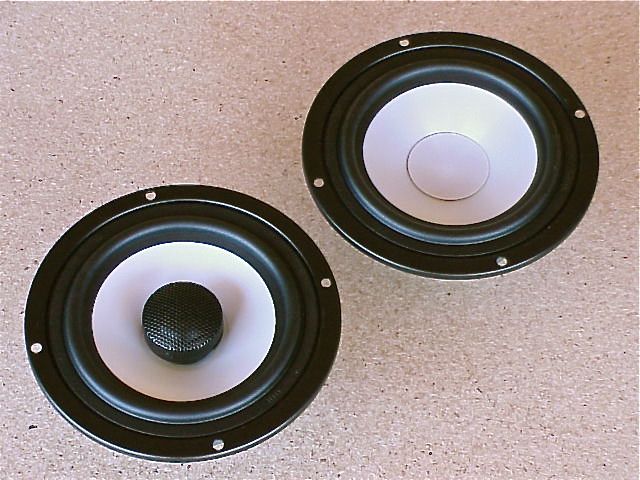

Most coaxial speakers approximate a point source, but that doesn't make them a fullrange single driver loudspeakers. To tell you the truth a single driver with a whizzer cone is actually a 2-way driver, as the crossover is mechanical rather that electrical. It gets pretty confusing with the addition of bending wave drivers, etc.

\To tell you the truth a single driver with a whizzer cone is actually a 2-way driver, as the crossover is mechanical rather that electrical.

The bass is augmented by the cabinet design, but the output is still provided by the driver. It can, as you have apprenended, get pretty confusing, although for our speaker contest a fullrange speaker is basically defined as one without an electrical crossover.

A single driver does give you a single point source, it has no crossover (especially important in the midrange/vocal frequencies) that can introduce timing/phase problems. The ability to reproduce the music is dependant on the driver/enclosure combination as well as the need for synergy with the amplifier. If these are optimized the results can be quite beguiling. More than one very experienced speaker designer/builder has been astounded by how beautiful the music sounds, through a fullrange/ single driver type system.
I might add that while crossover design for a multi way speaker certainly isn't easy when seeking excellent results, a "fullrange" (actually, extended range is more accurate) speaker design is quite a bit of work itself, as it tends to be a holistic approach. Just the same, it certainly isn't due to a lack of skill that people have taken the seemingly simple "fullrange" approach, but rather a quest for the best sound.

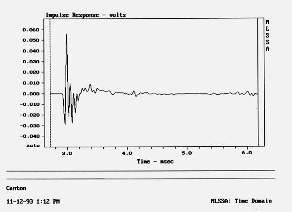

make a step response than you will see the difference,
every "more way" has a crossover, different acceleration, different

look here Manger Basstuba step response and impuls
and a superb canton 3 way impuls, you see the impuls is destroyed by the three way.

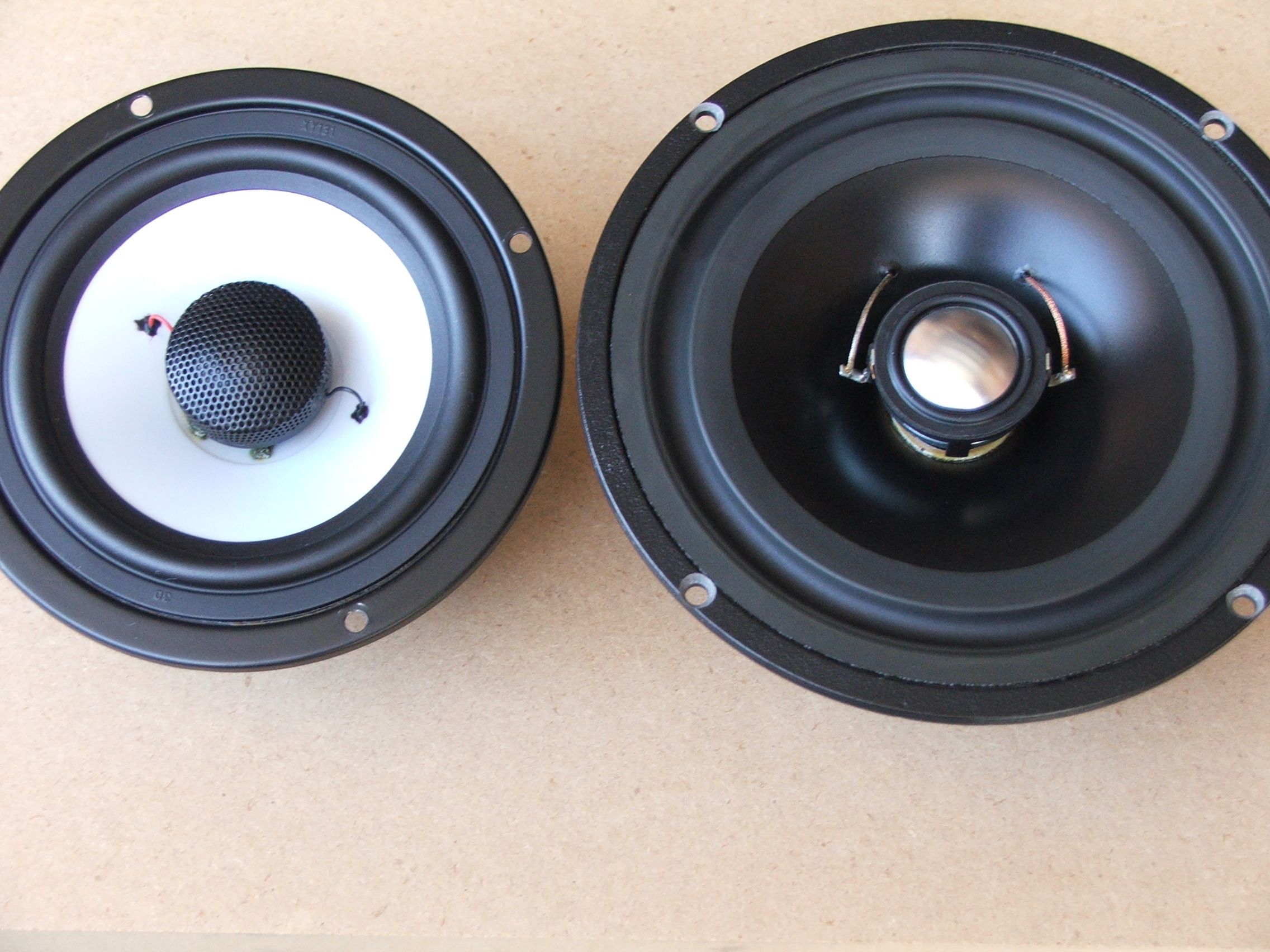

To the original question, I agree with TerryO, a coaxial driver would not be considered a full-range driver because it needs a crossover.

There doesn't seem to be an argument when it comes to accepting "helper tweeters" in this forum so why not add coaxials to the list. As mentioned earlier, most of the sound the coaxial produces would be cabinet dependant as opposed to cross-over dependant (as full rangers are), so I don't think they qualify as multi-driver anyhow.
