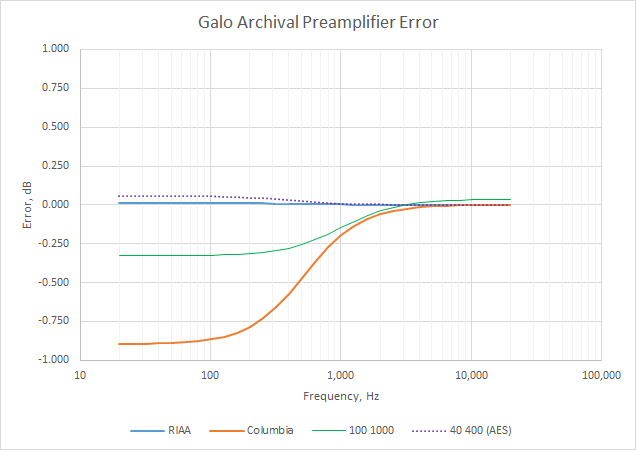

I took the old values from the Linear Audio article, and EJP's new T5 values and simulated (Multisim). Then compared with the calculated values for T3, T4 and T5 using Laplace for the RIAA, Columbia, 100/1k and 40/400 (AES):
I haven't given any values for T5. Only for R5, and they are Marcel's, not mine, or at least they are results of his formula.
What do the graphs mean?
The graphs represent the difference between the theoretical gain, and the simulated gain with the values Galo used, and those calculated by Marcel.

OK well to comment, the only one that's correct in the second graph is RIAA, and that's the only one for which the calculated value for R5 wasn't used. A tweaked value was used, closer to the value given by Marcel's formula.
Viewers should note that the scaling in the Y axis differs by a factor of 20 between the two graphs.

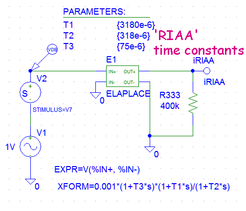

In this context: most SPICE packages have a function block which takes equation parameters and models the frequency response of that equation. The RIAA curve can be shown roughly by RCA's bad drawing of "New Orthophonic" or exactly by specifying poles/zeros. The SPICE function is often called Laplace after some old guy.
https://www.analog.com/en/technical...pplying-the-laplace-transform-in-ltspice.html
Property Symbol(s) PSpice Library Description Required Default Units
NUM LAPLACE ABM Numerator of Laplace transform Yes 1 none
DENOM LAPLACE ABM Denominator of Laplace transform Yes 1 + s none
"In mathematics, the Laplace transform....is an integral transform that converts a function of a real variable (usually, in the time domain) to a function of a complex variable (in the complex frequency domain, also known as s-domain, or s-plane)."
