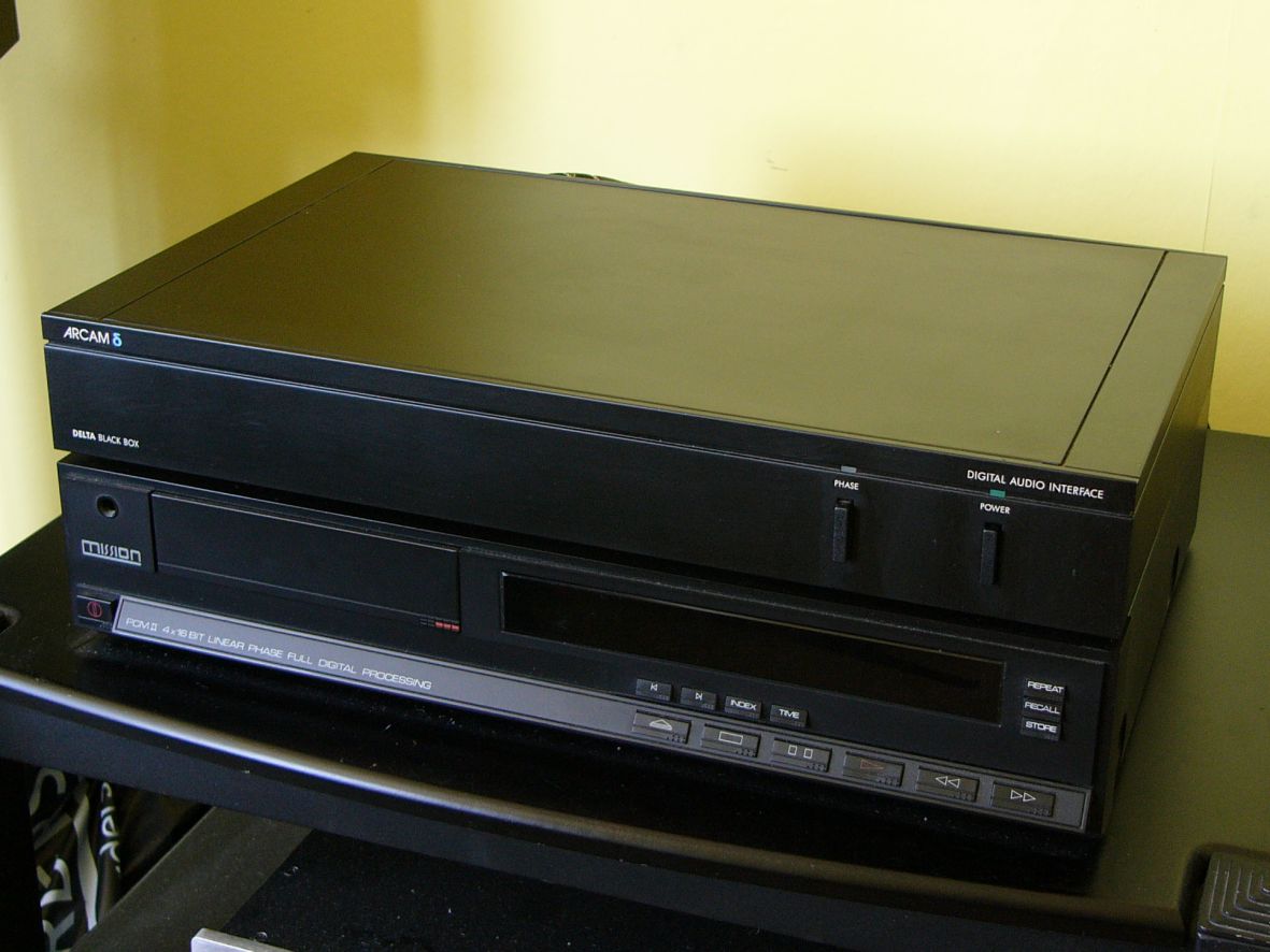

a) The Black Box on top of the transport I'm currently using, a Mission PCM II. Nice match visually.

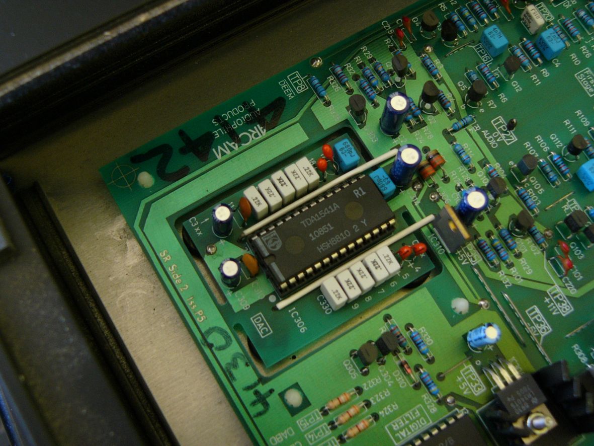

b) The isolation cutouts in the mainboard that minimize vibration in the DAC IC. At the moment I'm just using a low grade R1 TDA1541A, when I've changed the -6V rail to -5V I'll install an S1.

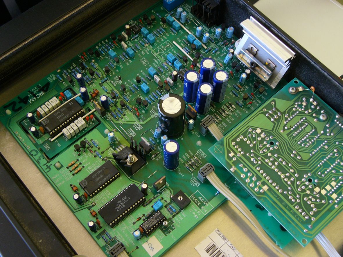

c) The mainboard. I haven't finished replacing the electrolytic capacitors, dark blue and brown are new, light blue and black are yet to be replaced.

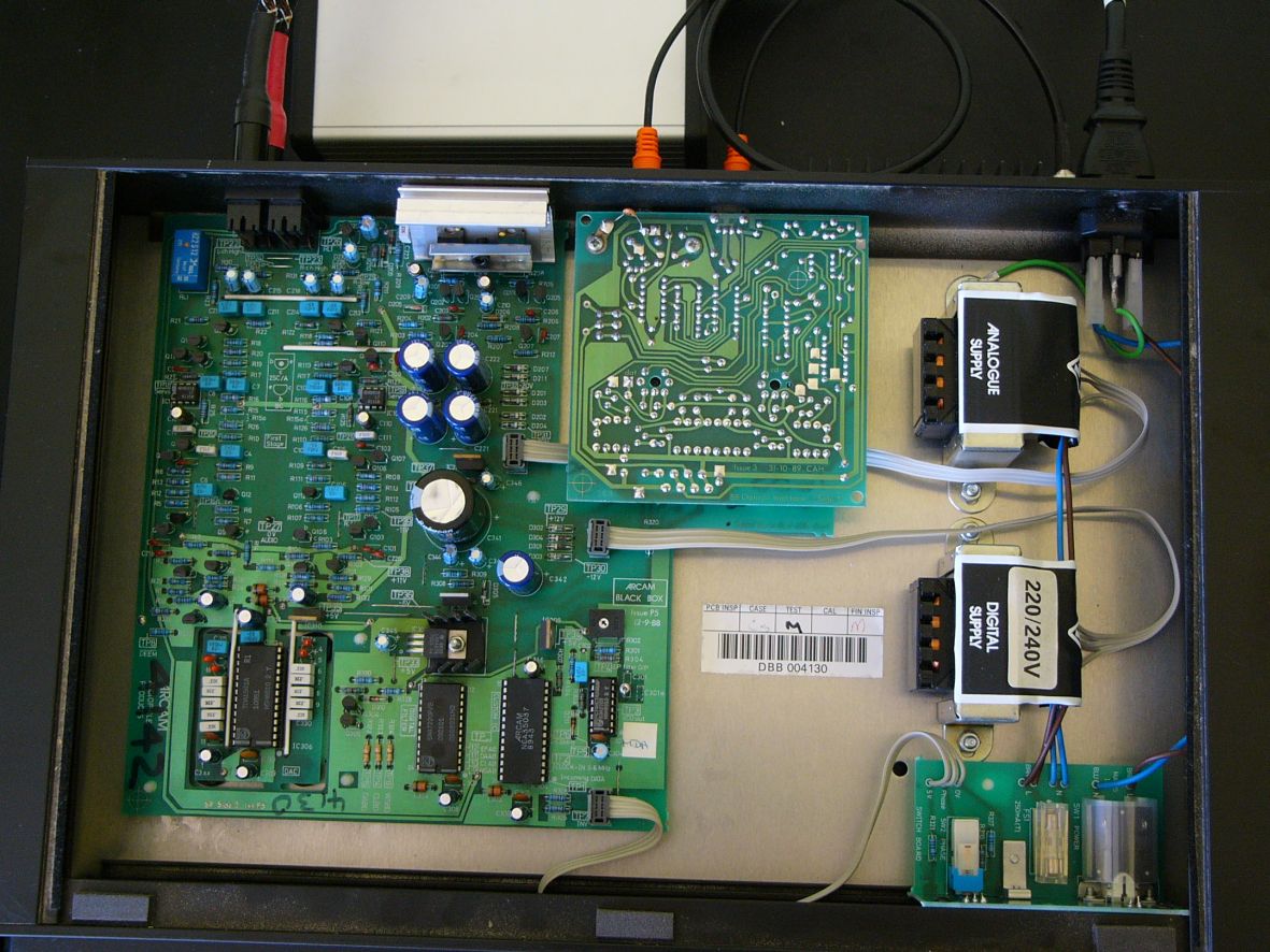

d) The whole thing from above. Mainboard at the left, input board at top centre, transformers at the right. The silver case at the top of the picture is my low noise clock which feeds the PCM II.
