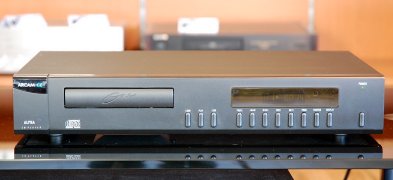

Arcam Alpha I
No, there is no 'I', no '1' or 'One', there is nothing, it is called an Arcam Alpha. They are not different versions, they are completely different players and were released some time apart. The blog you quoted is written by me, I'm fairly familiar with it.
about Arcam's homepageNo, there is no 'I', no '1' or 'One', there is nothing, it is called an Arcam Alpha. They are not different versions, they are completely different players and were released some time apart. The blog you quoted is written by me, I'm fairly familiar with it.
Discontinued Products
this (and some other) model isn't mentioned

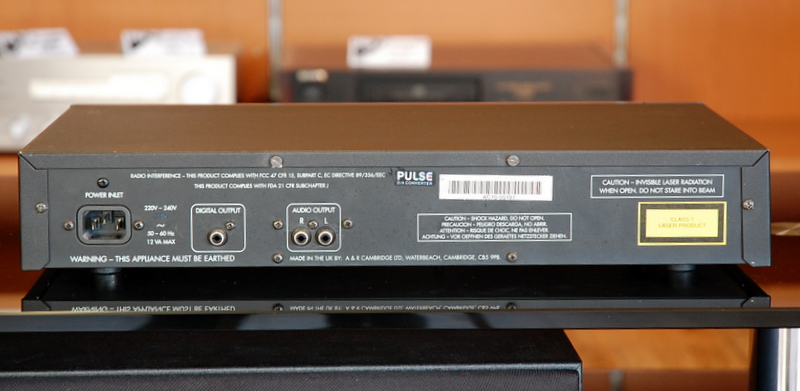

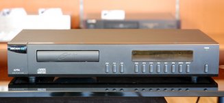

I think, you mean either the device from the first two attached pics, found by ebay item number 330647951301
(on the rear side no model number is to read at any sticker) or the third pic, also without 'I', '1', 'One' or any other additional number resp. suffix.
Do you now a website, where is to find a complete list of all exist models?
