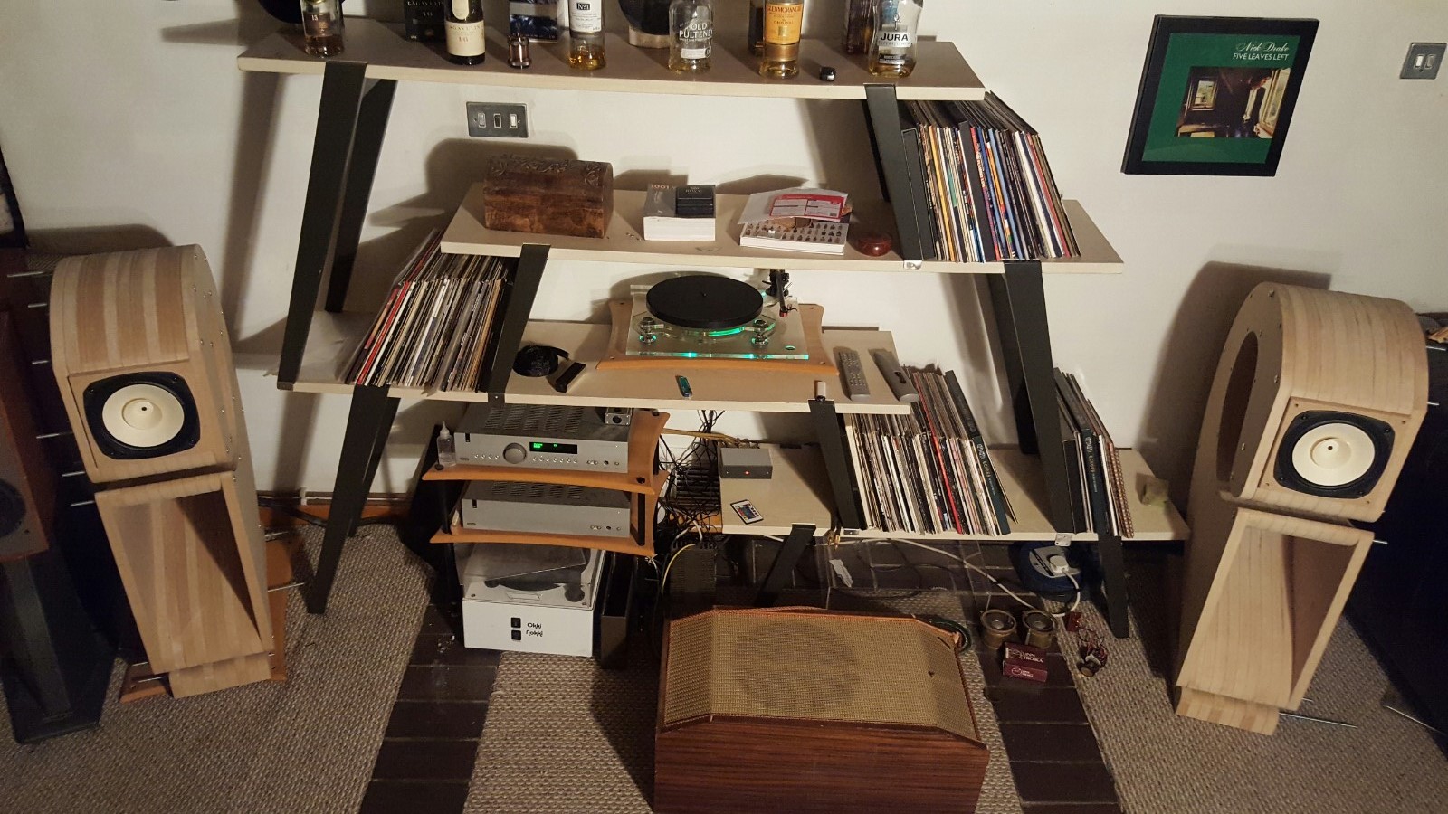

Yes I was kind of doing something like that in the end, I split my phono signal after my phone stage, sent one to my arcam's and one to my quad 34 (which has the bass lift and tilt then to the 303 and finally to the wharfeldale's.

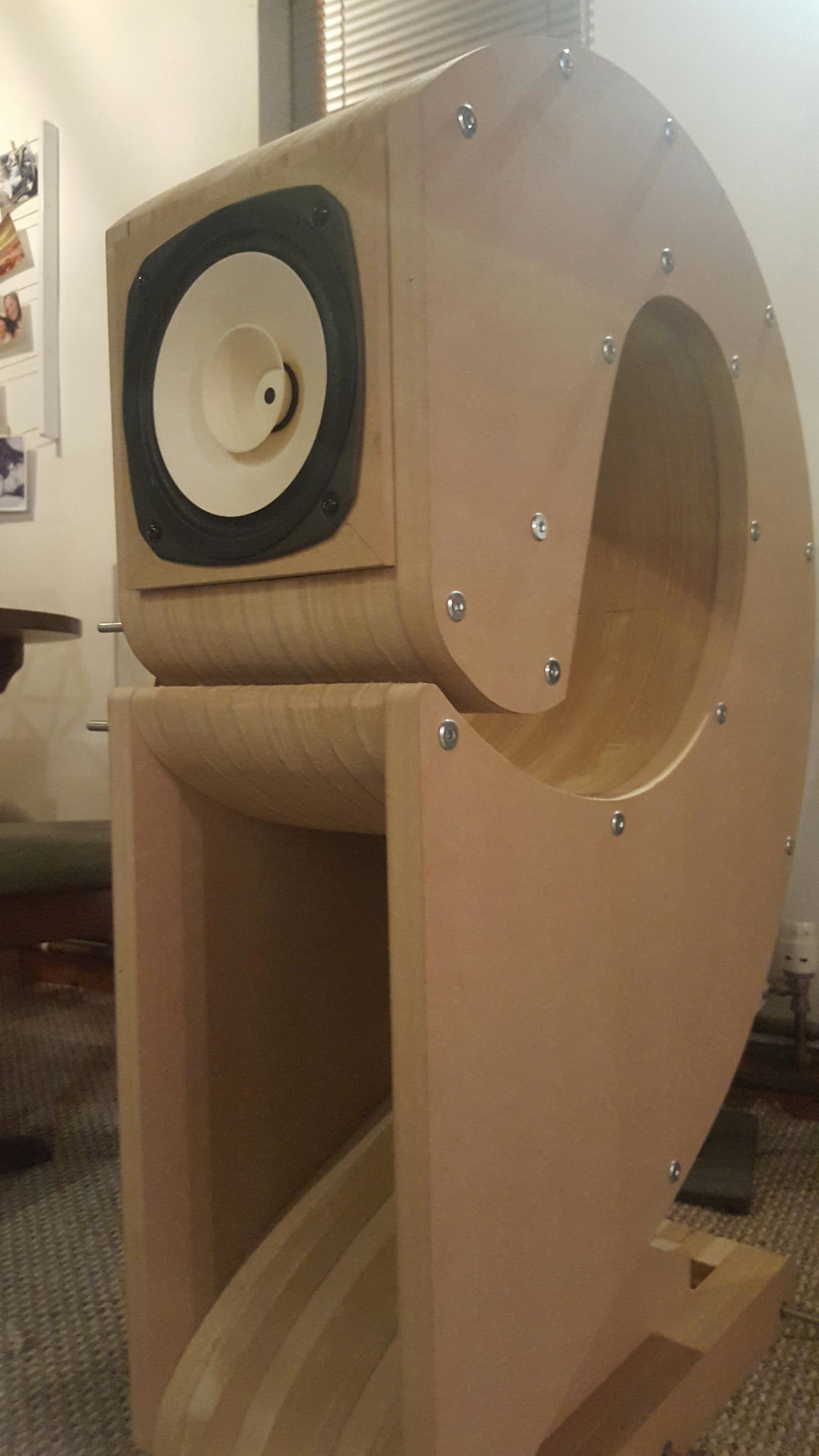

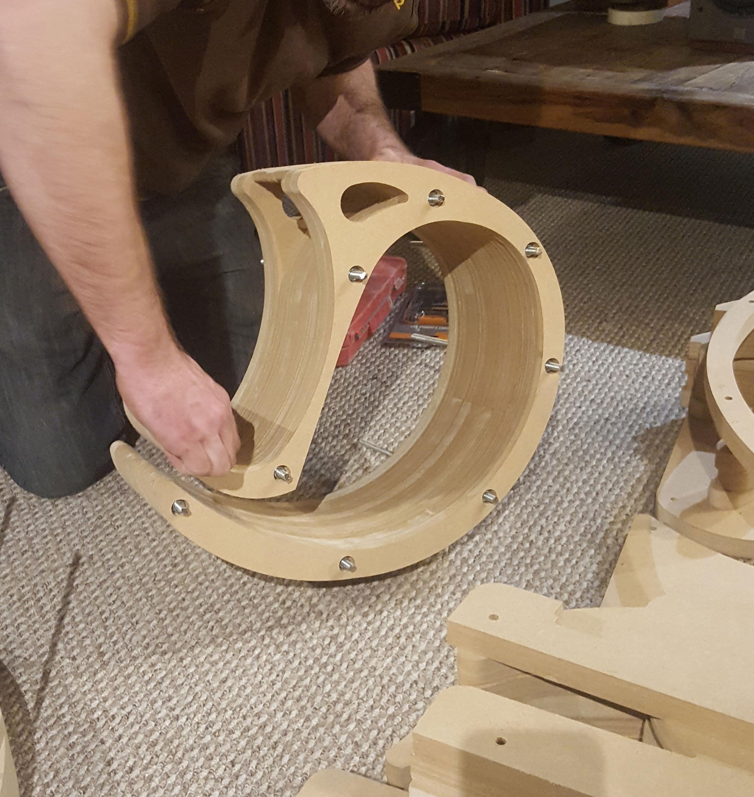

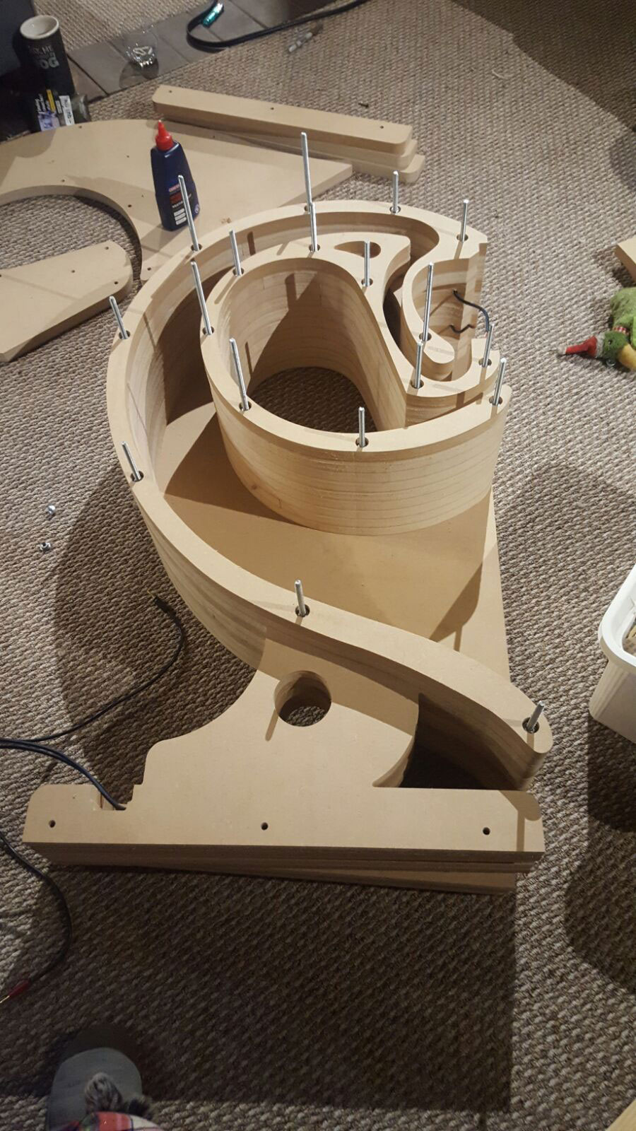

BUT and is a stupid but. I solved the problem by actually doing what I was intended to in the first place. You see I had stupidly rushed my project as like a child with a new toy and put my new design of speakers together with no glue, no attention to detail as I just wanted to listen to the new drivers and they sounded great in the mid but nothing else.
I've spent the last 36 hours doing them properly and I have to be honest its changed my whole outlook on audiophile. These sound incredible and I don't think other than the tannoy golds I heard once I've heard better. Plus they are still not finished they need some weight in the base and a good set of spikes.
So I have a new question. I'm using Fostex FE206-en's and I'm blown away the units put my dali mentor 2's to shame and I designed and built them myself and it was my first build. I don't think ill be buying a pair of factory made loudspeakers again ever. Are there any 8" drivers out there that would put the fostex to shame without breaking the bank.
Also I have no need for the arcam power amp now nor the quad 34 or 303. I was thinking of maybe going down the route of a valve pre and 2 mono blocks now. And selling my old gear as I have a bit to shift now that could probably afford me some half decent valve gear.

Wow, that's quite a project you have there and you can be quite proud of the construction and appearance. Though I can't say from experience with more than a couple of Fostex and similar full range speakers, any such driver will be a compromise of size V frequency response and dispersion, so a large, full range driver wont be as effective in those important areas as a smaller unit. The most effective way to proceed would be to stay small with the full range drivers and augment the bass with an independent bass driver or subwoofer unit, built for the purpose and perhaps disguised as furniture.
I'm aware that a lot of speaker builders are strongly motivated to use only a single driver on principle, efficiency and aesthetics but there is a point where practical limitations and cost conflict with this. Still, this US supplier has affordable 8" drivers:
