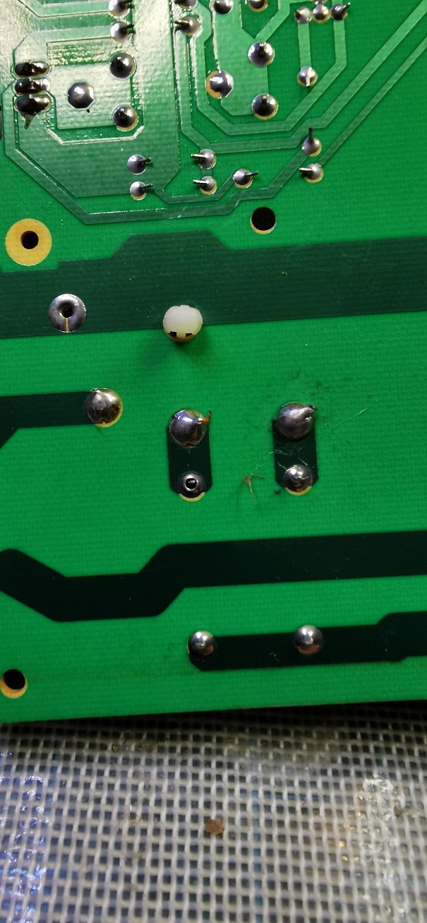

so the first thing with this is one of the power supplies has no fuse in it and there is a broken joint on the bottom of the fuse holder
well it wont be that as its the 115v supply

It's not the first time a DIYer has had diffuculty with the internal mains connections for the 115/230V mains supply options in Arcams's Alpha series (I assume that's the A series) models. Of course, a user isn't expected to know that Arcam used the alternate (meaning only 1 fuse is fitted) fuse holders, to select the appropriate mains voltage which is all very clever and maybe saves a few cents but not so nice for DIYs, if you weren't expecting such a strange way of doing things. This is where a full read of the service manual and some earlier threads that explain it and other other common Alpha series problems better and may be helpful.
If there's a problem there, it could be due to a manufacturing fault compounded with fiddling about with the fuses by a previous owner or fixer who may not have understood what the instructions meant or whether they applied to the situation. I wasn't suggesting that you misunderstood or had anything to do with it but you did comment on the state of the unused fuse holder connection and your pic shows what looks like poor (no adhesion) soldering. That also looks like its original condition, so any force applied to fit or remove a fuse there, could have led to damage, one way or another.
In particular, it suggests someone may, through unwise fuse fitting, have applied 230V to a single 115V winding. That wouldn't necessarily damage the transformer or its thermal fuse but it could, with virtually double the AC output voltages, have done a lot of damage to the rectifier, main power caps and the amplifier(s) etc, depending on how long the fault voltages were maintained, parts quality and so on. Perhaps do a check on the supply voltages first - no connections to DC loads?
