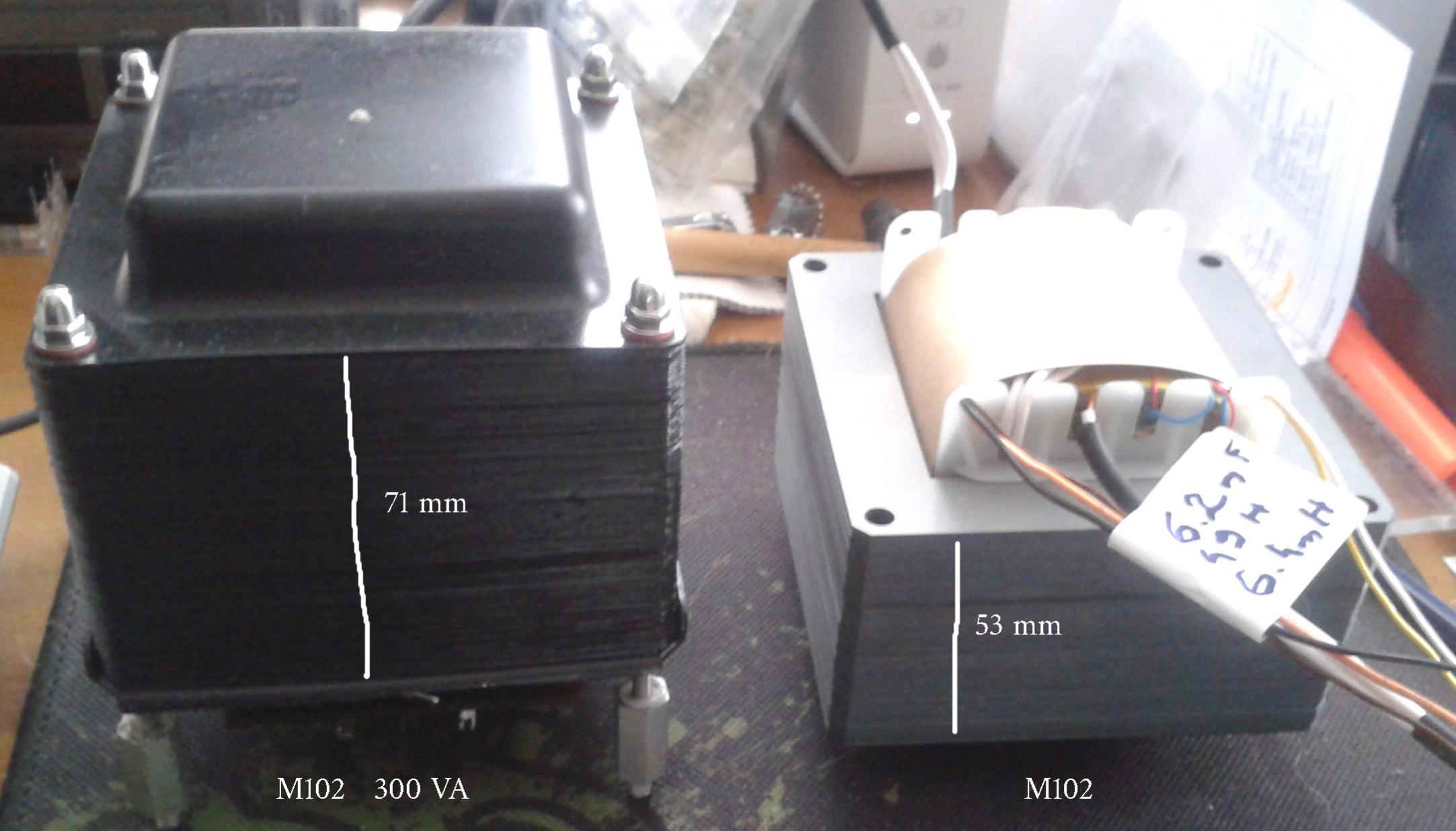

Ave Guys!
My semi-finished VT60.
Output and mains transformer.
OPT1
6.5k Raa
A1 114.16 Ohm
A2 114.45 Ohm
More in the picture
OPT2
6.5k Raa
A1 114.2 Ohm
A2 112 Ohm
More in the picture
Pipes SOVTEK 6550
MAINS
300 VA electrically dimensioned at the bottom!

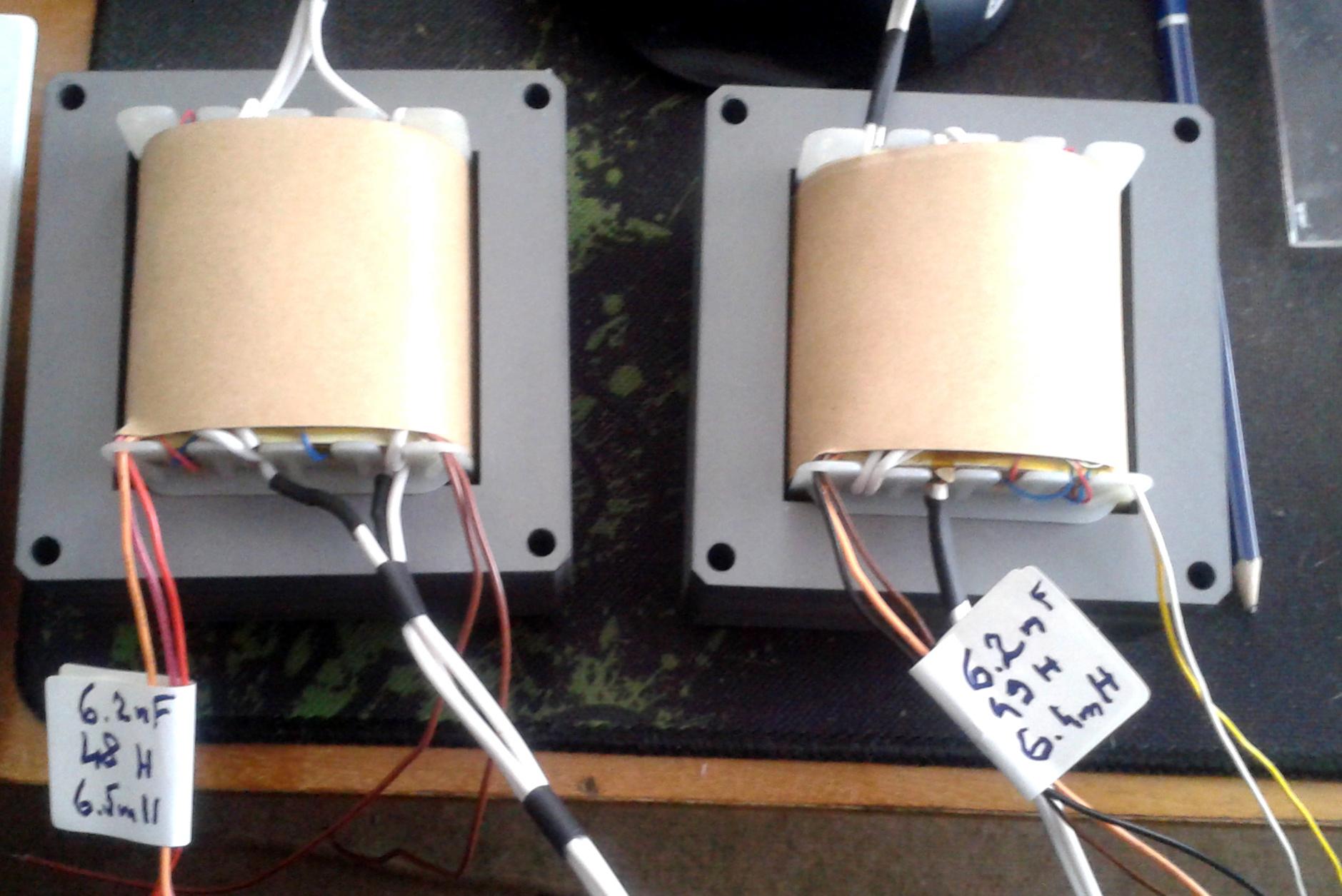

OPT1
6.5k Raa
A1 114.16 Ohm
A2 114.45 Ohm
More in the picture
OPT2
6.5k Raa
A1 114.2 Ohm
A2 112 Ohm
More in the picture
Pipes SOVTEK 6550
MAINS
