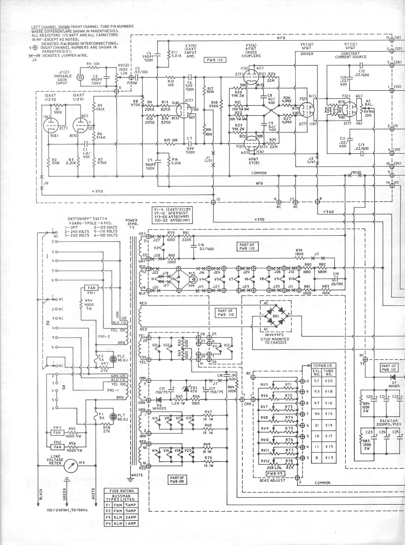

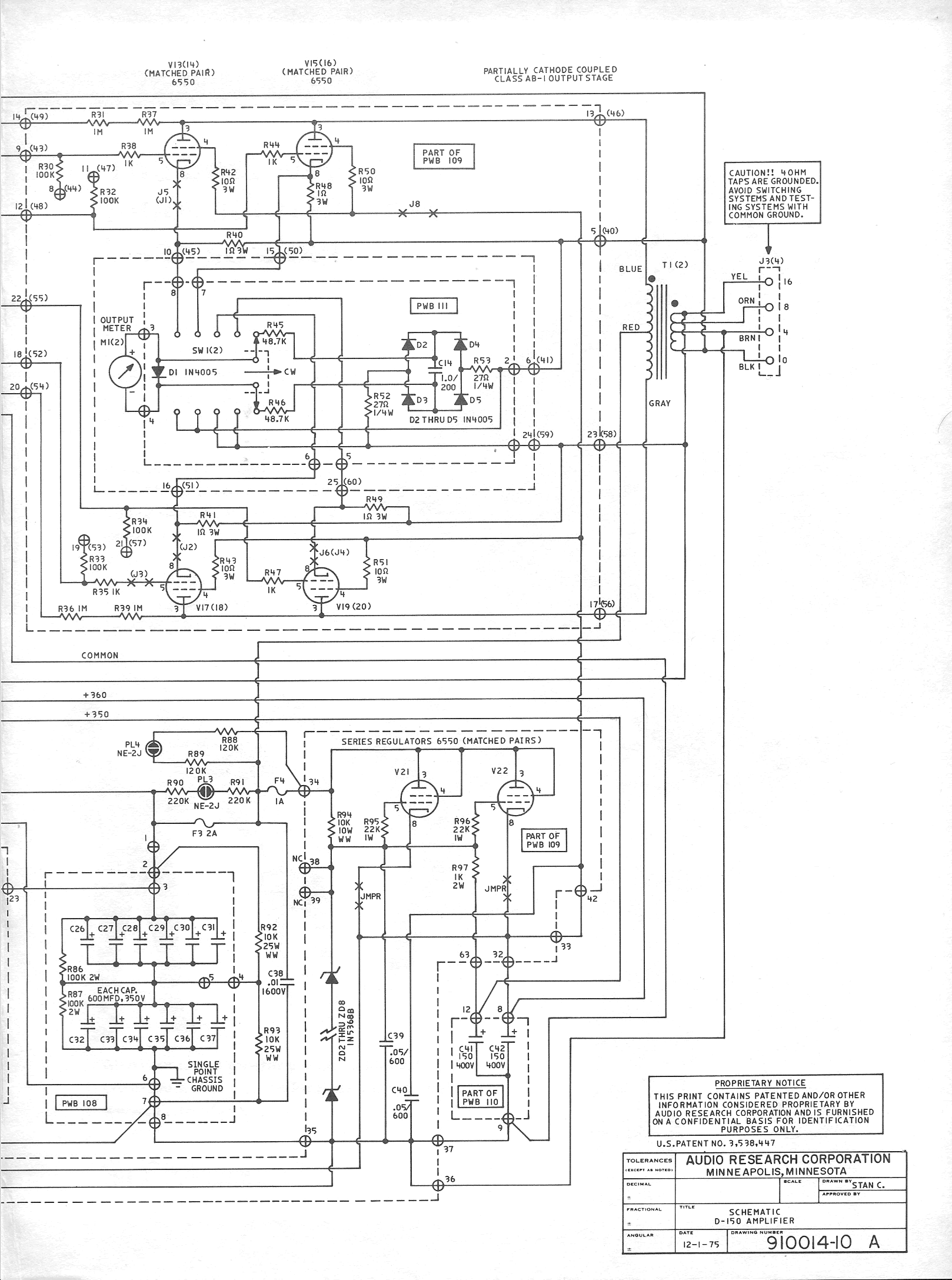

I have the schematic in pdf file but cannot seem to upload it, it differs from the Classic 120, I cannot even find VTL5C4

That is the D-150 from 1976, not the Classic 150.
The Classic 150 is very different. Which do you have?
My mistake -- I went back to the ARC archive website and while they do have some documentation for the Classic 150, there isn't a schematic available.
Sorry.
