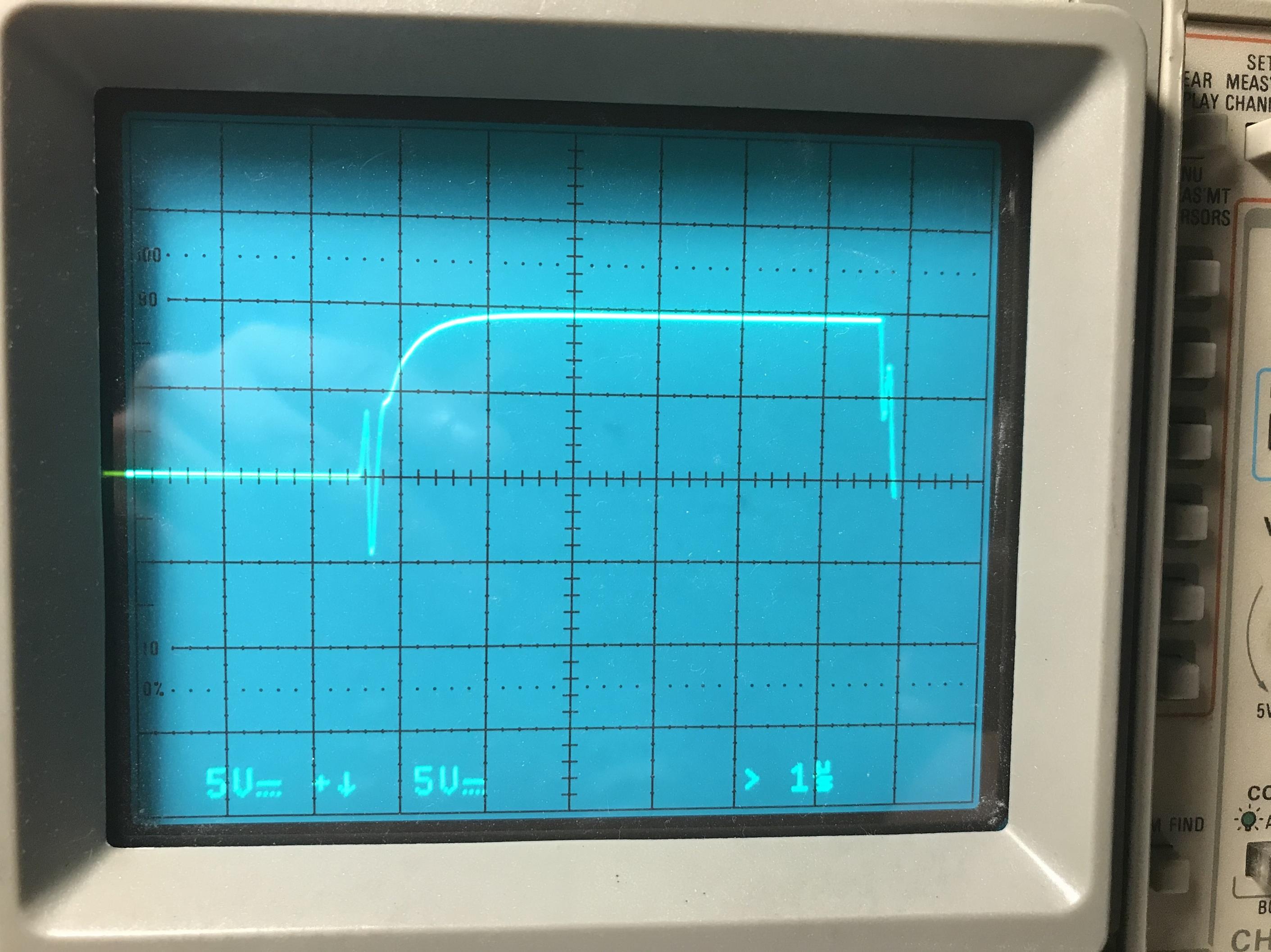

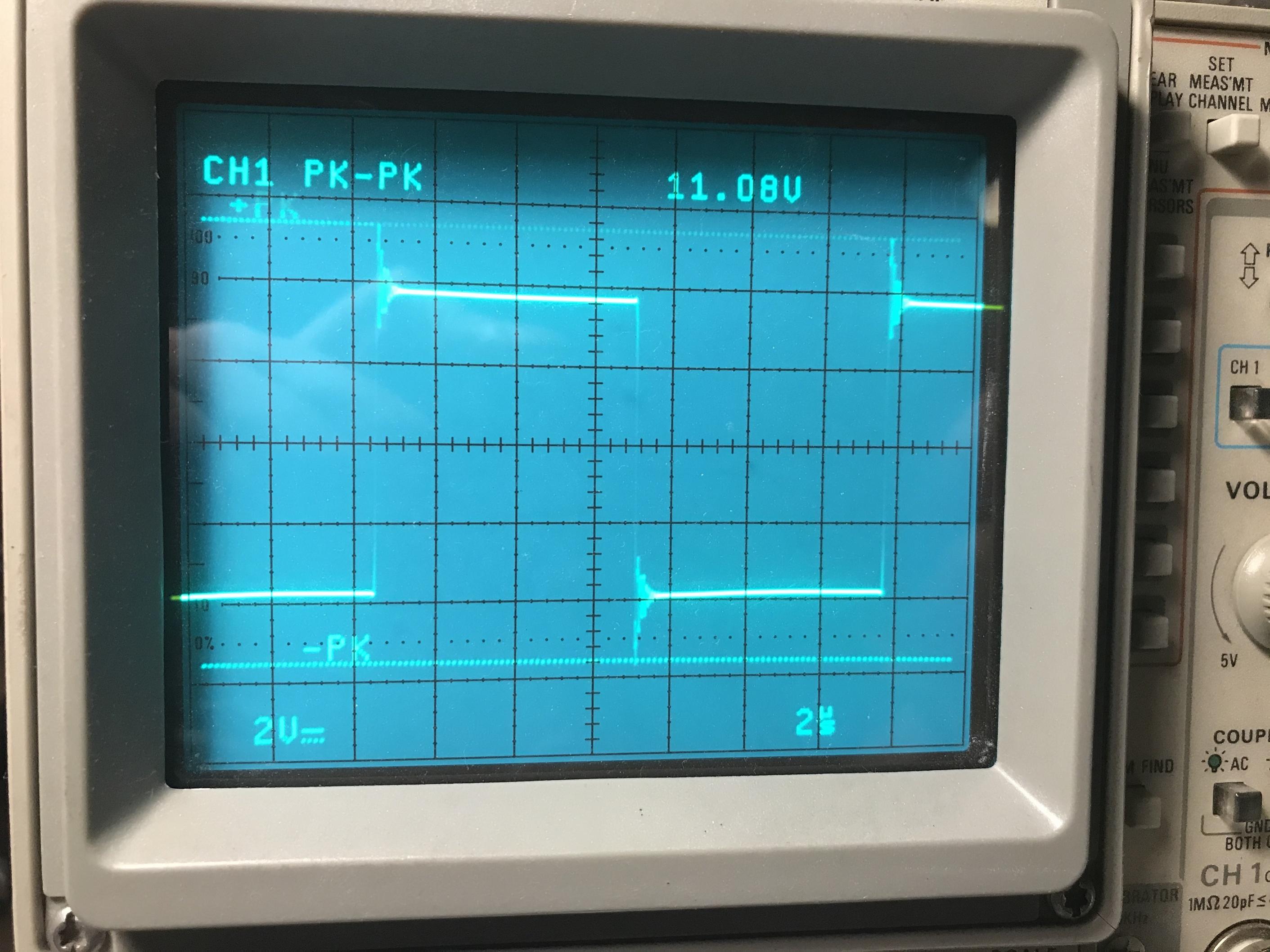

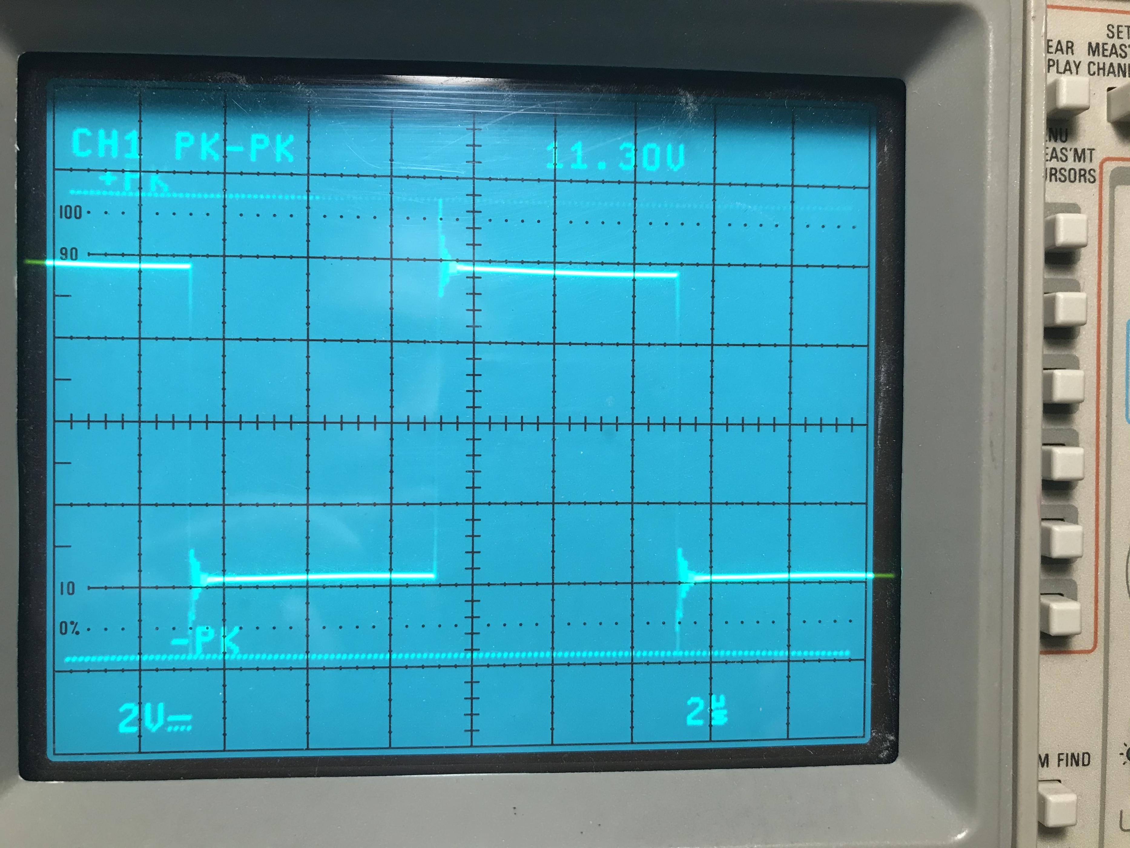

Time for an update and hopefully some advice
Hi All,
I ended up replacing the driver IC with an IR2010STRPBF. This seemed reasonable, considering that the rail voltages on this unregulated power supply is around 40-42V at 12.6V input.

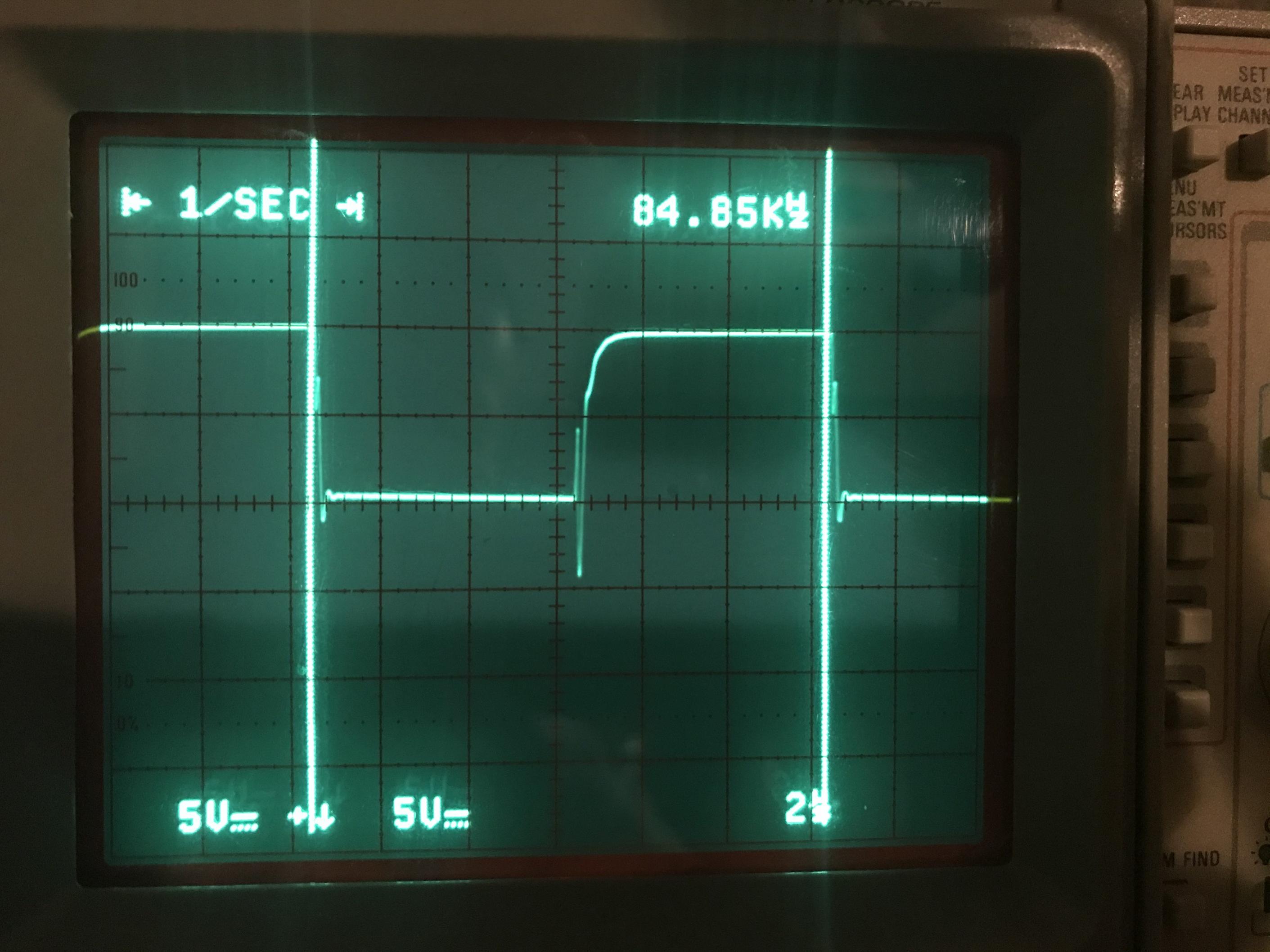

I used the STW40NF20 as planned and the reason for using this was that it was quite close to the STW34NB20 mentioned by others. The Total gate charge for the STW40NF20 is 75nC, compared to the 60nC for the STW34NB20.

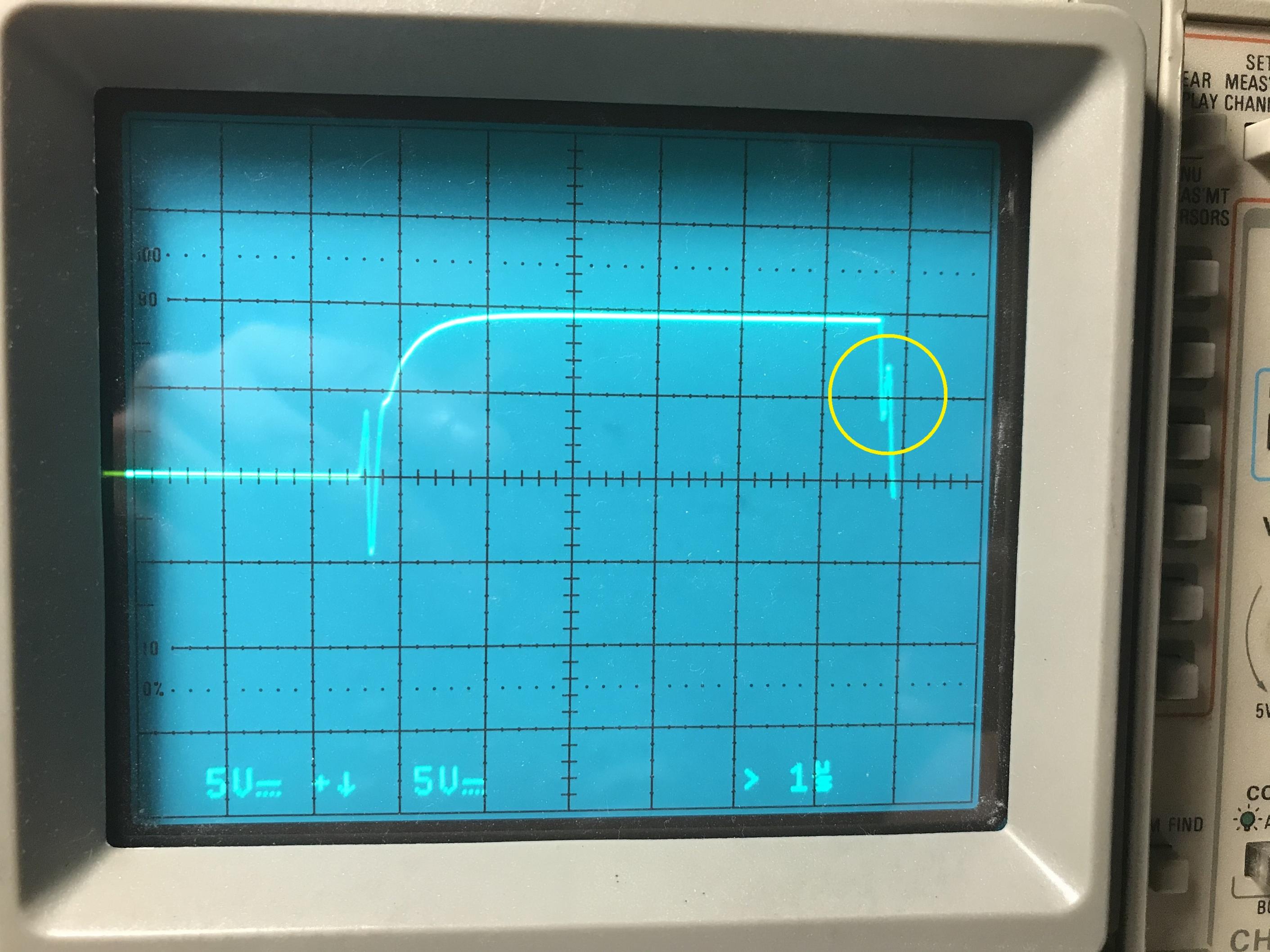

During initial testing, without any load, the sub channel worked as expected, producing clean output, but the MOSFETs did heat up a bit more than I expected. The first picture is the Gate of the High Side MOSFET, using matched probes (Gate and Source) Summed with inverted Channel B. It is hard to see, but the switching is quite close, with perhaps a tiny bit of cross conduction.
The second picture is of the low side Gate, with the probes at 1x, so a little less detail with regards to high frequency artefacts.
The Gate drive uses both a resistor as well as a diode for each MOSFETs. I did replace the 22ohm resistors with 30ohm resistors that reduced heating and also resulted in slightly less ringing on the output. The next two images is the rail to rail switching. 117.4V before the change and 113V with the 30ohm in place.
I ran the input voltage of the amp up to 16.5V and with the ringing, the rail to rail voltage was 147V, which I thought was still within the 200 rating of the Transistor. Keep in mind that this was without any load.
When I ran my full power test, after assembly into the heat sink, the sub channel failed after only seconds with a 4ohm load attached.
Any advice would be greatly appreciated!

I don't see anything (from what you posted) that should cause the outputs to fail.
I don't understand the rail-rail oscillation with 1x and 2v/div.
Thanks for using the scope in differential mode. Few people will. It was also nice to see the nice sharp display of a CRT based scope.

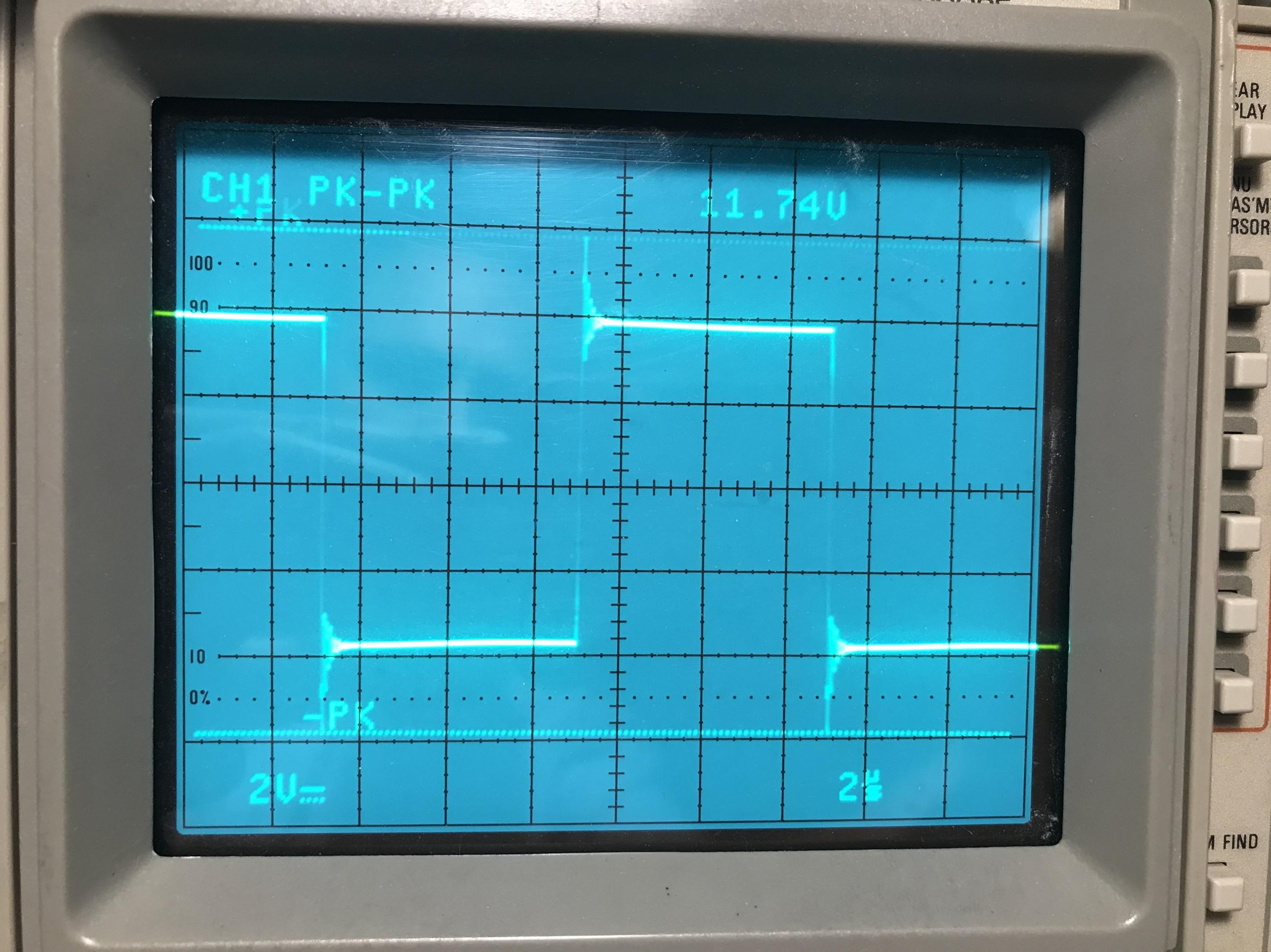

Thanks Perry,
I forgot to mention that the 2V/div was taken with a 10x probe. It is not original Tektronics probes, so the scope does not detect the setting automatically. I also did not see anything out of the ordinary, which was why I moved on to my high power testing. I was careful moving forward, since it is quite a bit of work to assemble this amp into the heat sink.
Damage after the failure includes power supply MOSFETs, the high side output MOSFET and the IR2010. I did not check beyond that.

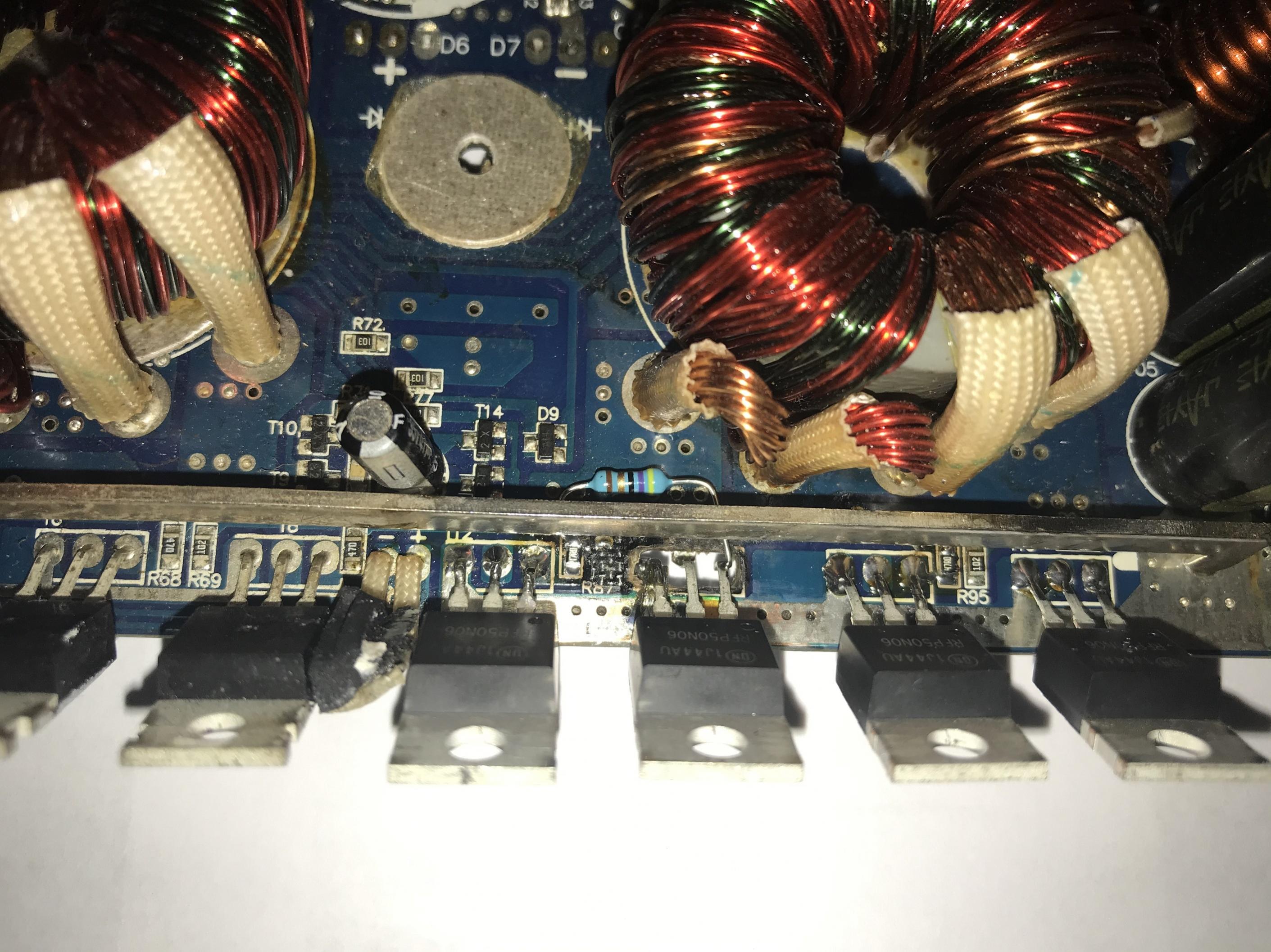

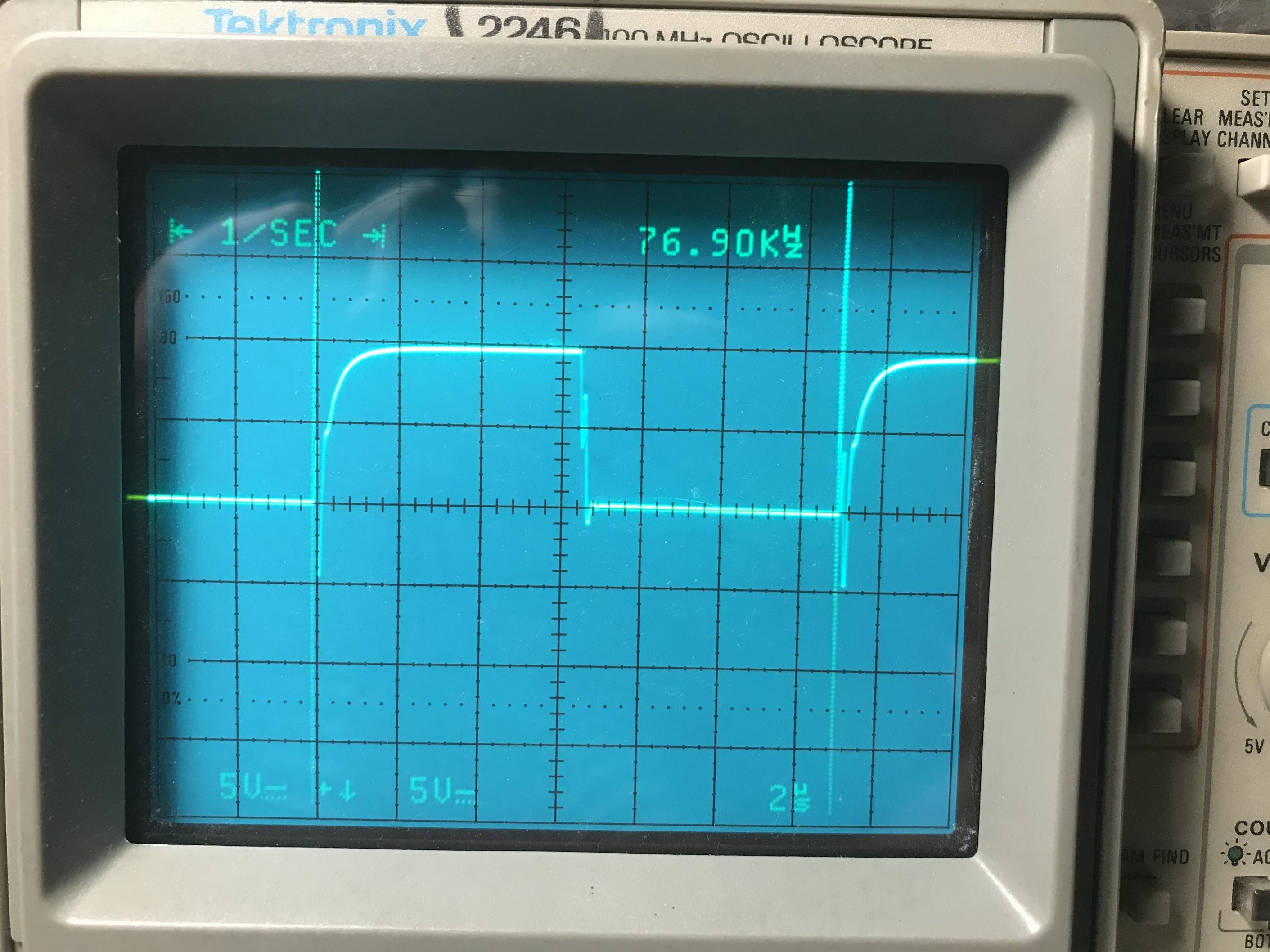

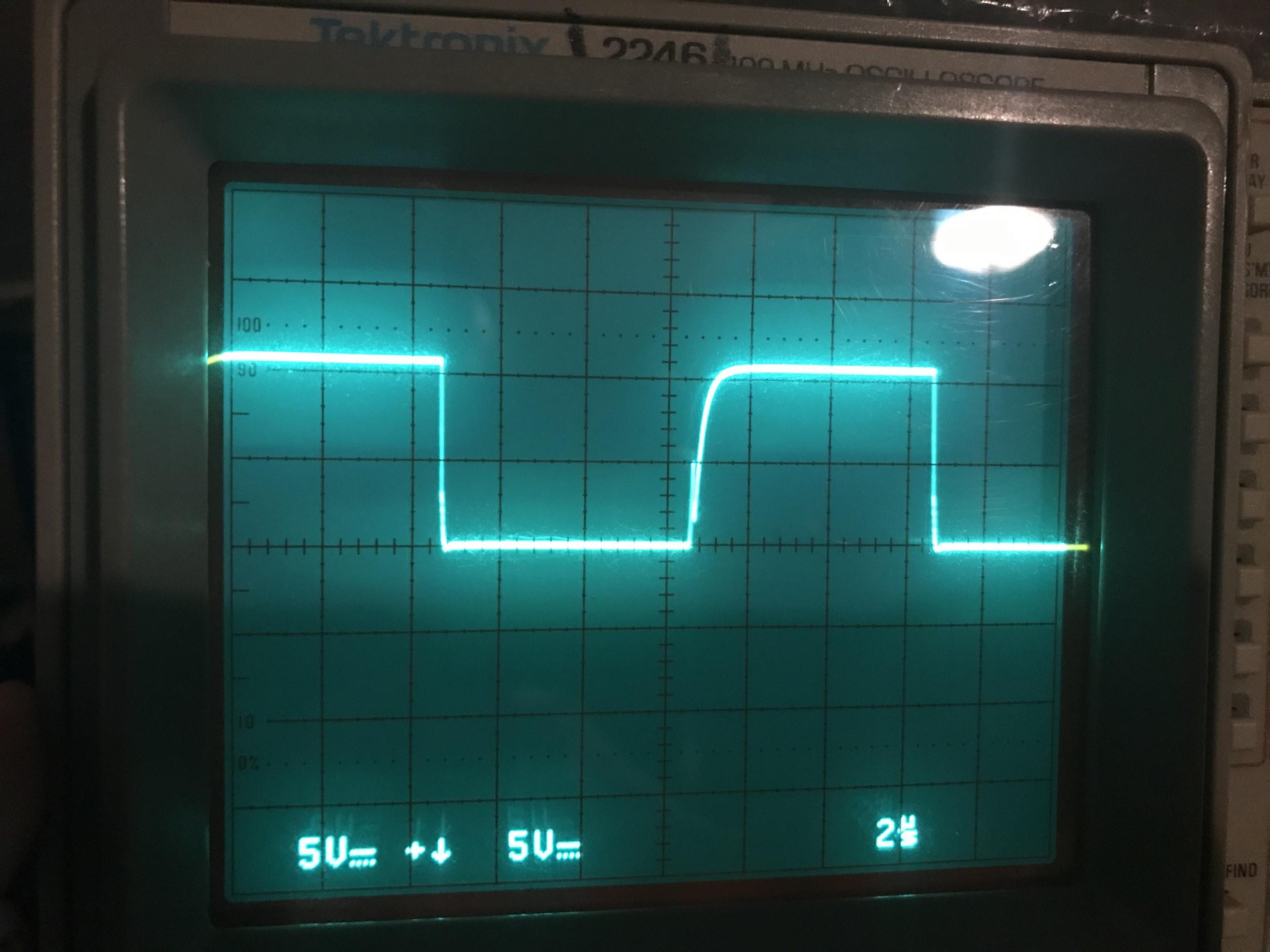

Update Time
Hi All,
I installed an IR2110S and STW46NF30 still with the 30ohm emitter resistors and here are the wave forms that I am seeing now. Quite similar to the ones before, but the cross conduction seems less. The first two pictures are of the high side as before, but now I can see that the low side MOSFET is switching when the high side drive is below 5V as indicating by the waveform due to the captive coupling Gate Source coupling. At least that is what I believe I am seeing. Feel free to correct me if I am wrong with this.
The switching frequency is a little lower @ 76.9KHz (third picture) vs the 84.85KHZ with the IR2010S.

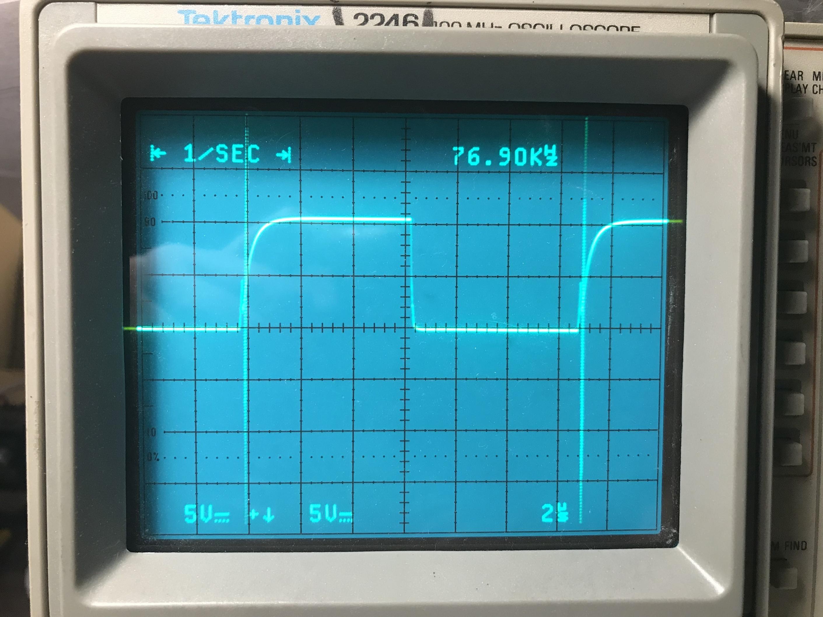

Fourth picture is the low side gate drive. That seems fine to me also.
The fifth picture is the rail to rail oscillation, with a little less ringing than I had before. Again, I do not see anything of concern. With the STW46NF30's 300V rating it should not be a problem at all.
I have also included a last picture of the power supply repair that I made. That included removing carbonized PCB ares around one power supply MOSFET and using a through hole 47ohm (same value as other SMD parts) to make the connection with the gate. I did add some E6000 glue to the resistor (after the photo) to fix it in place.
Any concerns with this repair I should consider?
Thanks again for all input!

The coupling that causes the notch in the waveform is gate to drain.
Are you 100% sure that you removed all of the conductive fiberglass? Clean fiberglass typically has only light coloring.
At this point, I think it's only left to give it a thorough testing.
