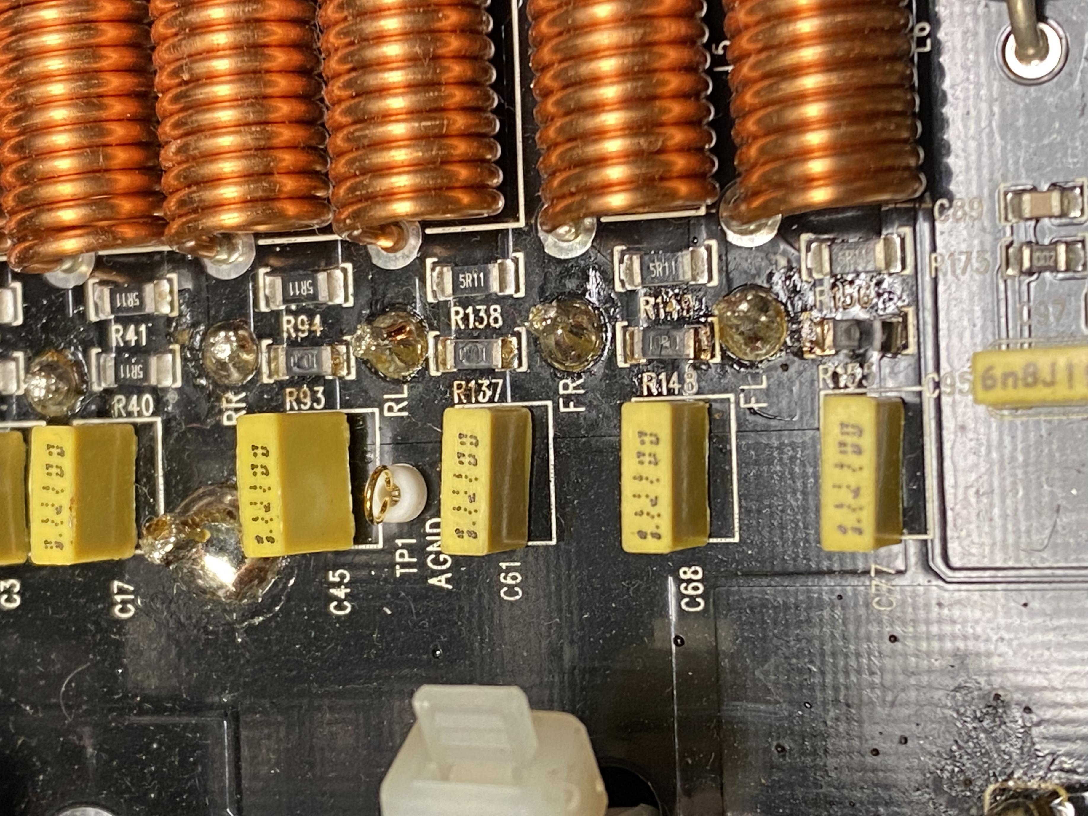

The resistors that are burnt are actually 10 ohm resistors .
I confirmed this with arc audio .
They burn due to clipping
It's generally either abuse (long term hard clipping of the high frequencies) or oscillation. The sub channel doesn't generally burn because the low-frequency clipping doesn't pass much current through the zobel network.
