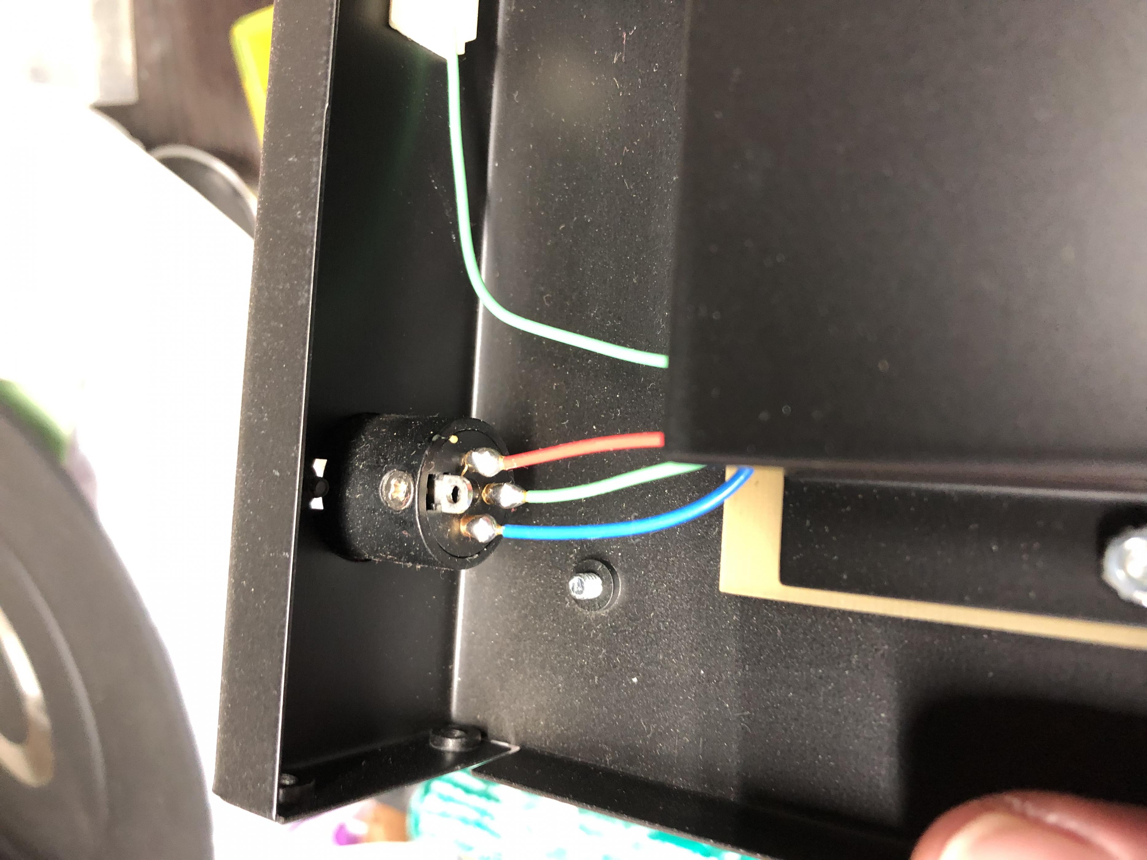

If anyone as a power supply ILDK-19 Ill appreciate directions on which cable goes into which pin on the XLR.

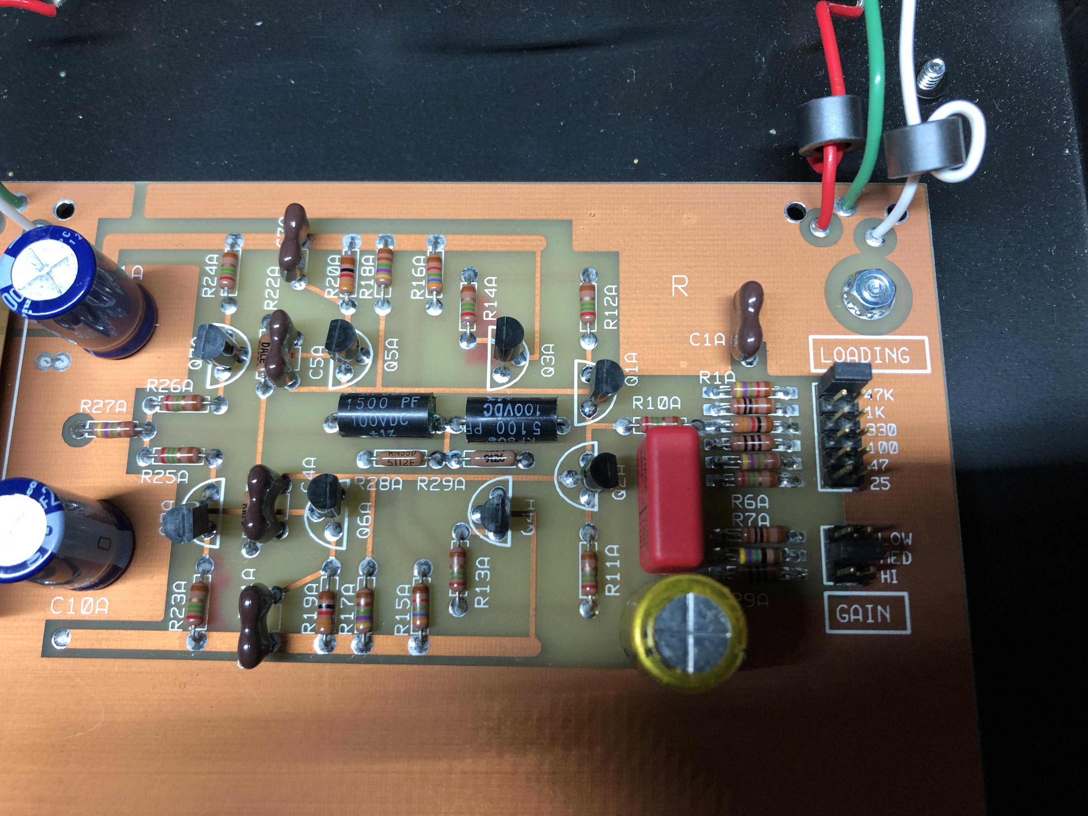

Hello Jim,
The Aragon 47K phono does not use any integrated circuits, all discreet semiconductors and high quality resistors and capacitors.
I would check the gain and load jumpers. Re-seat the jumpers and make sure both channels are set the same. The only part that might need replaced would be the electrolytic caps but I doubt if they are bad. I would check the voltages going to both channels and make sure they are the same. If you need more detailed information I can get mine out of storage and do some tests.
I tried to attach an image but it may not show...
Hope this helps a bit..
Dave

OK Here's an update.
I did find one jumper was loose on the gain of one channel, so hopefully that does it. I'll have to give it a try and see. I wish I had the schematic because I may want gain somewhere between the three possible choices... it would be great if I could match the output to my digital output for example, to avoid changing gain at the preamp all the time. I'm not sure if running two of the (apparent) resistors would give me intermediate resistance and hence intermediate gain...
I was thinking I would replace components with "better" stuff... the problem is, this thing is a veritible "who's who" of high-end components. Check the pictures! The only ones I'd consider are the two large capacitors.

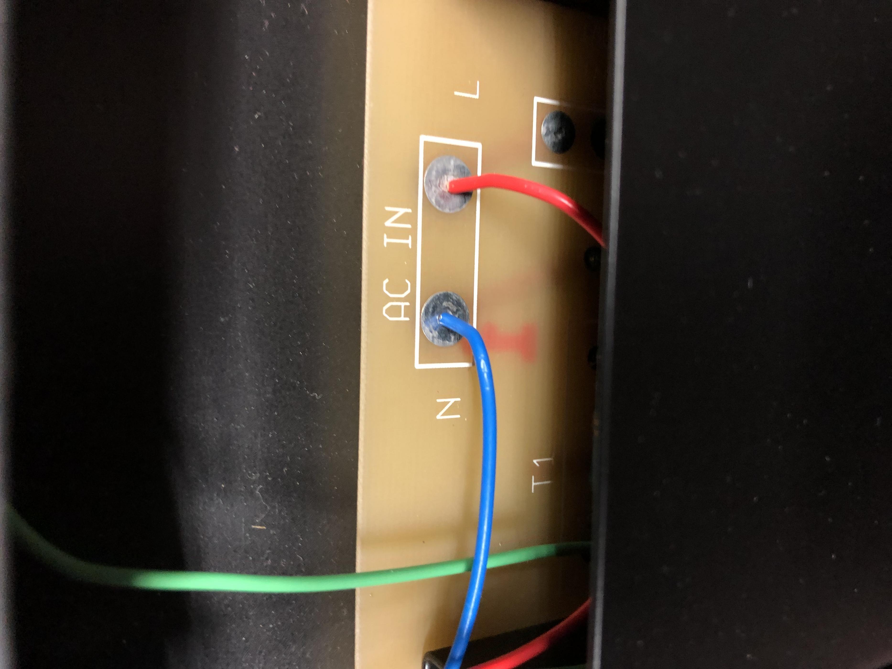

Anyway, someone was also interested in the pinout for the A/C input, and I have that as well. See the pictures (in the next post), but I STRONGLY suggest you open your unit and inspect the power supply to verify input voltage and pinout for your specific unit.

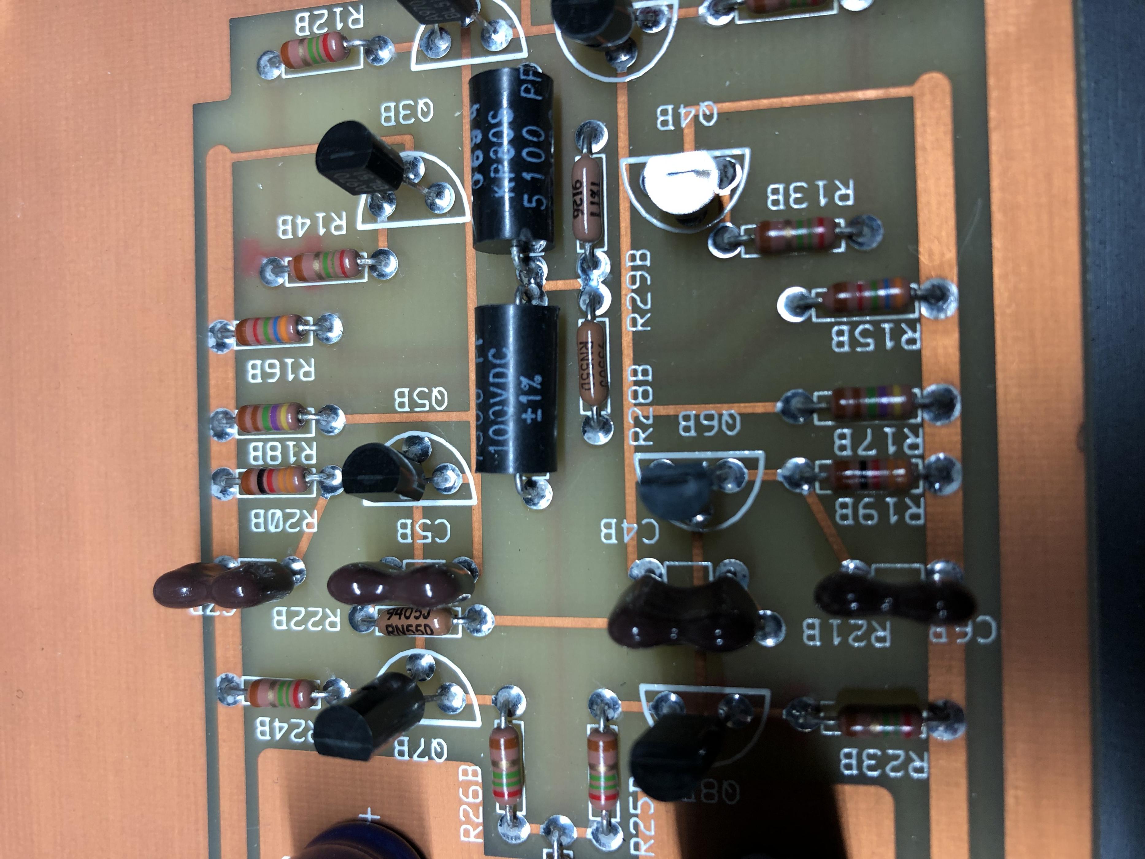

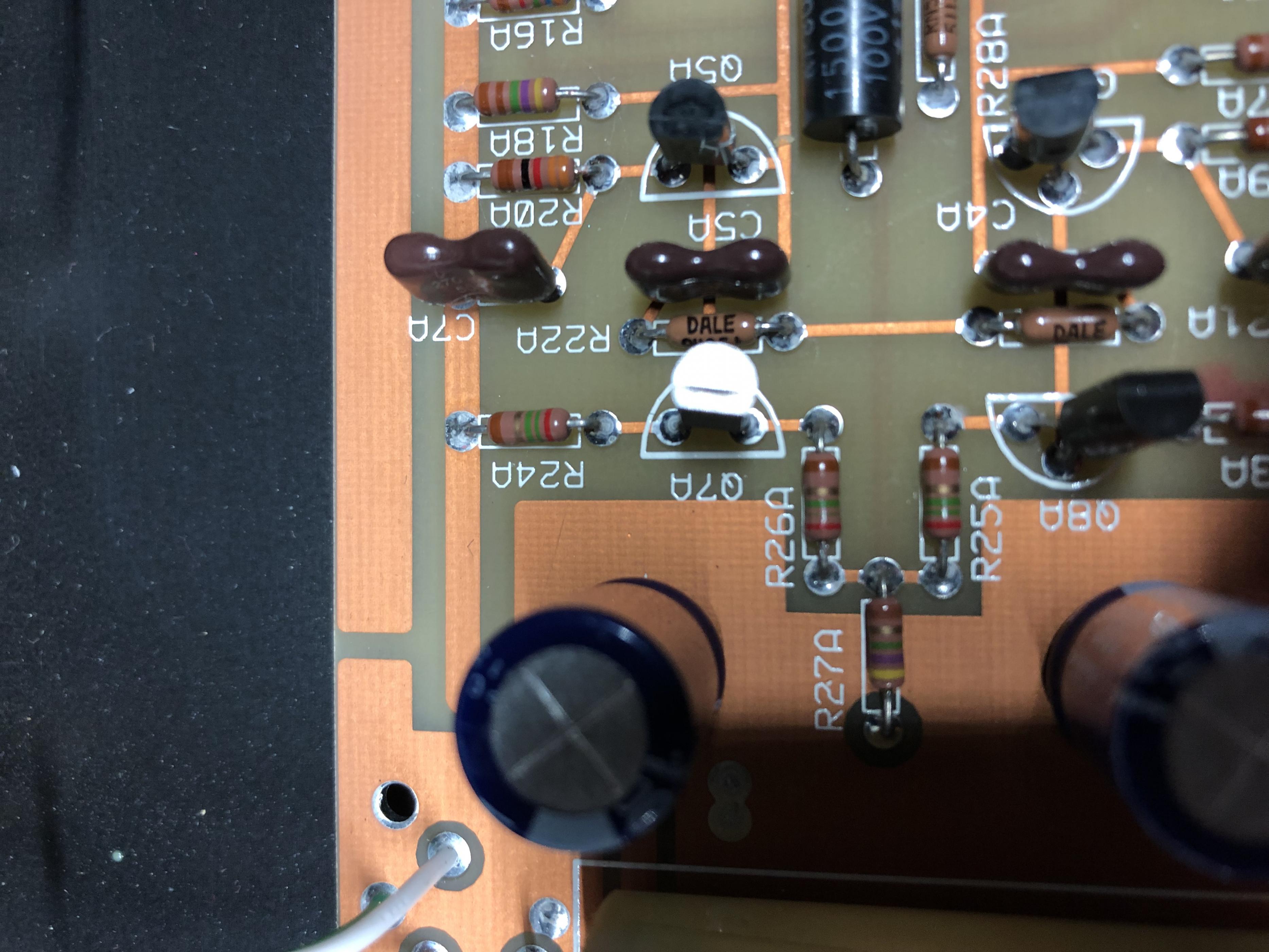

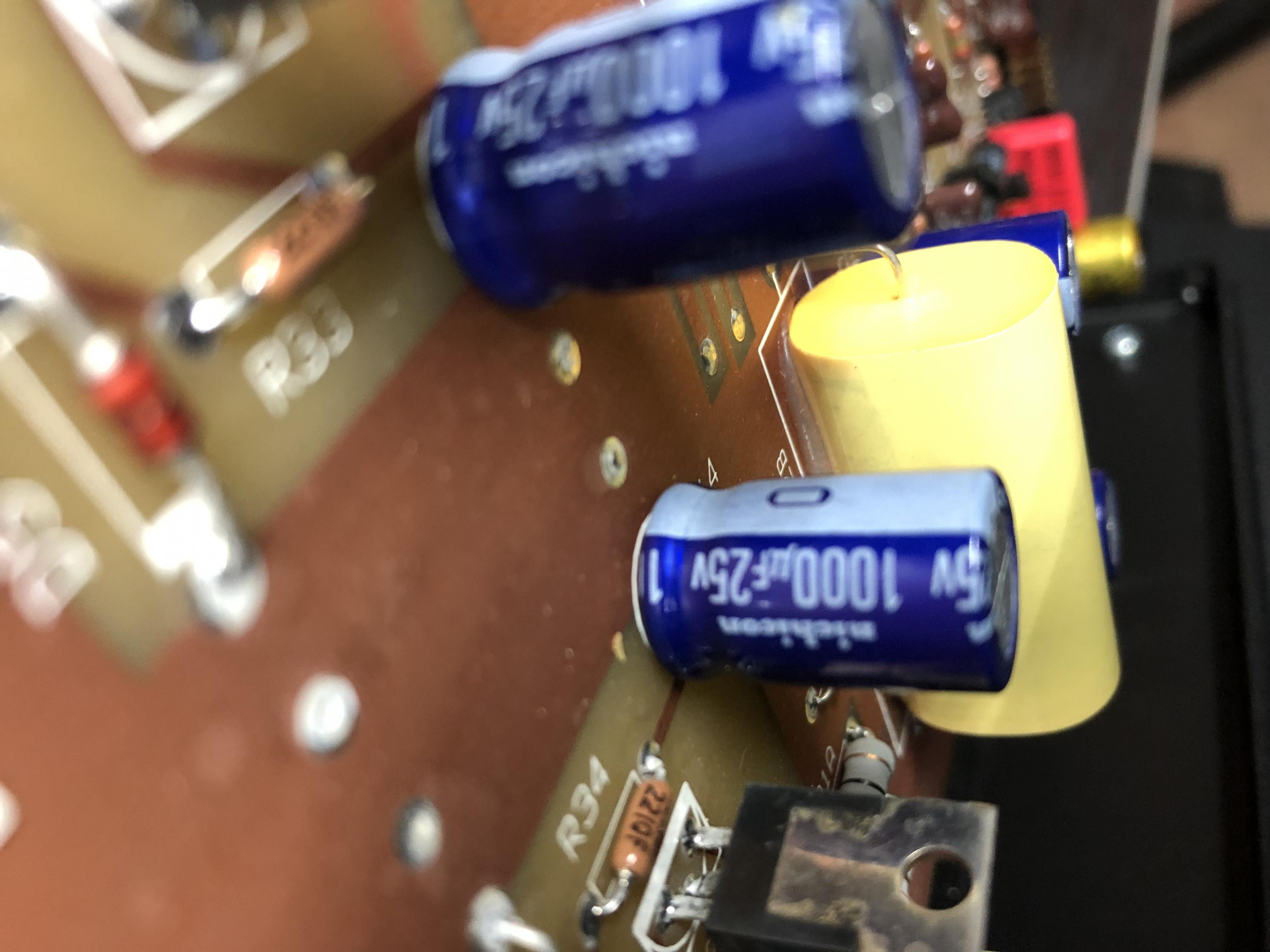

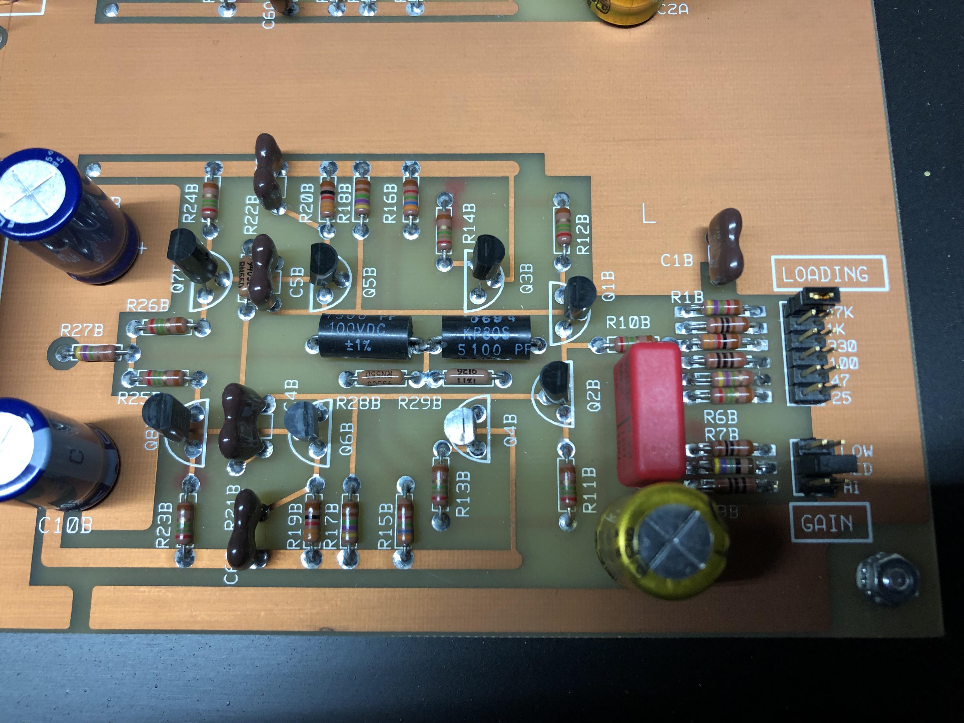

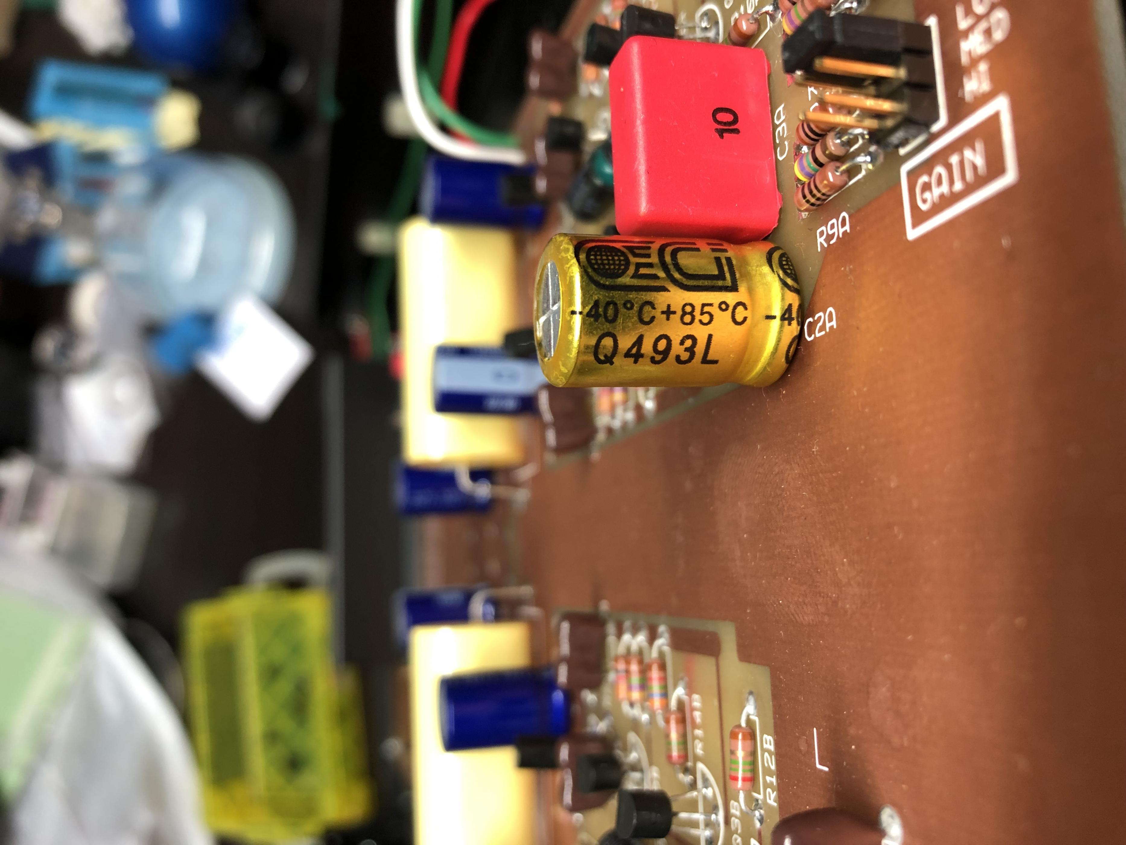

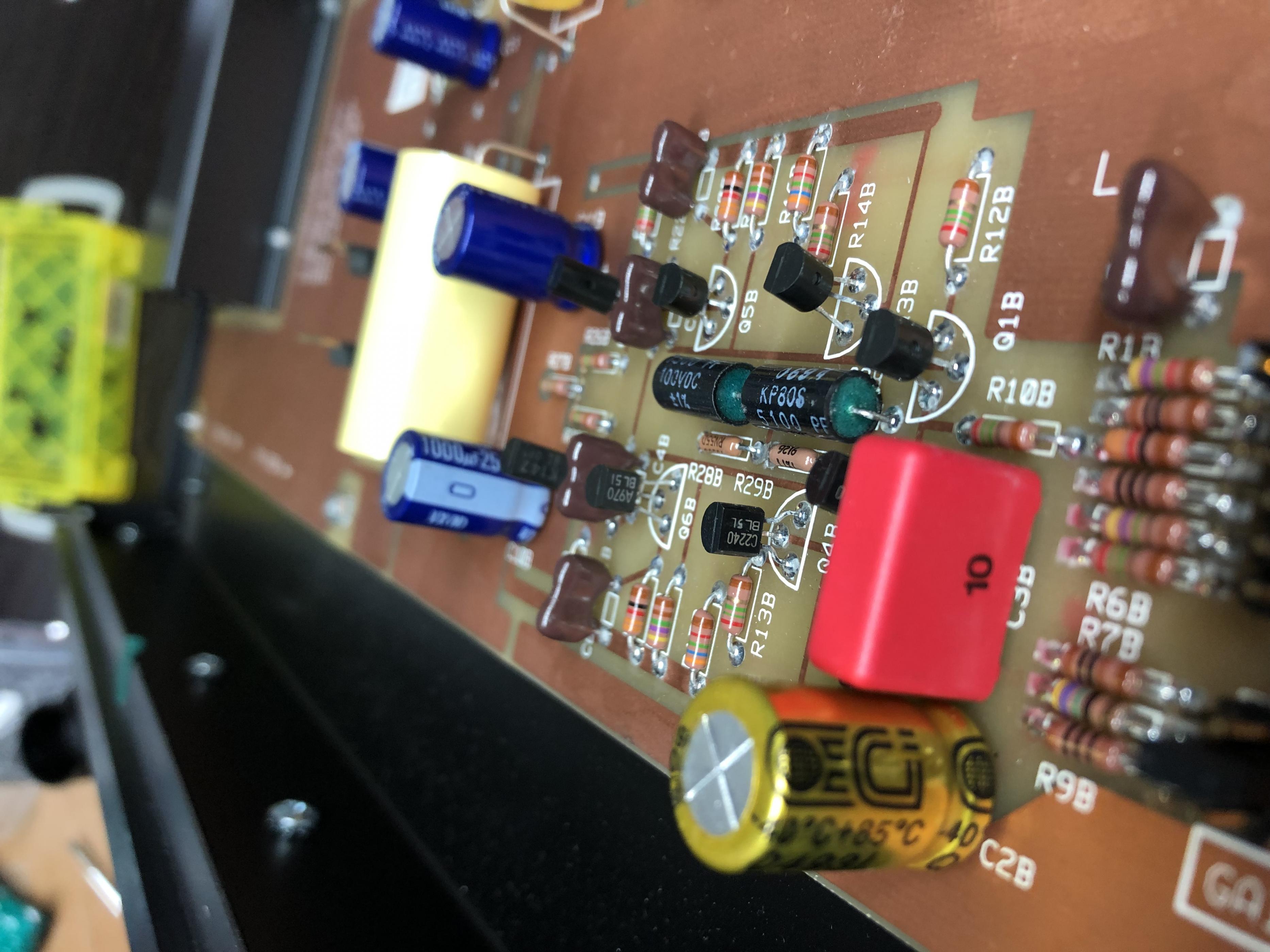

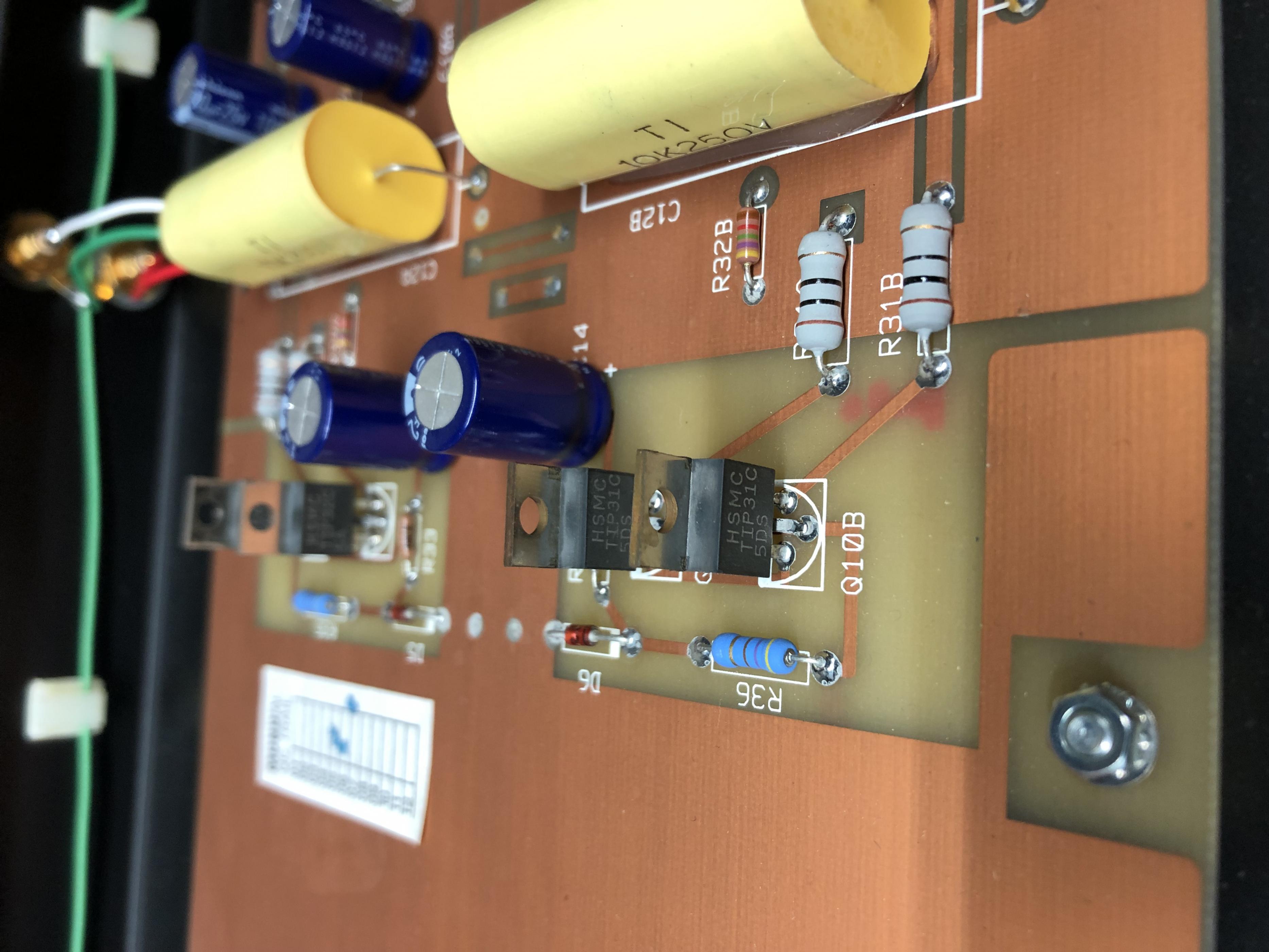

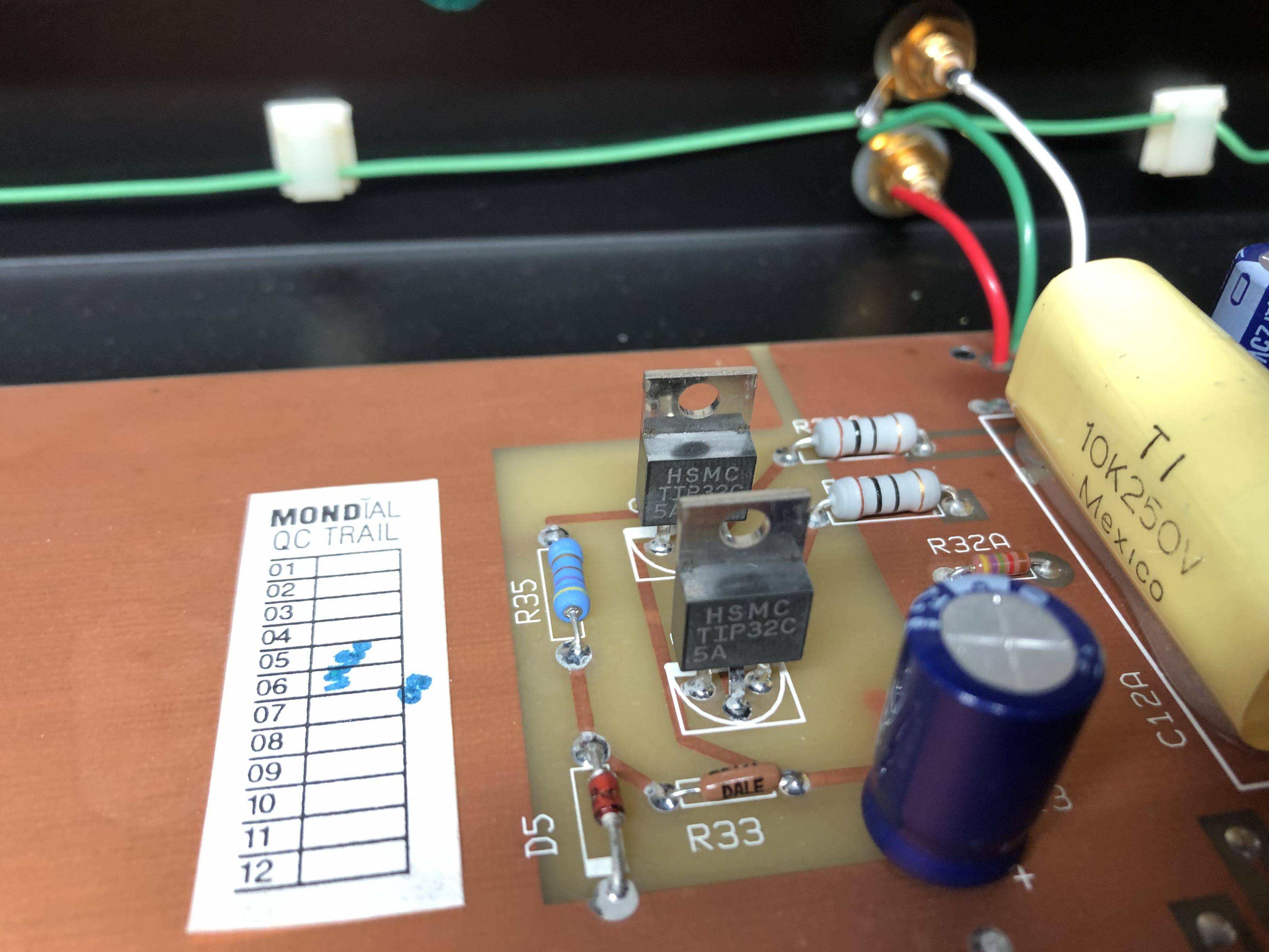

So, can anyone help me identify these caps properly?
10K250V doesn't make sense to me. 10K what? Not 10,000 mF, or is it? I'm thinking 1.0uF, which may be the same (i'm not an electrical engineer, if you hand't noticed) and that cap (from V-cap) has the same 250V rating as well.
But those V-caps are 1.65" diameter by 2.5" long, so it might take some "engineering" to get them in there, if it's even worth the $736.00 upgrade...😕 Though I do know the value of good caps in the signal path, when necessary.
HELP!
HELP!
Only a guess but it looks like the two TIP transistors and associated parts are part of the power supply. The capacitor, which might be some filtering on that power supply, appears to be a 10 uF/ 250 DC polyester cap. Here's an example of that cap:
10 Ea TI - 18 Uf 250V 10% Axial Lead Mylar Capacitor Speaker Crossover | eBay
Phil
Phil

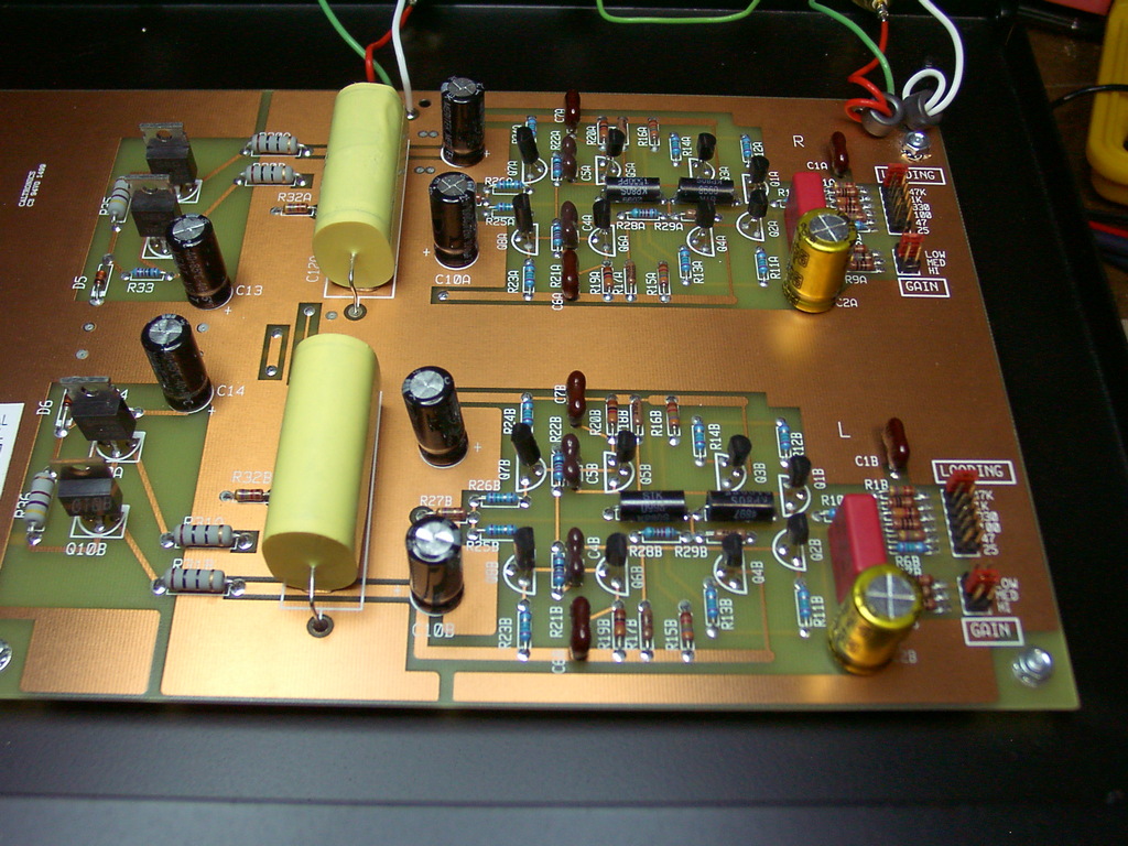

Hi Phil.
I didn't show a "zoomed out" view, but the bridge and caps for the power supply are under an RF shield to the left. There are six or so stubby fat caps and the rectifier, plus a few other bits (I did not remove the cover). Post #14, above, shows the cover in the second photo.
The second photo in post #13, shows the input from the 'table directly across from those big caps. They might be power supply filters too (power supply is off to the left)- I'm not sure. I'd have to pull the board out and draw it from scratch, and then determine what is what.
10uF/250v 10%
They just used what they had available. The voltage rating is of course excessive but similar caps are seldom available with lower ratings. The capacitance is also excessive and determined by the input impedance of the following line stage. A 4.7uF is usually fine. If you use a high impedance line stage you should be able to get away with a much smaller cap.
Both circuit and PS regulation seem quite basic. I would not go crazy with upgrades.

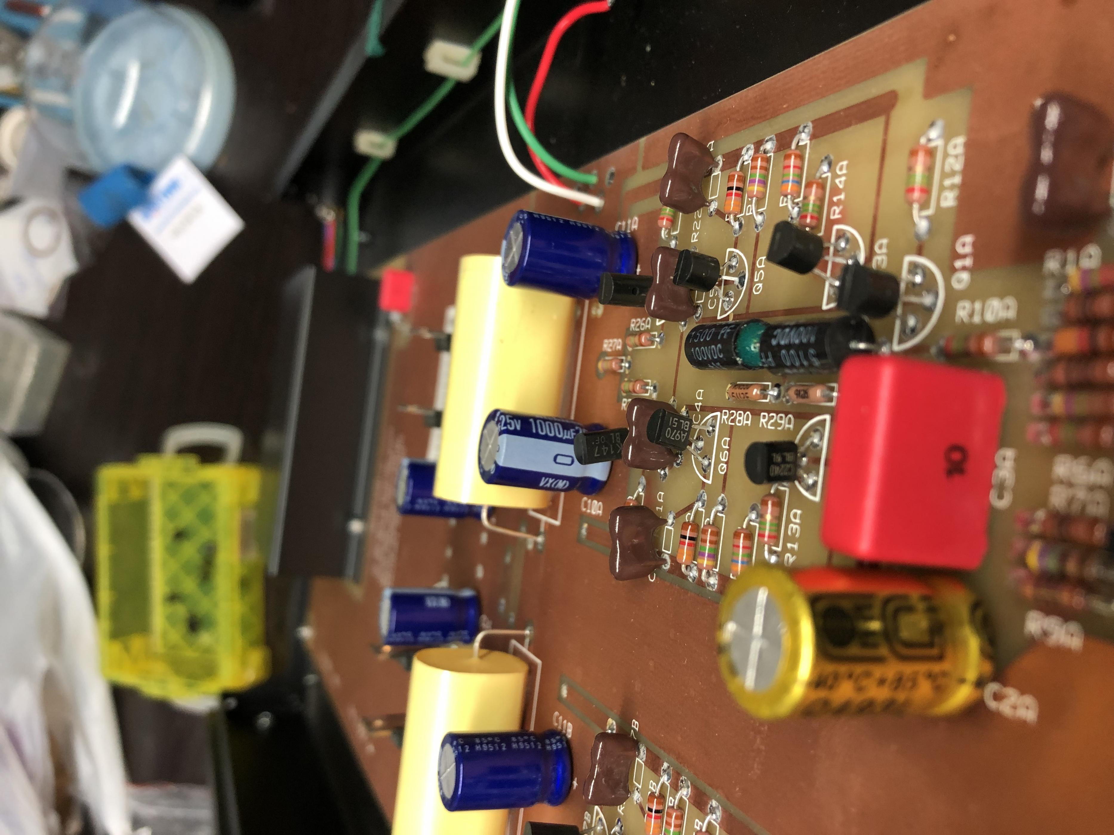

Hi Jim -- analog_sa is very likely correct in that those are output coupling caps. You can measure resistance from one of the RCA outputs to an end of one of those caps to verify. Also try measuring from R27B (or A) to the corresponding 10uF cap.
It's such a pretty unit that I also agree not to go crazy with upgrades or try to shoe-horn in great big caps. I saw one such disaster on the internet. You should be able to find metallized PP caps - at a lower voltage if necessary - that would fit nicely to replace those 10uF's.
If you don't mind another measurement - turn the unit on and measure the voltage with repeat to ground on the tab of each of those TIP31 and TIP32 transistors. Then measure the voltage on each end of the 4 blue 10 own resistors. Just to satisfy my own curiosity. Thanks
Phil
edit -- It looks like there's input caps on each channel also: the WIMA cap and that gold electrolytic whatever it is.
Phil
You are quite possibly right. The input pair, same as all other transistors is bipolar. And cannot find any other purpose for those two caps... The bottleneck appears to be here, rather than at the output.
