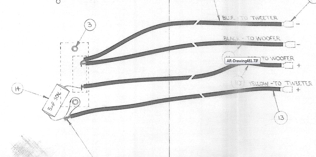

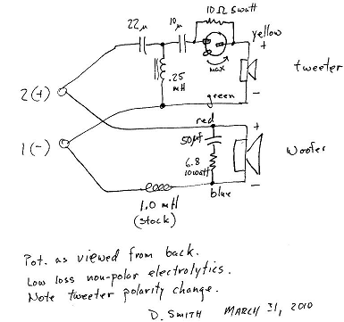

Thanks for posting the diagram for the crossover of the Acoustic Research AR38s System7. Can anyone tell me what the 6uF capacitor in parallel with the woofer coil is for? My AR18s have no crossover for the woofer and rely on mechanical roll off. I'm wondering if anyone has tried modding the crossovers on the AR38s?

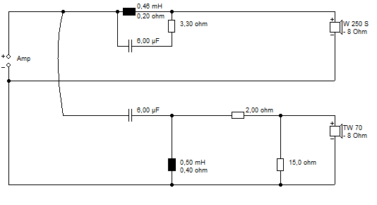

Your Acoustic Research AR-18S speakers are not a million miles away. FWIW, 0.46 mH and 6uF on the AR-38S is a TANK which notches a peak at 3kHz and straightens out phase with any luck. I really wouldn't attempt a crossover mod on the disimmilar AR-18S to attempt the same without knowing more details.

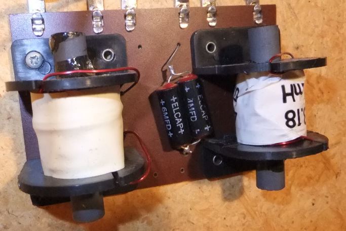

Thank you for your help. I've replaced the caps and foam surrounds in the AR18s pair and the AR38s. The tweeters in the 18s sound light, airy and clear. The exact same model tweeters in the 38s sound harsh, edgy and forward. Any ideas on how to tame them?

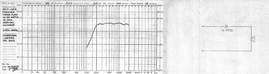

AFAIK, the AR-18S and AR-38S have the same tweeter:
http://www.classicspeakerpages.net/library/acoustic_research/special_sections/drawings/SpeakerDrawings.swf
Therefore you are actually hearing cone-breakup from the notched 10" bass of the AR-38S, here shown WITH the notch.
You might disconnect the 6uF bass notch capacitor and hope for a similar sound to the AR-18S. Notches are a double-edged sword. They increase cone output above the notch frequency. We can only hope the different 10" bass rolls off OK.

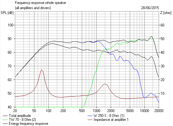

Below is the tweeter response with a simple 6uF capacitor. Crosses over at about 1.5kHz by the look of it.

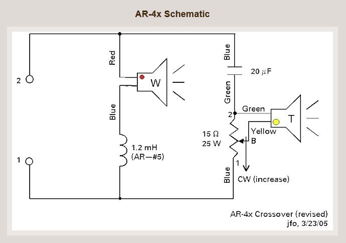

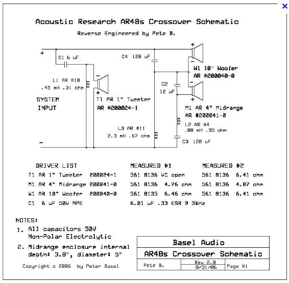

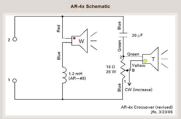

I throw in the AR-4X crossover and the AR-48S just for fun. I know forum genius wolf_teeth did some work on turning the AR-4X tweeter filter to second order by adding a coil, but can't dig it up right now. 🙂

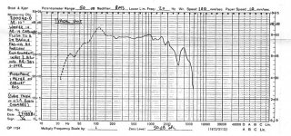

I was wanting to see the response curves for the tweeter and woofer and....here they are!
This is exactly the information i wanted, so thanks again.
The harshness does appear between 2.5K and 5K, which is where the peak is on the woofer response curve.
As an experiment with the 38s, I'm going to remove the 6uF cap from the notch filter, so I only have the coil in series as a 1st order crossover. This starts to roll off at about 2000 hz?
If that still sounds unsatisfactory, I'll try bypassing the coil on the woofer, and using a 4.7uF cap in series with the tweeter instead of 6uF, to simulate the same setup as the 18s.
I think you are correct when you suggest it is the cone breakup on the 10" woofer I am hearing.

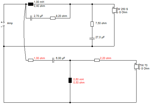

I spent some more time on the AR-38S, Graveyboat. It was tougher than I expected.
Unless you add Inductance to the circuit, which will make it bassier, you really can't do much with it.
The 6uF 3kHz Tank does a good job of rolling off the bass and aligning phase IMO. But it was deeper than necessary, and in fact only the non-polar capacitor resistance stops it being a huge pit. I found adding a 3.3R resistor made it smoother. But for all that, the mod might damage phase alignment. I don't know if AR's circuit is brilliant or stupid! Without the tank, you get quite a peak at 4kHz anyway.
There is also the possibility of doing a second order tweeter without dropping the impedance much at the top end. Say 5 ohms goes to 4...worth a go, I'd think. The tweeter ought to sound smoother. Hope that helps.

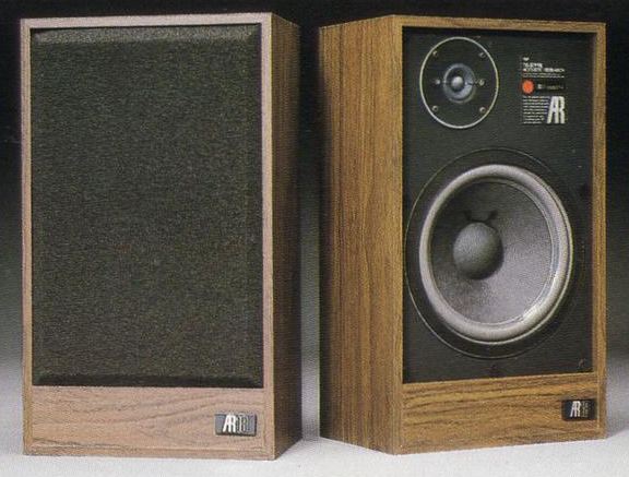

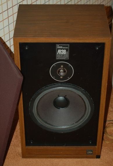

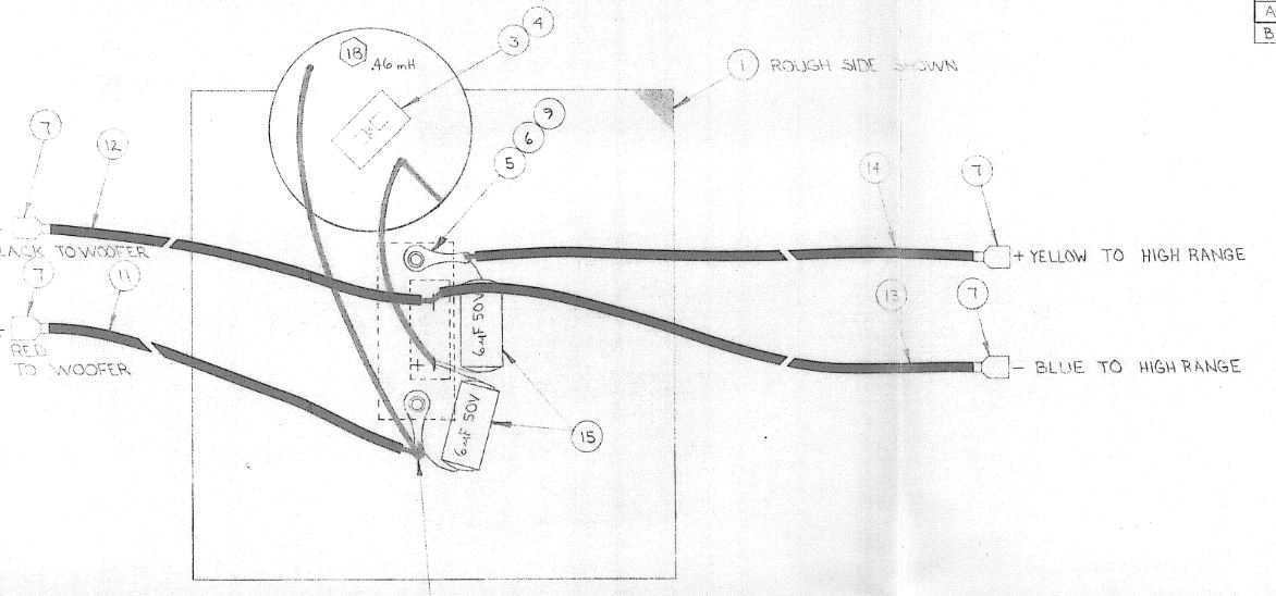

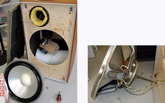

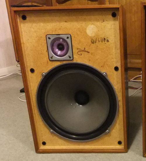

Hi guys. I just bought a set of AR38s 1981 speakers that have a little damage on the outside and the 10" woofers need refoaming. I have started the refoaming process but I was thinking if I should take this a step further and try to improve their sdesign in any way....
I have been looking online for a picture or drawings of how they are constructed and how they look on the inside so that I can know more before I make up my mind what to do, but I have not found much of any use. I am a noob in speaker refurbishing but I have a lot of professional experience in making and refurbishing furniture. So I´m good with my hands and have to tools but am not very knowledgeable about the science of making speakers.
Can you give me some advice or maybe some links that would help ?

I recently trash-picked a pair of AR38s. After re-foaming them they play pretty nicely. I really like that fast sealed-box bass sound. They're kinda shouty.

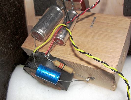

I hate notch filters, just on aesthetic principle. I decided to go ahead and replace the crossover with a 2nd order Bessel filter at about 1800Hz to see what happens. The steeper attenuation should help reduce the woofer's cone break-up...
To help anybody else in my situation, here's the values I (crudely) measured from my AR38s drivers:

If it was me, these days, I'd try a circuit like below. Tweeter coil between 0.45 and 0.6mH.
10" bass likes that 3kHz notch. Leak used it in the 16 ohm sandwich speaker. The capacitors are 1,8 and 16uF. The resistor is 22 ohms. The coil will be 3mH I'd guess.

I can confirm that at least one of these AR tweeters has ferrofluid in it.
One of my tweeter cones had come unglued, so I partially disassembled it while re-gluing. There's ferrofluid in there -- it's old and thickened but I didn't bother to clean it out or replace it. I also didn't bother to open the other one, which was still firmly glued together.

All I did with that modelling is add a Zobel and a tweeter coil really. Ought to get more rolloff. Have a play with Boxsim to get some idea of what does what.
Once you get a circuit that works, you can tune it by ear. Our own speakerdave did a similar sort of thing to the AR-4X, and he knows what he's doing.
