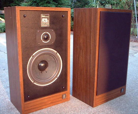

My dad has this old pair of AR28s, and i remember loving the sound when i was a kid. Unfortuntly he has not benn able to use them for 5+ years because the foam sourrounds on the woofers rotted away. So now I turn to the expertice and knowldge of this forum to recocmend a driver that might fill the job of the original woofers. It's looks like a 7 incher. Even if you arnt an expert on this particular type of speaker, I would still like reccomendations on speakers that could probobly foot the bill for this type of speaker. Not looking to spend a fortune (ex nay on the seas), just want to get em back in working order for my dad before x-mas. Thanks Guys.
The only real way to go is to have the surrounds replaced.
The picture shows a pair with the surrounds replaced.

Many AR's including possibly this one, had an 8" woofer that rolled off naturally at 1800 Hz or so. Actually, for many years, AR 8 inchers all had the same woofer!

I believe that 8" did not have an electrical crossover. It rolled off gradually by itself. To find a replacement, you would need an 8" that gradually rolled of at approximately the same place.

If these are the model I believe these are, the intrnal box volume is half a Ft³, or 14 liters. The boxes are 3 dB down at 50 Hz, according to AR literature-if it's the model I thought it was. A set of parameters for a replacement 8" would be:
Impedance=8 ohms
Fs=25 Hz
Vas=1.5Ft³ or 42 liters
Qts=.4 or thereabouts
Sensitivity, (commonly called efficiency)=87 dB or so
But there are other parameters that will work. 🙂
Be sure to let me know the exact model number. And check out a couple of electronic repair stores. I really do think the chances of getting one cheap are very good-so many different models and years using the same woofer....

try :
http://www.speakersupply.com/AR.htm
new AR drivers $55 each,
AR poly/rubber version $58 each (probably best long term),
pattern replacements $45 each.
KW is correct, the bass/ mid unit does not use a crossover, it
has a designed in mechanical roll-off to match the tweeter, very
difficult to find a modern unit designed to be used this way.
🙂 /sreten.
