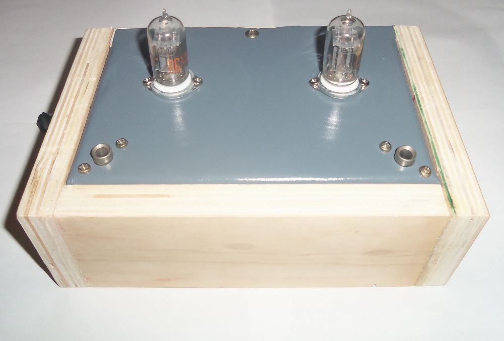

Hello everyone!
I recently designed and built my first tube amp project, a little low voltage, line level, tube preamp. It has a painted metal top and wood sides.
I'd like to put some sort of labels on the different connectors and switches.
Is there a very cheap and easy way to do this?
I appreciate any help.
Thanks.

As far as brass punches go, that's not much work to me. In the bottom of this post is a picture of the amp that I wish to put labels on (as well as in my user picture), I did all of the woodworking and I also made that top metal cover out of a small piece of steel by hand (I had to hammer down the sides so they fit on the inside of the wood, you could see it if I had a picture of the underside, oh and its not even finished 😀 ).

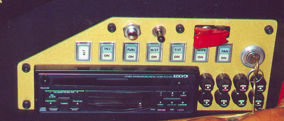

My techinque, that I use for switch labels on my custom cars.
Fire up Microsoft PowerPoint on your PC. Draw a box, slightly larger than your panel. Add text to the box, selecting the font and size from the PowerPoint menu. You can also select italics, etc, if you want. Easy to center the text as needed, and to move it around until you are happy.
Print the final product on a clear sheet of acetate (used to be called Vu-Graph plastic). I use a black laser printer; this might also work in colors, on an inkjet printer (but I've never tried the latter). Trim the acetate to be slightly smaller than your panel, using the box you drew as a cutting guide. You can later trim the acetate even more accurately, after you mount it, using a razor blade held firmly against the edge of the panel.
The tricky part for you, will be selecting the best adhesive to mount the acetate to your panel. Best to experiment on a scrap panel first, particularly if you front panel has a painted surface. Good luck. (For my switch legends [see pic] I do NOT use glue; the frame of the pushbutton holds the label in place).

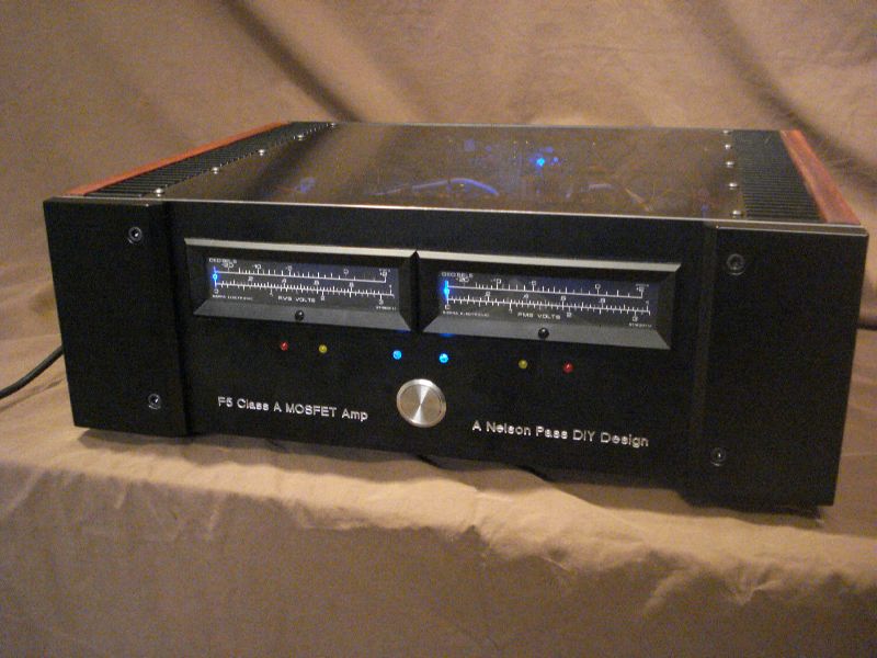

As an alternative, why not get Front Panel Express to engrave a panel for you? They have a downloadable design tool, they make very professional results, and the are quick and pretty cost effective. They can also cut/mill and panel openings you might need.
(See my F5 amp's front cover pic for an example)
