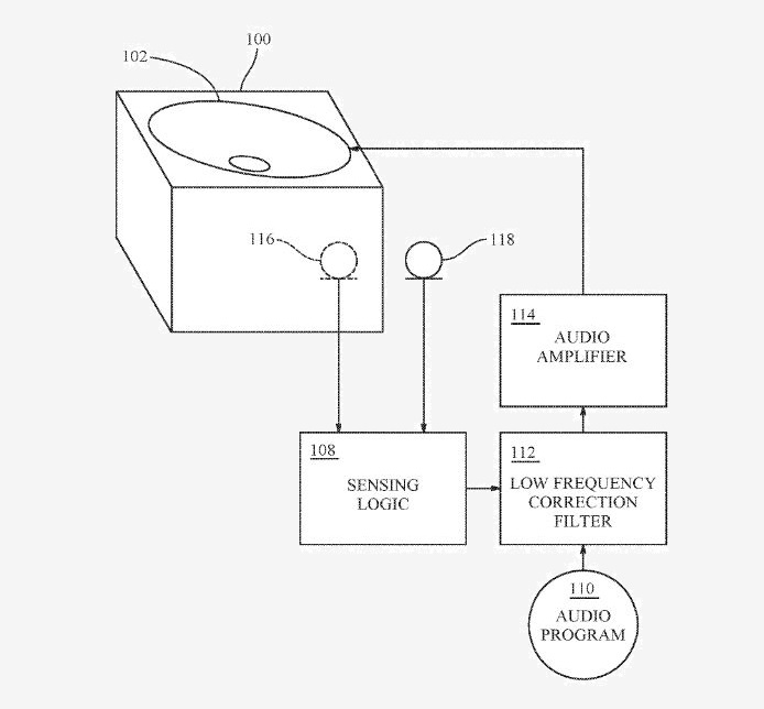

Based on patents filed by Apple, the Homepod possibly has some clever tricks up its sleeve. I have no verification that these all are incorporated in the Homepod. Information taken from patentlyapple.com.
The U.S. Patent Office Publishes Six HomePod and Future Apple Audio Inventions - Patently Apple
1. One patent describes that a microphone array can be used to find nearby reflective surfaces. This information can be used to know where to steer the sound beams.
http://appft.uspto.gov/netacgi/nph-Parser?Sect1=PTO1&Sect2=HITOFF&d=PG01&p=1&u=%2Fnetahtml%2FPTO%2Fsrchnum.html&r=1&f=G&l=50&s1=%2220180352324%22.PGNR.&OS=DN/20180352324&RS=DN/20180352324

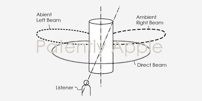

2. As it can use beam steering, it can send both a beam of direct sound straight to the listener and beams of delayed and possibly decorrelated sound to side walls, to give a sense of ambience. Similar to single speaker stereo, but better.
In this video there appears to be a microphone inside of the enclosure, suggesting this feature is implemented in the Homepod. YouTube [at 2m 43s]

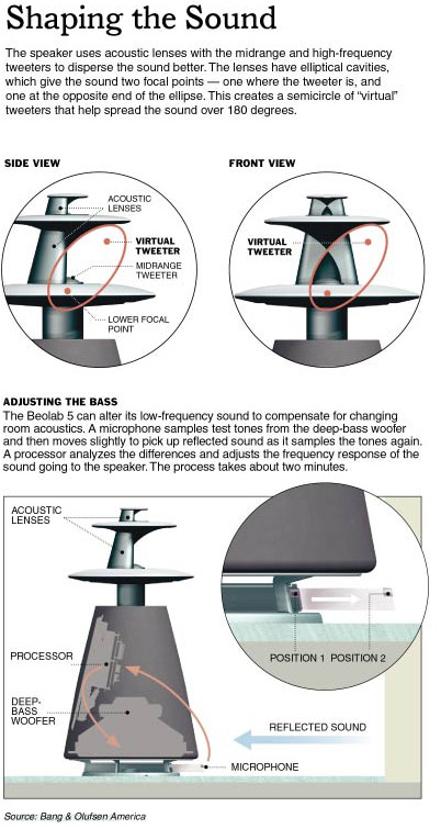

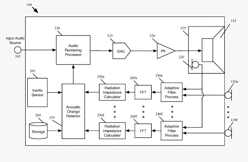

3. Another patent mentions measuring the radiation impedance, which is the information required to know how much room modes are energized. The figure in the patent shows both microphones inside and outside of the enclosure. With this knowledge, a parametric equalizer can be set to counter the booming effect of room modes. It appears to be similar to what Bang & Olufsen does in the Beolab 5.Apple patent said:The system may aim ambient content toward a wall and direct content away from the wall, if the acoustic environment is not in free space.

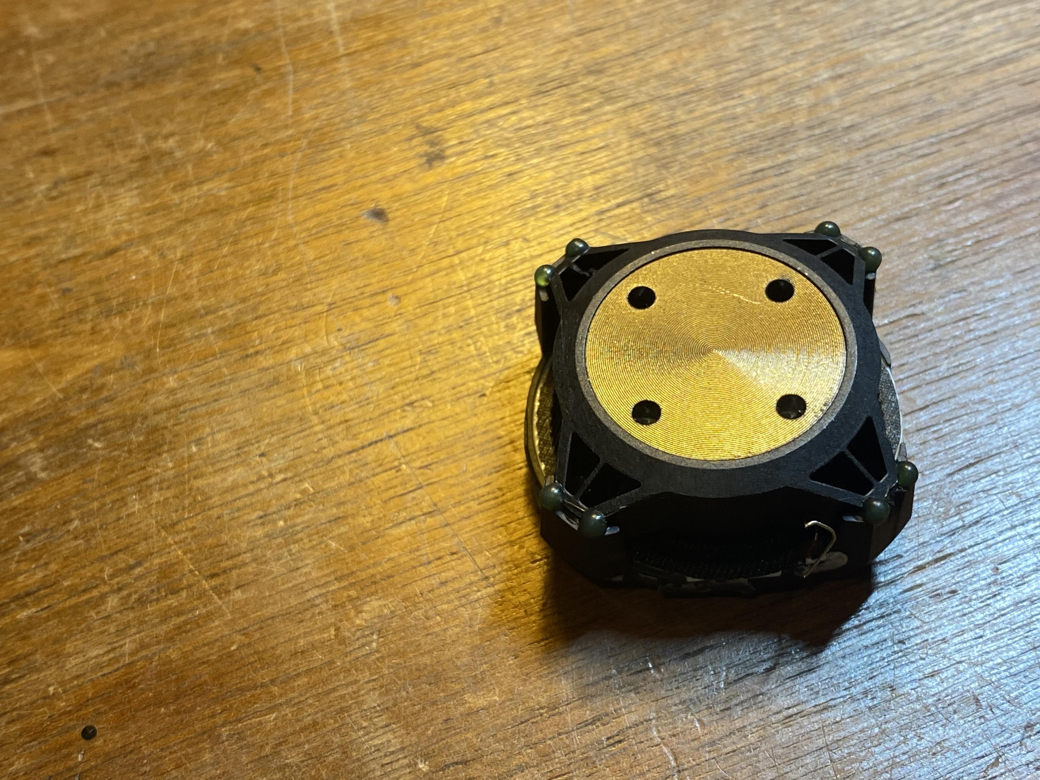

Despite being called a DML, that looks a lot like the JBL/Foster 25 or 35mm dome FRs Apple has used in the millions since the 3rd generation iMac.
DIY2000
dave

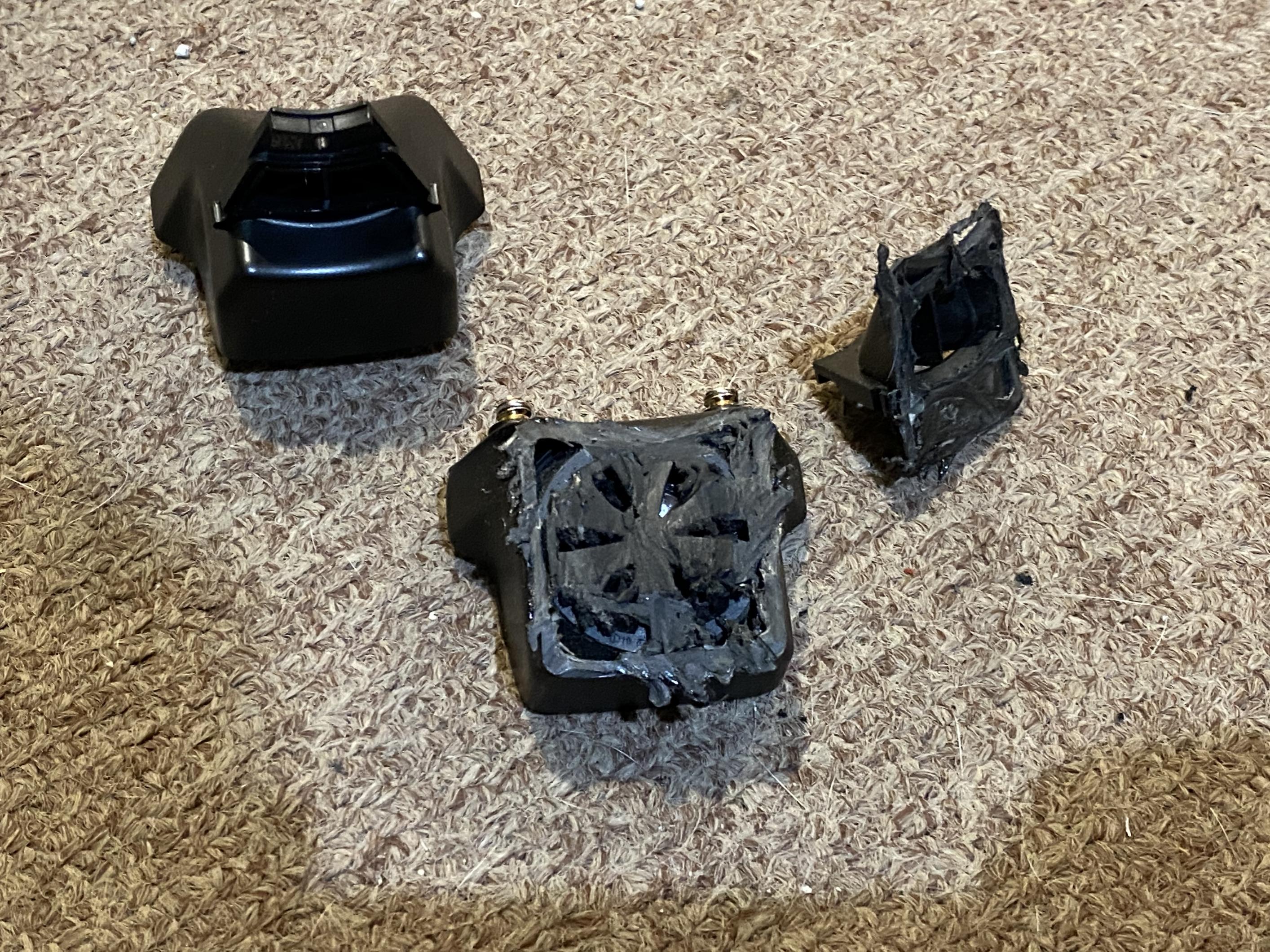

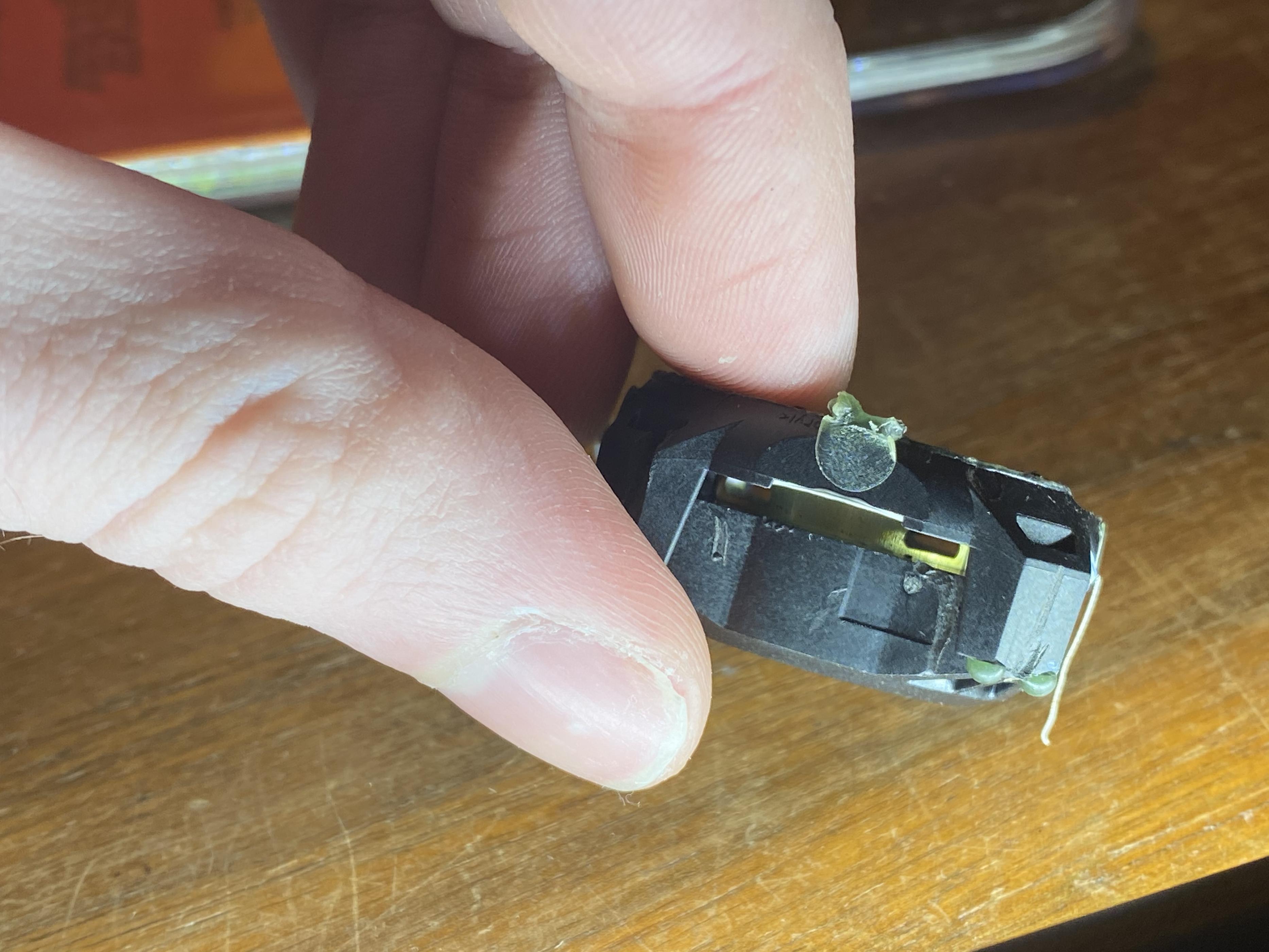

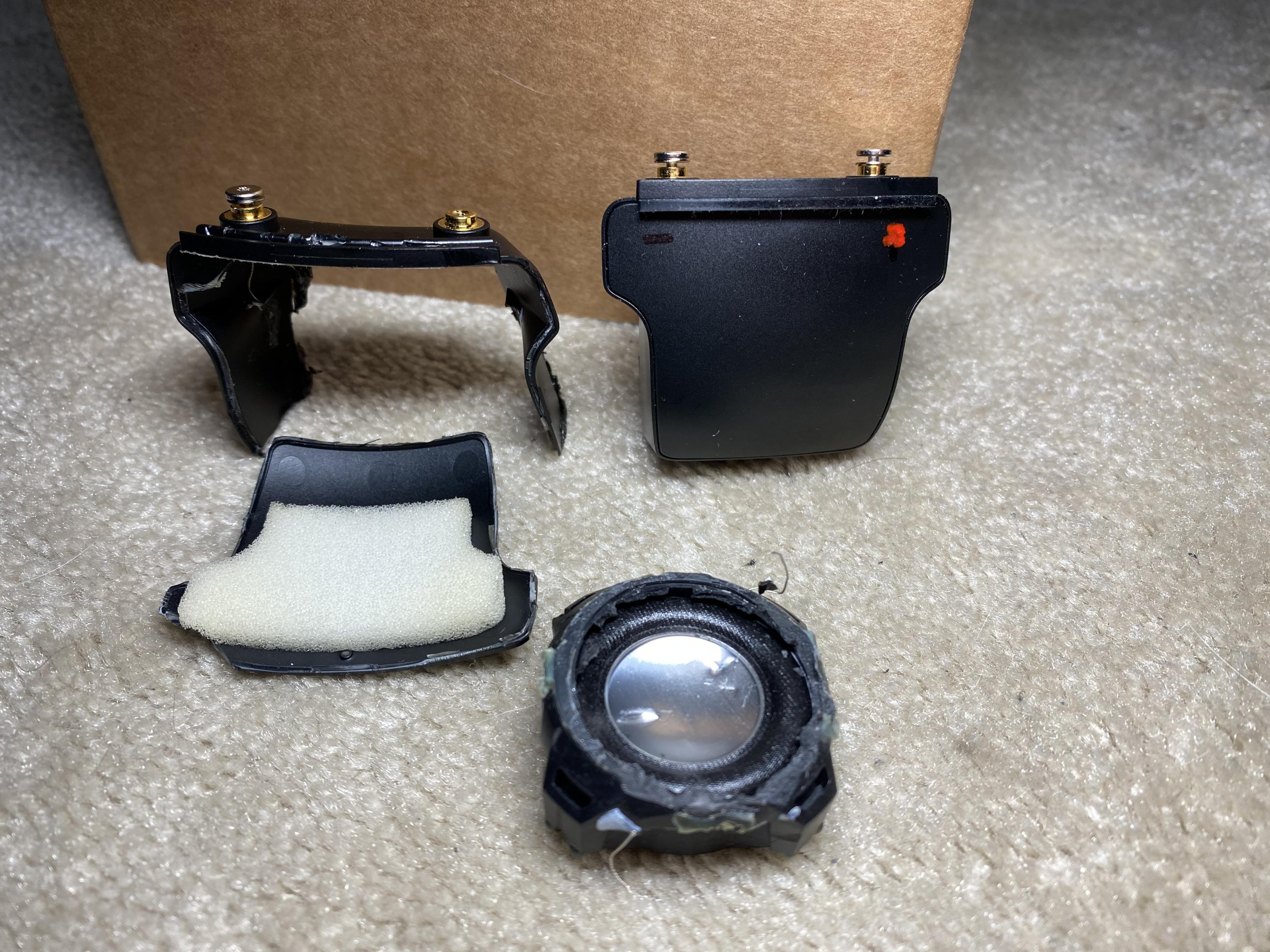

It's not the same though, but it's close. From having torn both apart, they only similarities are the aluminum used for the tweeter's diaphragm. The sound sticks are more full range. The HomePod sounds bright and brittle with the woofer disconnected.
Looks like HomePod didn't sell according to Tim's expectations since it was discontinued Friday night.

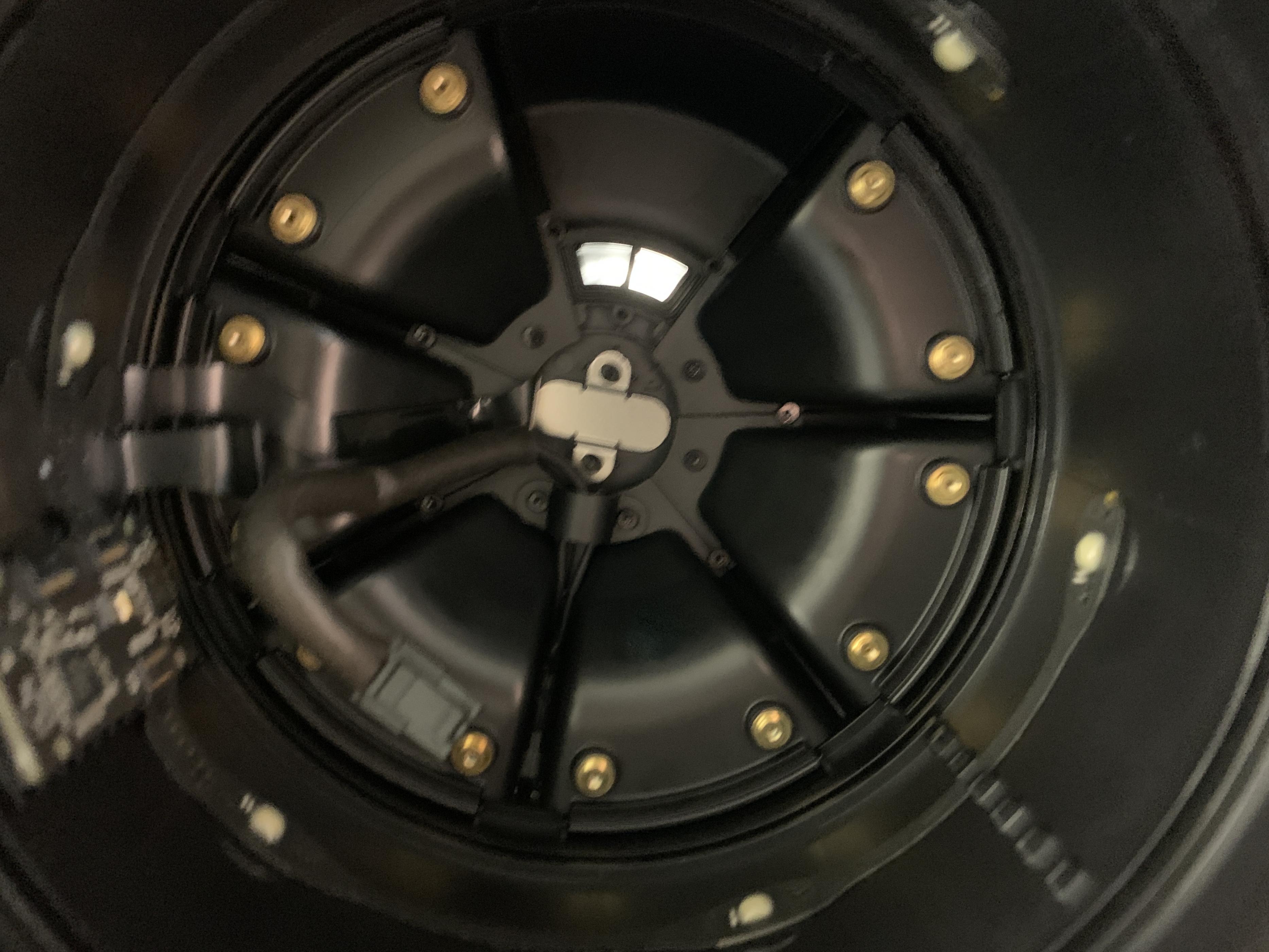

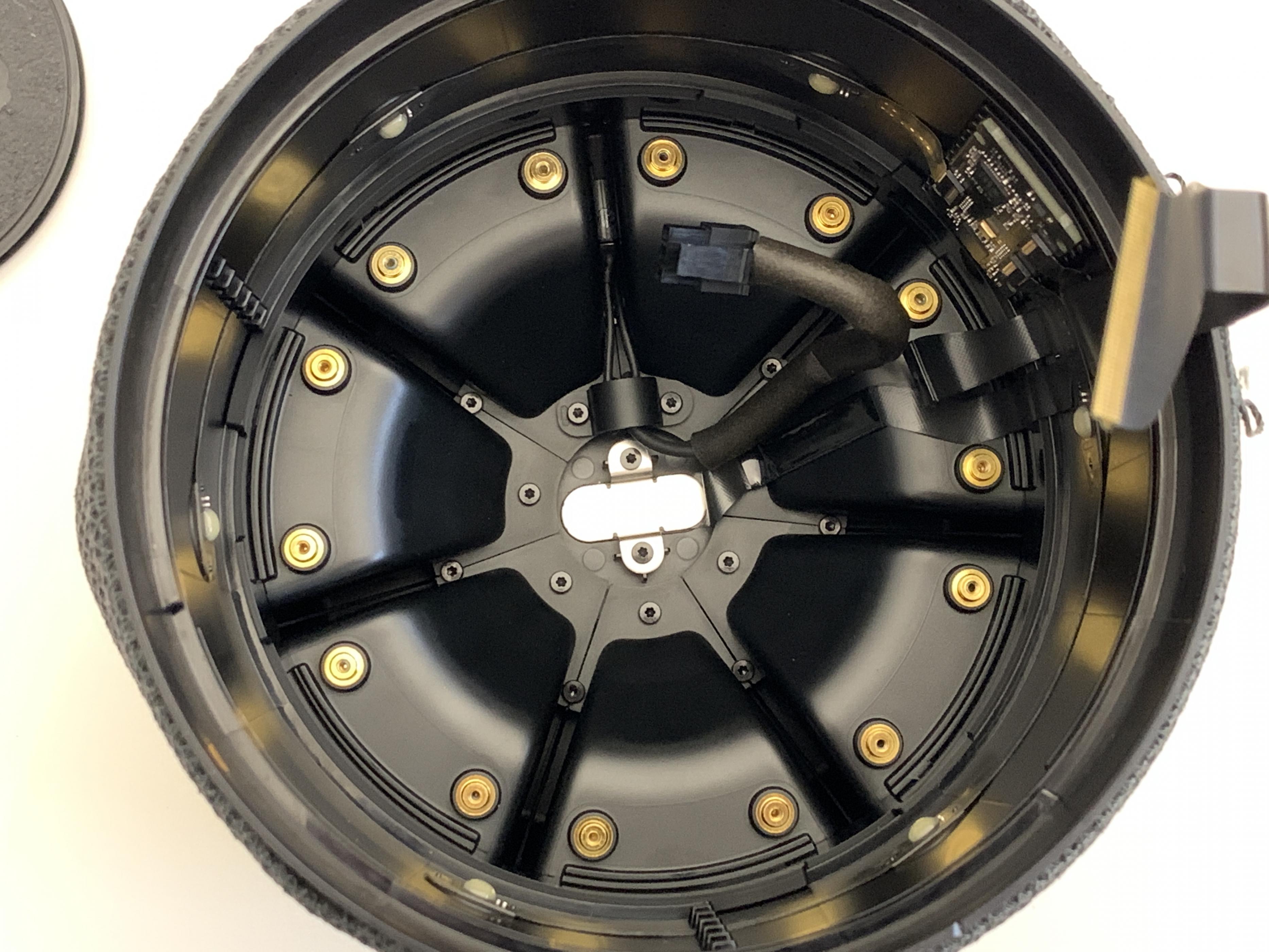

I'd be curious to know if the tweeters could be wired in series/parallel, a crossover designed and built, for both the tweeter array and woofer so one could use a dead HomePod's enclosure and drivers as a passive speaker..?

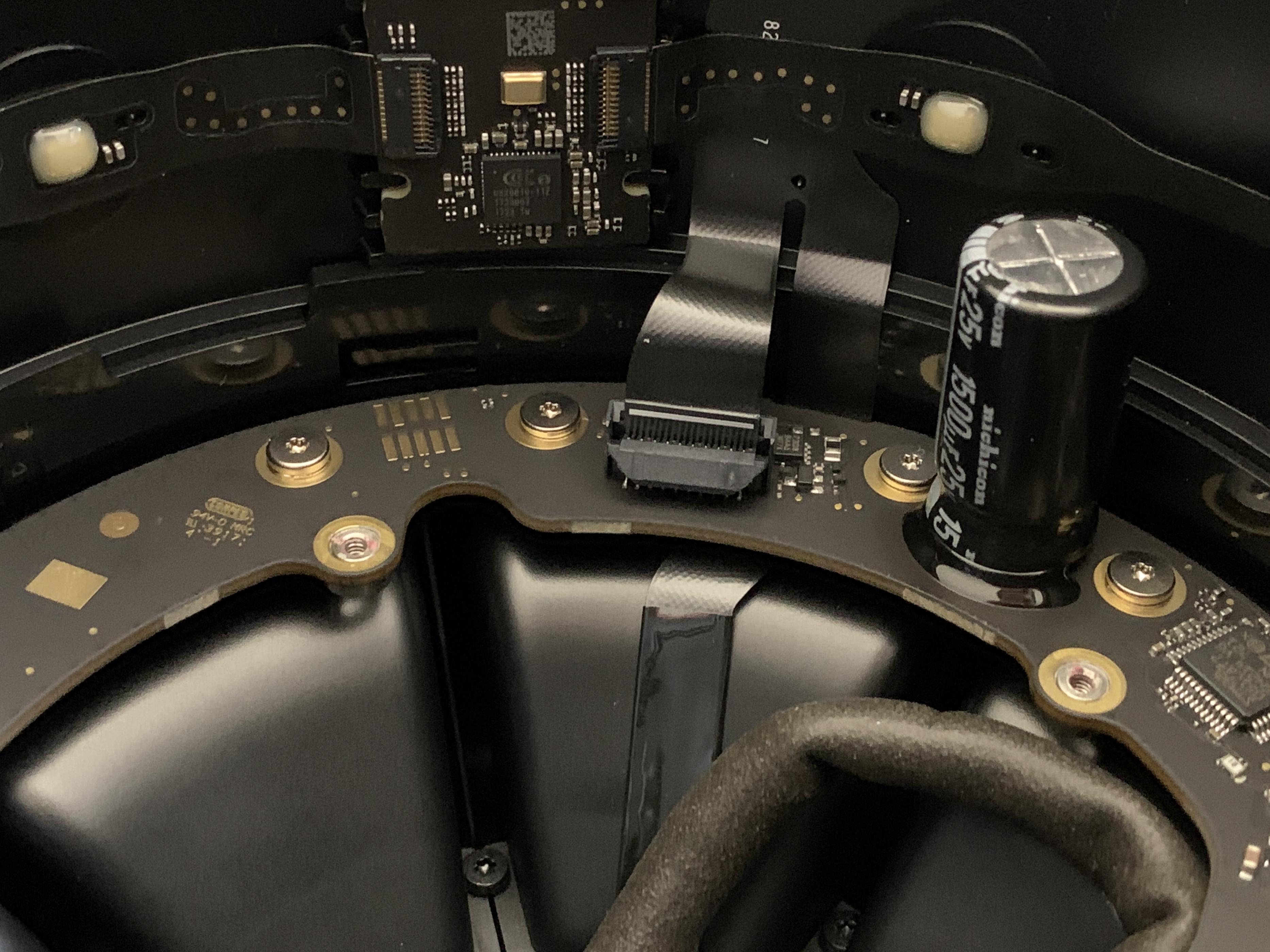

You wouldn't get custom beam forming sound stuff since each tweeter is driven separately. The HomePod's amplifier board has 7 Analog Devices SSM35158 (one per tweeter). The level of each tweeter is controlled by the logic board based off what the 6 microphone hear. There's a 7th microphone JUST for the woofer to ensure if isn't over driven at higher volumes and to ensure it's bass-ey enough at lower volumes.
