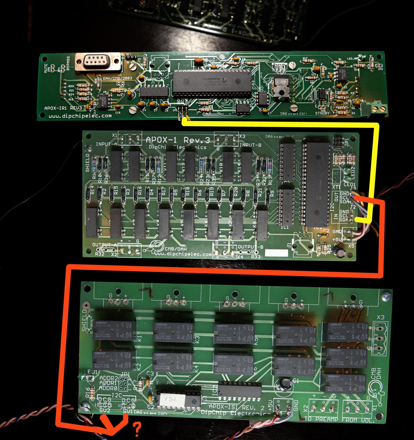

Question 1; I have build a 5V powersupply. Can I just connect this to the APOX IR1 (rev3), the APOX-1 (rev3) and the APOX-IS 1(rev2)?
Question 2; It took me some time to understand the term "daisy-chaining" but I managed. Is it correct to daisy-chain from IR-1 to APOX-1 I2C "IN" and from APOX-1 I2C "OUT" to IS-1 I2C. Is there a difference between I2C SV 1 or SV2 on IS-1?

This is how it looks.
Bottom PCB is a double deck. Connected through SV1.
My guess is to connect the APOX 1 (middle PCB) to SV1.
Pic below is how I think it should be done.
Other information is here: Apox Controls
The APOX is not for sale anymore...
I have read the instructions. My drawing is based on it. But there is a little voice in my head that says "be carefull". After reading the manual again I still come to the conclusion that my drawing is correct. I can connect the red line to SV1 because that is also where the connection with the board below is.
Do you agree?

I took a look at your products.
You have correctly drawn the control hookups.
Basically the I2C control path is a daisy chain. Controller hooks to first board, first board hooks to second board. Repeat if additional boards.
Looking at the schematic, input and output I2C are just jumpered together.
Really no electrical difference if you use the input or output for I2C. Use one or the other to connect the orange to the bottom board.
I assume you have a handle on the audio path, which is not shown in your drawing.

You don't show the second IS1 board, but one connector goes where you have shown it with the question mark. I believe it can go in either position. Then the other connector is used to "daisy chain" it to the second IS1. I don't think you can hurt anything with these connections.

Yes, that is absolutely what I am talking about.I'm not sure if I understand the quote below.

Thanks.You don't show the second IS1 board, but one connector goes where you have shown it with the question mark. I believe it can go in either position. Then the other connector is used to "daisy chain" it to the second IS1. I don't think you can hurt anything with these connections.
