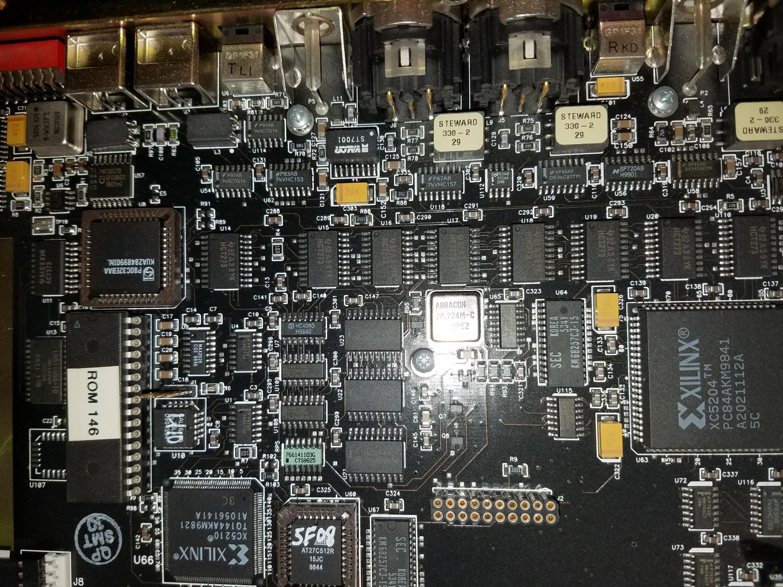

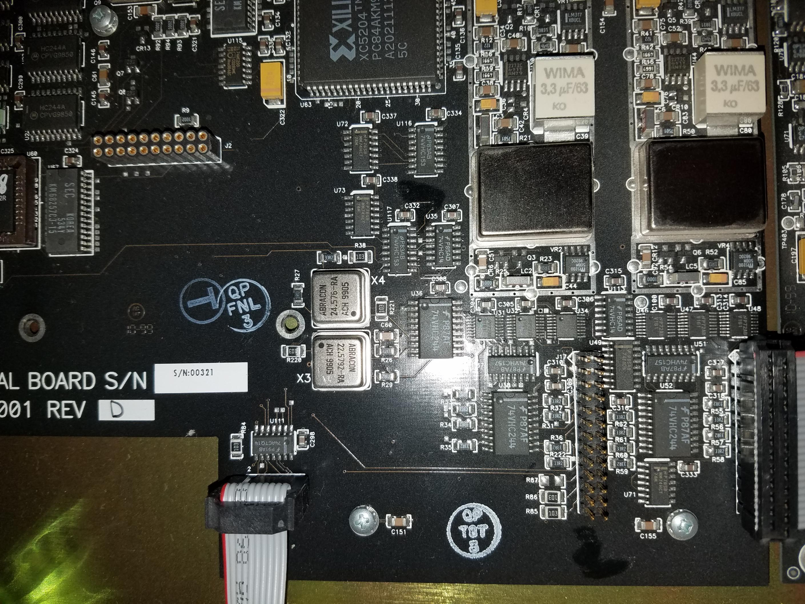

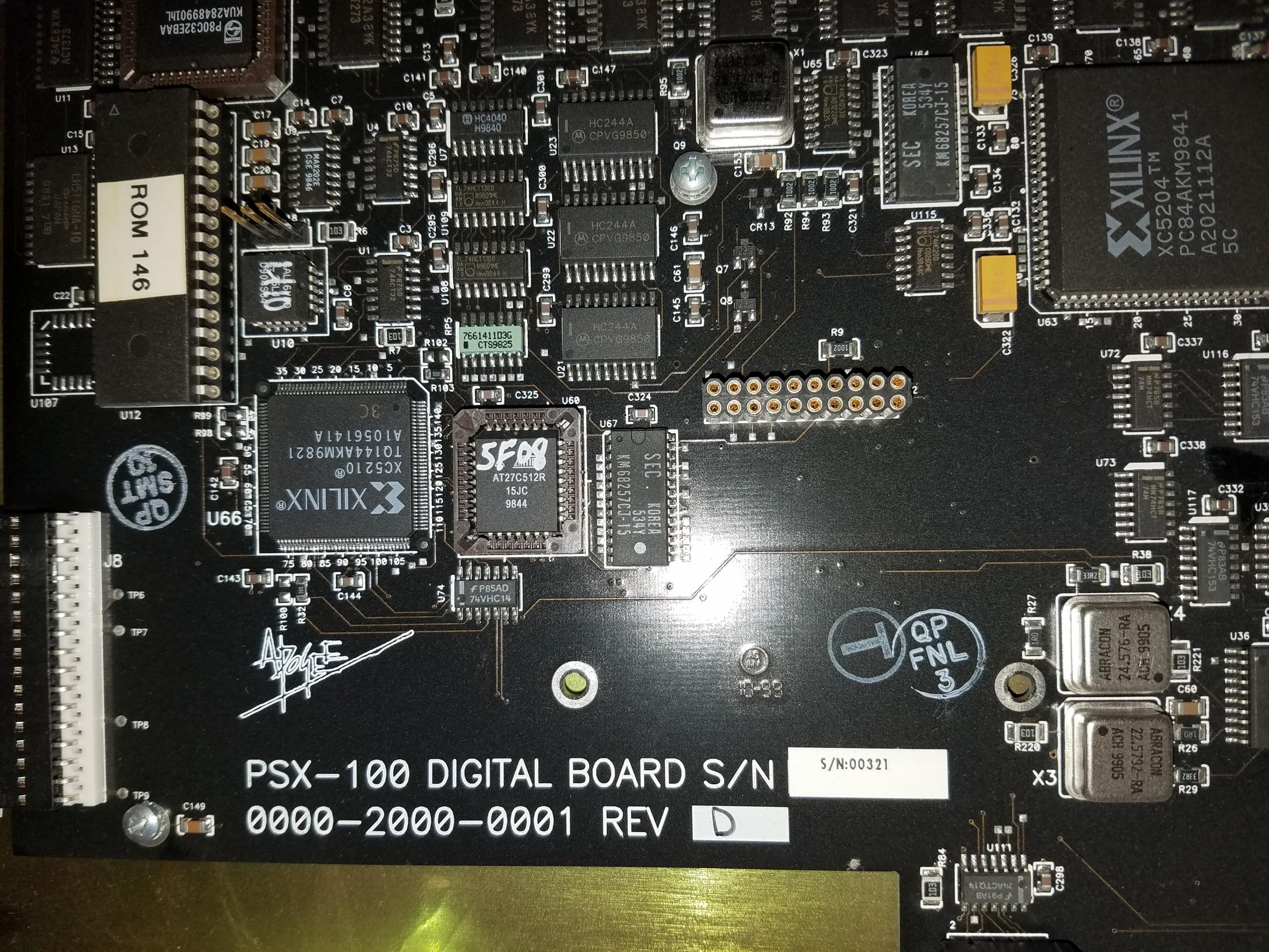

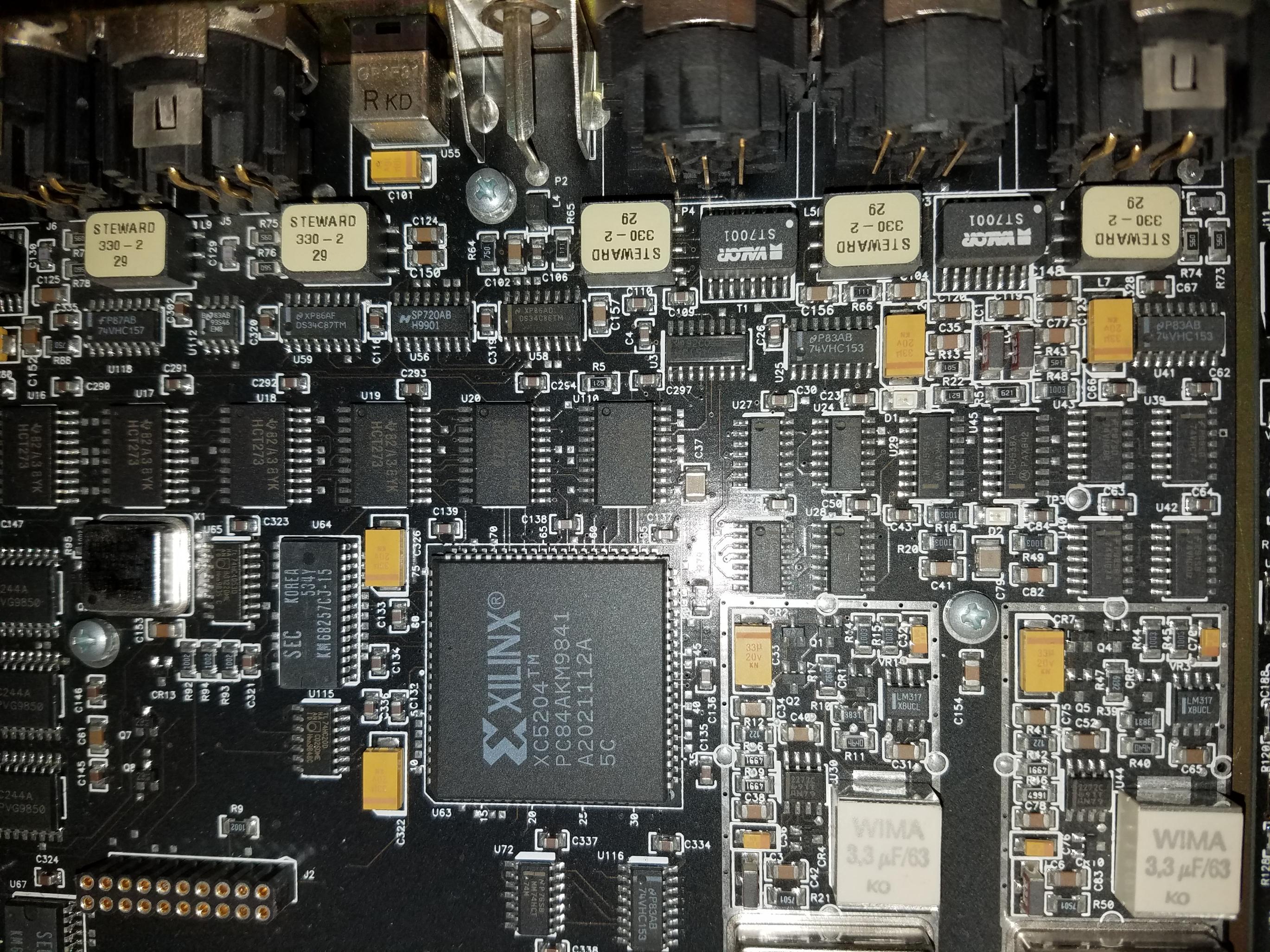

See attached. I only spent a bit on it last night but I've got the SPDIF IN through L4 and C102, with R64 as a terminating resistor. It then goes into pin 6 of U58 which is a line driver. Pin 5 is the output of that driver and then it drops of the map. I can't find the next connection within 3in or so!

It might be worth trying reseating the microcontroller (U8) and its memory (ROM146). It is unlikely to fix things but its simple to try. After that comes freezer spray and then tracing the clock back from the DAC chip or trying an external sync.
Ok, so I was able to reseat the ROM but no change. I wasn't able to do the uC because I don't have a PLCC extractor and I didn't want to crack it.
I also tried unsuccessfully to locate where the damn SPDIF trace goes. I'm pretty sure this is a 6-8 layer board so there's no trace to follow.
On the plus side, I was able to get a decent bit of the AD section traced out!
Have you got pictures of the ADC and DAC boards ? It will be easier to trace the respective sync signals back to their source than to trace the SPDIF signal as it has to be decoded before sync. The picture I have of the ADC board shows it to be the CS5396.
