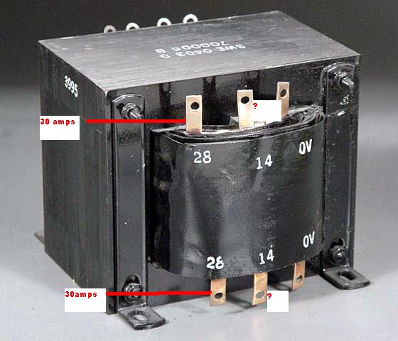

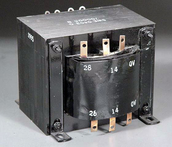

2 centertapped 28 VAC secondary windings...40 lbs of transformer...there is a nice picture on the web site under the new section....click on the picture there and you will get a larger one...here it is

So there is NO confusion...this transformer has dual 28 VAC center tapped secondary windings each rated at 30 amps.
105, 115 and & 125 VAC inputs

jaudio said:6 1/2" X 5 1/2" X 8" , Primary 0 - 105V - 115V - 125V, Secondary... Dual 28V - Dual 14V and 0, 60 Amps - 30 Amps each side, WEIGHT 40 lbs each $ 45.00
Can someone clear this up for me?
How many secondary taps are there on this transformer?
There are 2 28 VAC center tapped secondary windings...
There is NOT a set of 28's AND a set of 14's...
What there is ...is 2 28 VAC center tapped windings.
It's clear from the picture...click on the picture for a better view

28 VAC * 30 Amp = 840 VA if we did the multiplication correct...per secondary @ 28 VAC ...
If you attach 120 VAC to the 105 VAC taps you will get a bit more voltage out...
the 2 secondary windings in series will give you 28*2 VAC @ 30 Amps...
This is a VERY nice transformer...

1/137 said:14 VAC * 30 Amp = 420 VA/secondary @ 14 VAC
rt
With 1680va for the two 28 volt winding,wouldnt 420 VA/secondary @ 14 VAC be past the 2k capacity?
The 14 VAC comes from the 28 VAC windings...it's the center tap....you can't pull 30 amps from the 14 VAC taps AND pull 30 amps from the 28 VAC..the 14 VAC winding is really the "lower" half of the 28 VAC winding...
I could be wrong but it seems like if you max out the 28 VAC windings that is all you get.

I have a photocopy of the vendor spec sheet...it's tough to read...it looks like it says 2 kva...although I don't know how they get that number. I can't imagine needing more capability than this transformer can deliver...assuming the voltage works for you.
