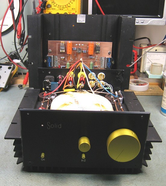

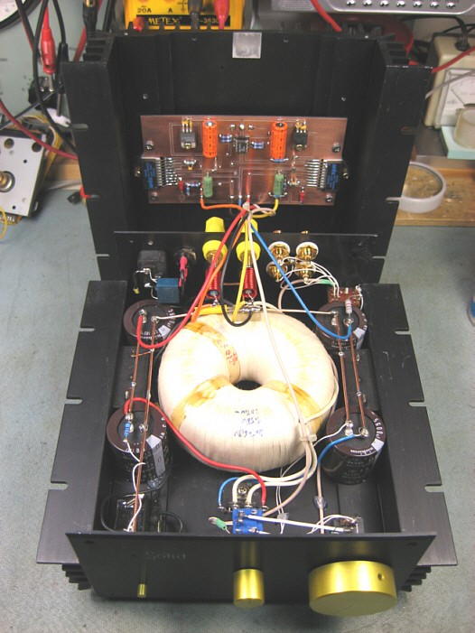

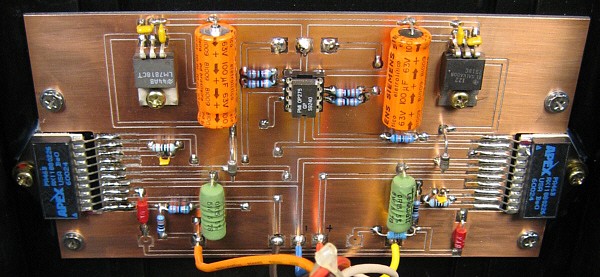

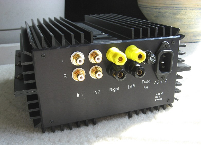

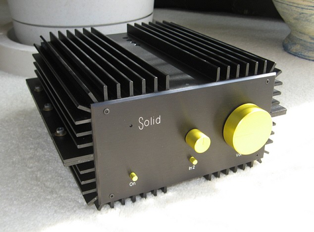

My friend ,who gave me the chips made one amp with the PA45's for O.Peterson. He liked it very much. I think this is an excellent sounding amp and it is easy to build.
Thanks. Almost everything is in this amp coming from surplus.
Except the input connectors and the knobs.
I thrive on surplus stuff.

We have a large CNC at work, for wood and aluminum....6 foot by 12 foot. I wonder if it can do small pcb's ??
I have some 3oz copper board.

Very nice,but tell a few words about the influence of the transformer (strayfield effect) to the chips.
Because of the poor distance from toroid to pcb maybe you have some "noise" on your speaker?
