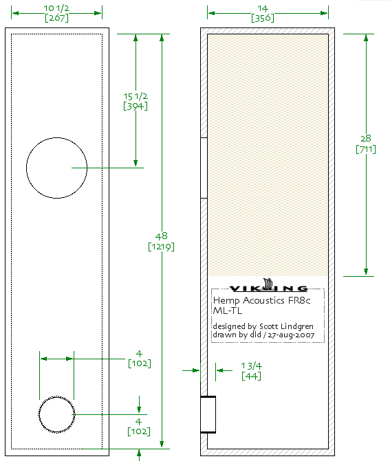

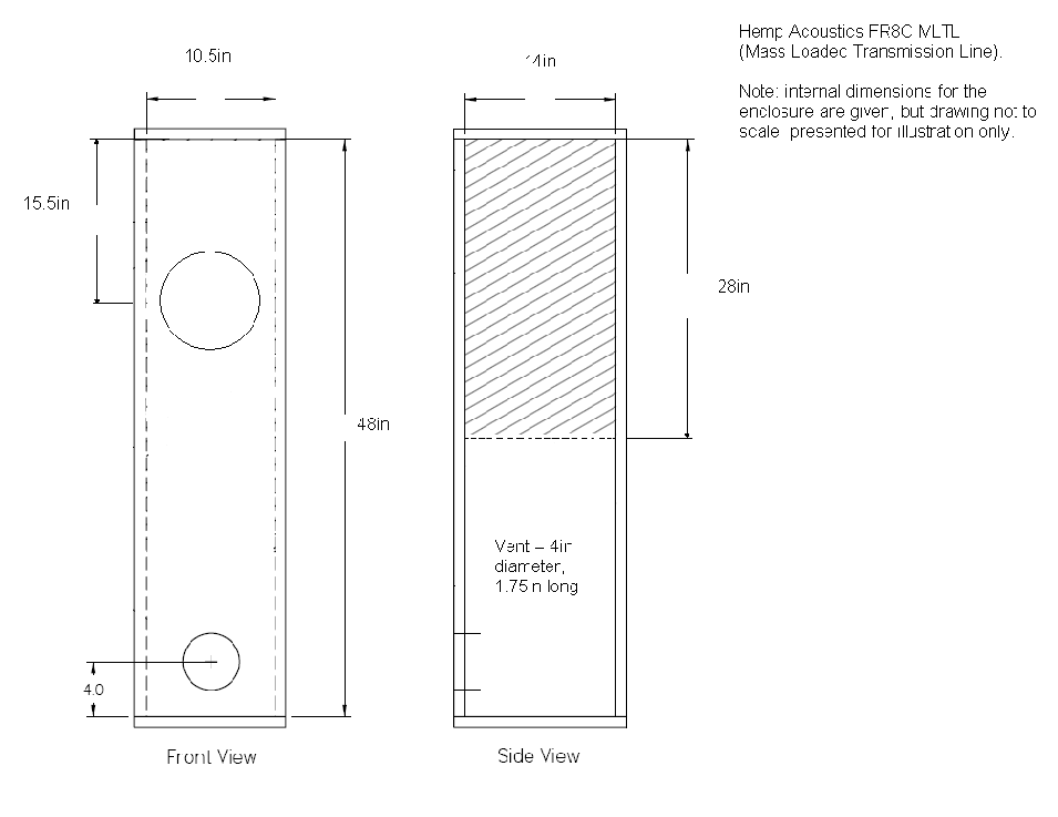

I did an MLTL with this driver for a friend on another board a week back, if this is any interest. Not being able to drive a CAD programme to save my life, I modified one of MJKs drawings (hope you don't mind Martin). The depth dimension hasn't come out too well: it should read 14in (all dimensions internal).
Depth is 14in; all dimensions given are internal. I noticed it'd come out blurred for some reason just after posting, so I edited it to clarify that size. You must've had the bad luck to catch it right before I did. Sorry about that.

That MLTL for the hemper looks good. I think I might build that one. Does it sim any worse using 49 inches as the interior high? Just to save some cuts with the mdf.

Re using 49in internal height, you need to be careful, as you'll lower the tuning frequency slightly & the loading provided by the vent. It should be OK though as the difference isn't massive.
Thanks for checking that there Scottmoose, and the drawing Dave. I think I will be trying this speaker for my main system.

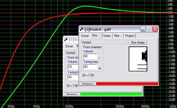

-3db in the 40's in a 20L box tuned to 42 Hz ?
-3dB @ 40Hz is no deep bass ?
I must be missing something ......

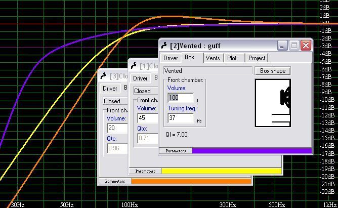

Er, unless I'm missing something, it's the 80 litre box that gives those figures in the WinISD plot. The 20 litre box looks like it's down 3db over the nominal driver free air sensitivity in the mid 80Hz regions, after that big peak at Fc.
Check out the specs too, of these drivers. With a Qts of .41 , they are almost ideally suited to a ported
enclosure. I had asked Perry a little about his choices and beliefs. One comment that stuck out was
that many full rangers require complicated enclosure to work well. He simply wanted to provide a full
range driver that could be put into an enclosure that most normal humans could build, or to allow a
cabinet retrofit to occur. He had suggested an enclosure of 20 litres or so. I just so happen to have a
pretty well built pair of enclosures, that I thought would fit the bill. Tuned to 42 Hz as per Perry's
recommendation,I stuffed the drivers into the boxes. Later Perry had indicated that he thought I
should remove some of the Dacron used in the enclosures as dampening material, which I did.
Perhaps its the above from the review that is confusing me ........
