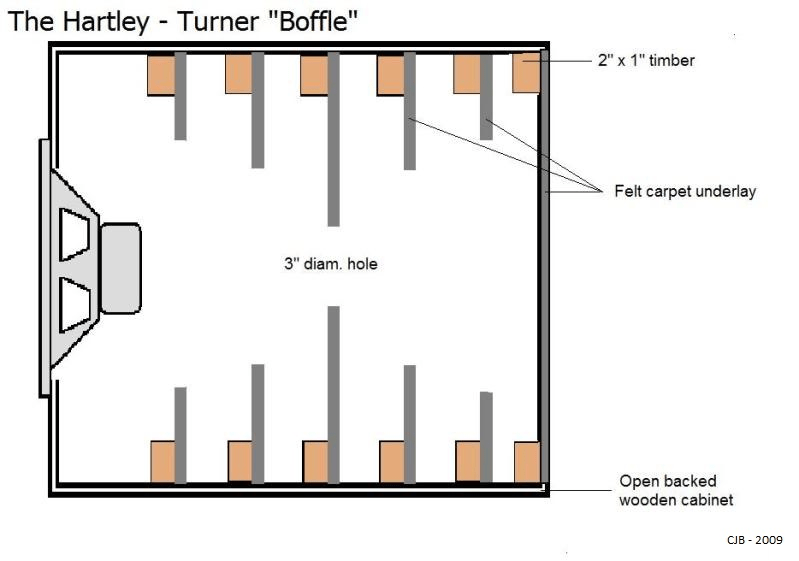

While looking for that, also ran across the Hartley Boffle. No idea how well it worked, but it was a thing.
https://theaudiostandard.net/thread/2130/hartley-speakers-boffle
"Hartley designed and sold his 'Boffle' speaker, which was apparently the first attempt to remove the effects of the rear bass radiation from speaker cones. The design was a box containing a series of spaced baffles behind the main driver. The baffles were wooden frames with felt carpet underlay stretched across them. Each baffle had a different sized hole cut in it - the first being just behind the driver had a diameter a little smaller than the driver diameter. The second and third were reduced successively in diameter down to 3 inches. The fourth & fifth baffles had progressively larger holes in them & the final one didn't have a hole."

Hartley "Boffle" is interesting suggestion but back wave elimination is less effective under 100Hz.
