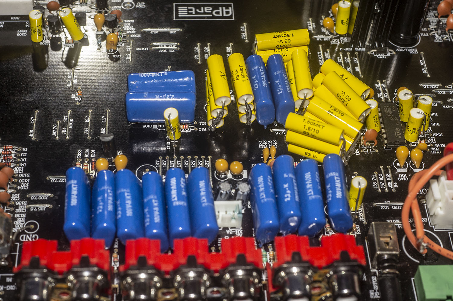

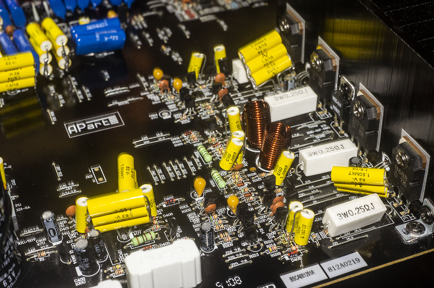

My Apart Concept1 amp started sounding distorted a couple of weeks ago, so I replaced all the large electrolytics and it cured the issue, I suspect the three caps next to the voltage regulator heatsinks had dried out.
However, there is still a problem, the amp has four inputs labelled A, B, C & D. It works great on B, C & D but A sounds distorted.
I also changed the 2.2uF electrolytic caps on the inputs to 2.2uF polyester ones, I don't have a service manual or a schematic, otherwise I'd replace all the caps in the signal path.
So, anyone got any bright ideas as to how to diagnose and fix input A? The only thing I can think of is to trace the channel from the input jacks, replacing all the caps along the way. However, I'm dubious that just a change of caps will do the job as the other 3 channels sound fine.

How is the source selected, by mechanical switch, or analog switch, relay, etc?
Could be a capacitor or a bad connection.

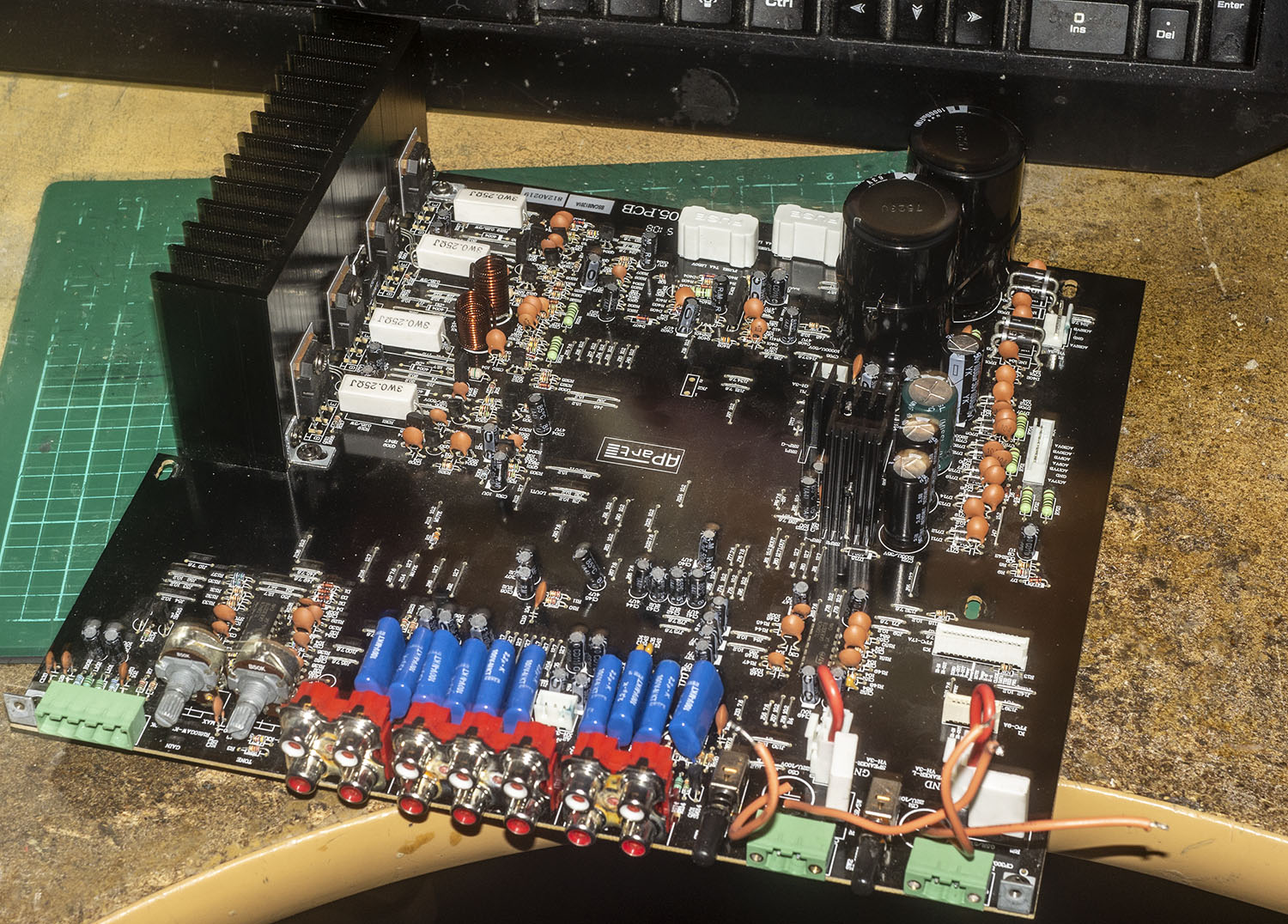

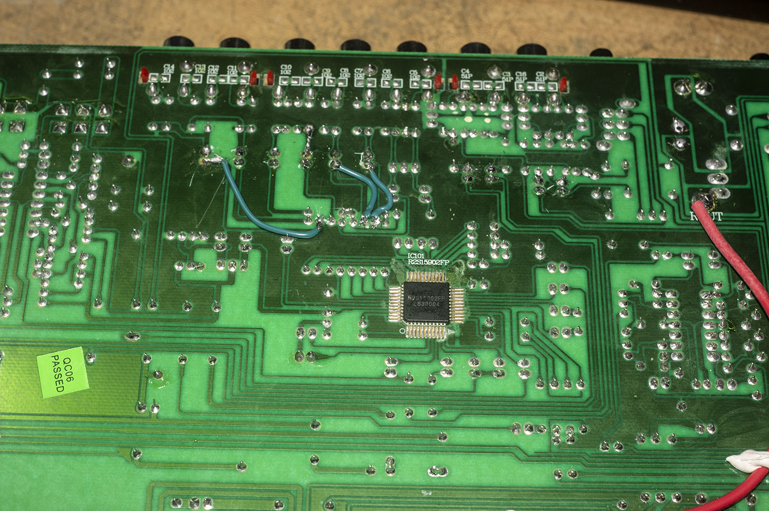

It's all digital as far as I can tell and it says on the front 'Digital Controlled Amplifier'. The main pcb has the inputs at the back then the rst of the board is taken up by the power supply on the left and the power amp on the right. There's another PCB mounted on the front panel that has a microprocessor and I think that PCB is where the switching is done, there are several multiple wire connectors between the two PCBs. I shall take some more pics of the whole thing tomorrow in daylight. Not having a service manual is a PITA.
Then the first thing would be reflowing the relevant IC solder connections.
That is a common problem with reflowed pcbs, developing bad solder joints.
If you can follow the bad signal to the IC, just solder that one pin.
Look on the IC data sheet, that should be all you need.
Cheers that's helpful. I shall take it apart tomorrow and trace the signal from the A input across the main PCB to the connector to the control PCB and resolder all the joints along that path, then I can pull the control PCB and find out what IC is responsible for controlling things and repeat the resoldering on that PCB. I'll probably replace some of the caps as well as there are no polyester or polypropylene caps in this amp, it's all electrolytics and ceramic disks.

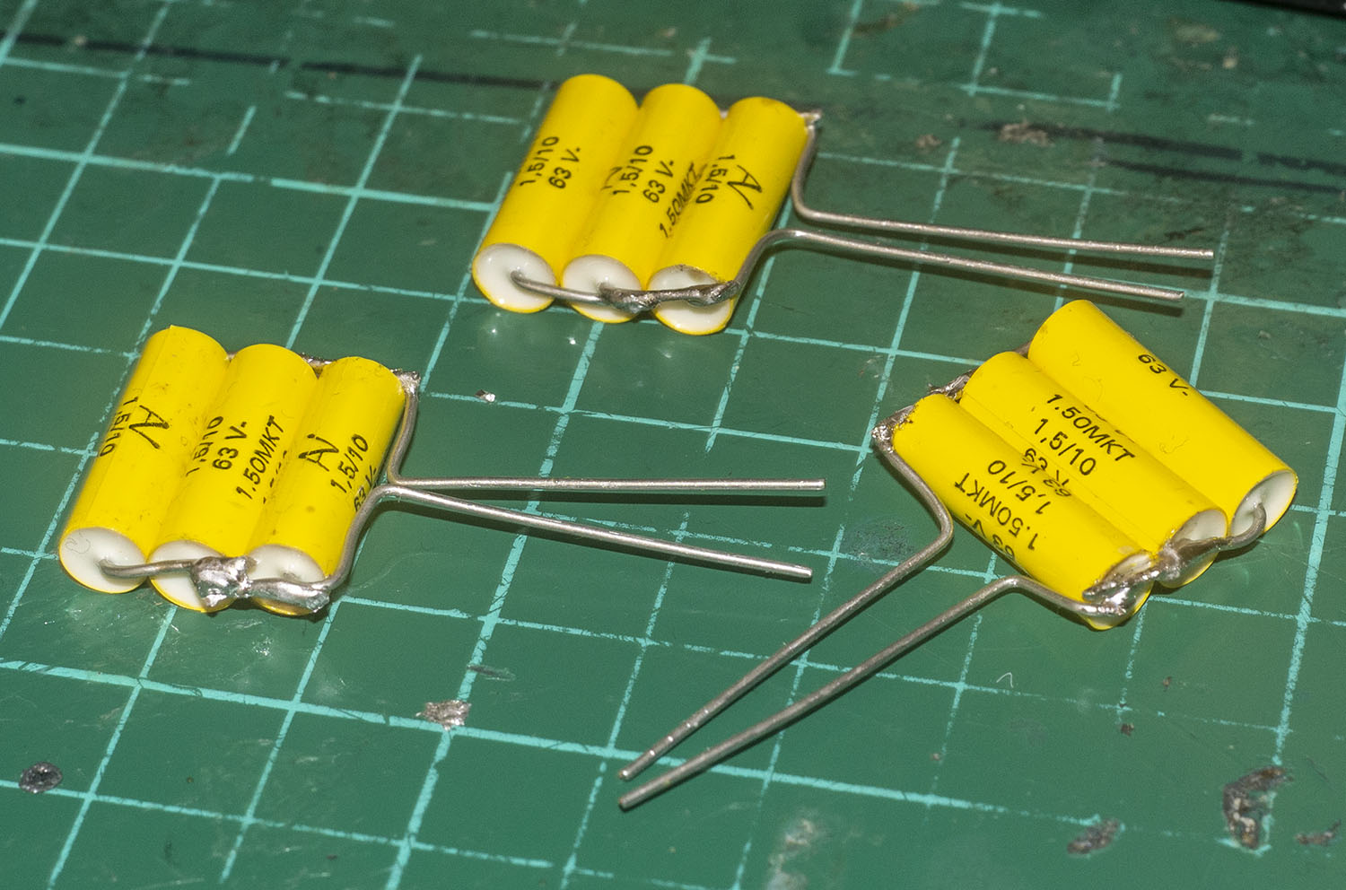

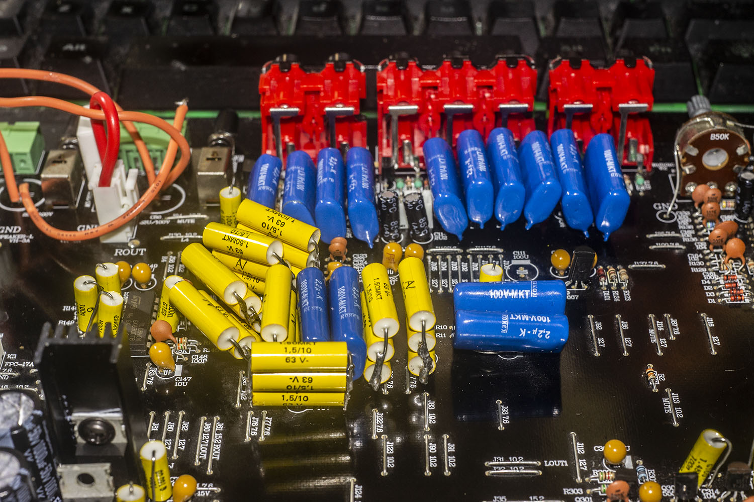

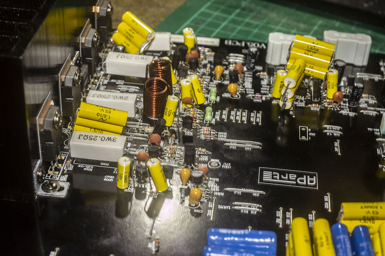

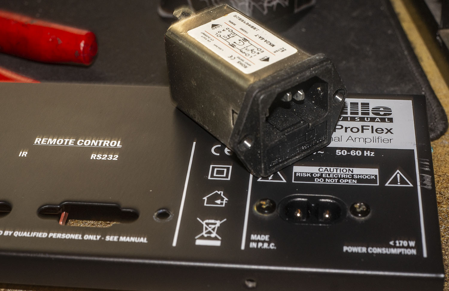

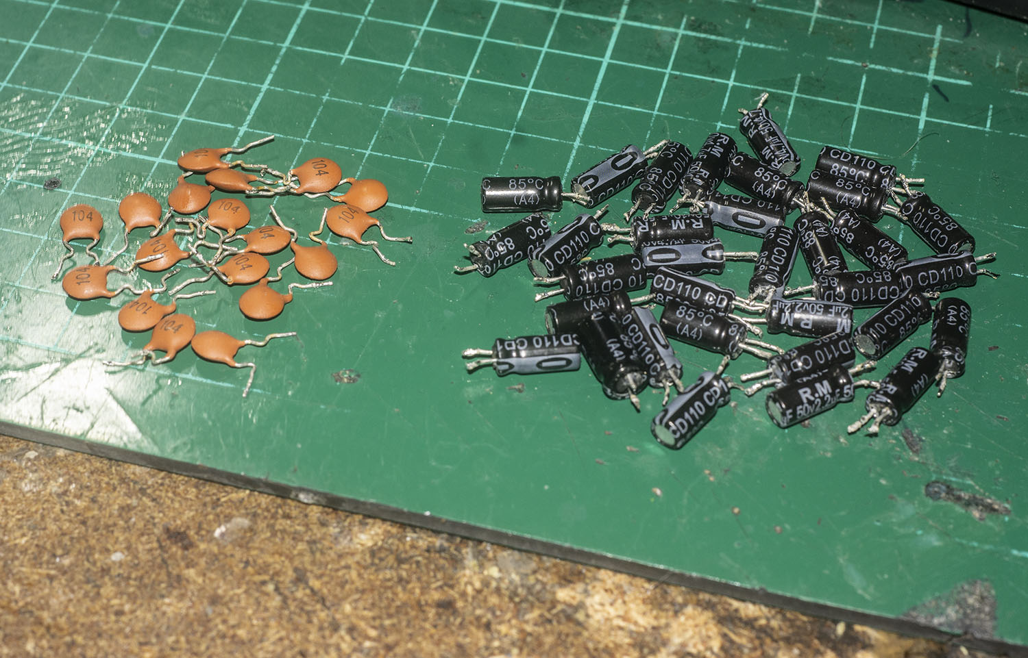

Well, I've spent the weekend working on the thing and made no improvement, Inputs B, C & D work fine, A is badly distorted. I think it's the IC itself that is faulty. I replaced all the caps with polyester & tantalum, but I don't think it sounds any different. I also changed the power socket from a 2-pin to a 3-pin with a built-in noise filter.
I'll keep this amp in service until I either build a replacement or buy something to modify.

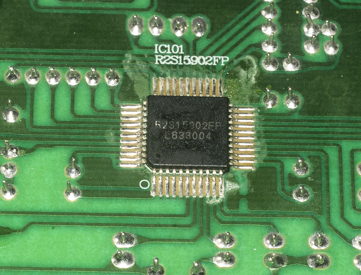

Check on the data sheet, the IC is a 6 channel selector and volume control.
Short or swap the connections from A and B to check.
It is still available, so not exotic.
Another trick I have seen is to brush a small quantity of flux on it, and flow all the joints with a SMD heat source, or you could use the solder paste used to bond SMD to tracks.
The solder paste is powdered solder and flux in a paste like consistency, used a lot for cell phone repair, among other purposes.
Clean off later, and see the result.
After an hour or so of use, the amp has died, it now displays 'Amplifier Error'.
I think that IC has died, sadly.
That is a selector.
See if you can select inputs.
And if you need to check, just short it out, from needed in to out, see if the sound comes back.
It could be an issue in the power amp section, if both channels are dead then maybe this selector is bad.
You can select 3 stereo inputs?
It just constantly displays 'Amplifier Error' on the display now, nothing functions, no sound, hence I think the IC is dead.
