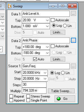

Do you know how to do a sweep? Look at the sweep panel, there you can set the start and stop frequency (default is 20-20k).
There are two quantities you can graph with a sweep, and you can select amplitude in the first (Data 1) and phase (Data 2) in the second. Then below that set the freq range, Source 1.

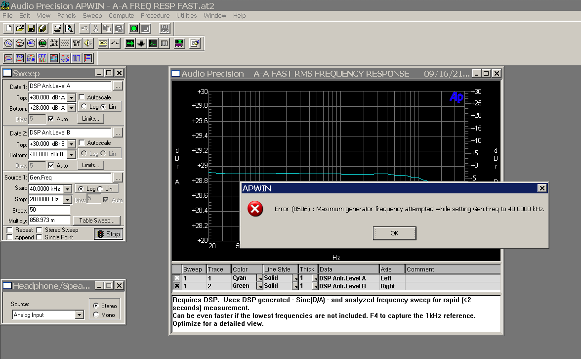

Hi Jan,
I can not go above 2x kHz there as I get ab error message…
Then again, for the Sample Rate I can not set up it any higher than 54k in the analog generatir “int Sample Rate”
So I feel lost here :-(

Hi Jan,
I think, I have got it…
I had the analog generator in the Sine (DA) instead of Sine….

There's a number of steps setting in the sweep panel. I normally use 30 or so, but if you increase it a lot, it gets slower.
Also, at each step, the analyzer waits for the reading to settle within a few % of final reading. Some circuits take longer to settle, and settling for low frequencies is generally also longer.
You can open the Settling panel to look at the values.
