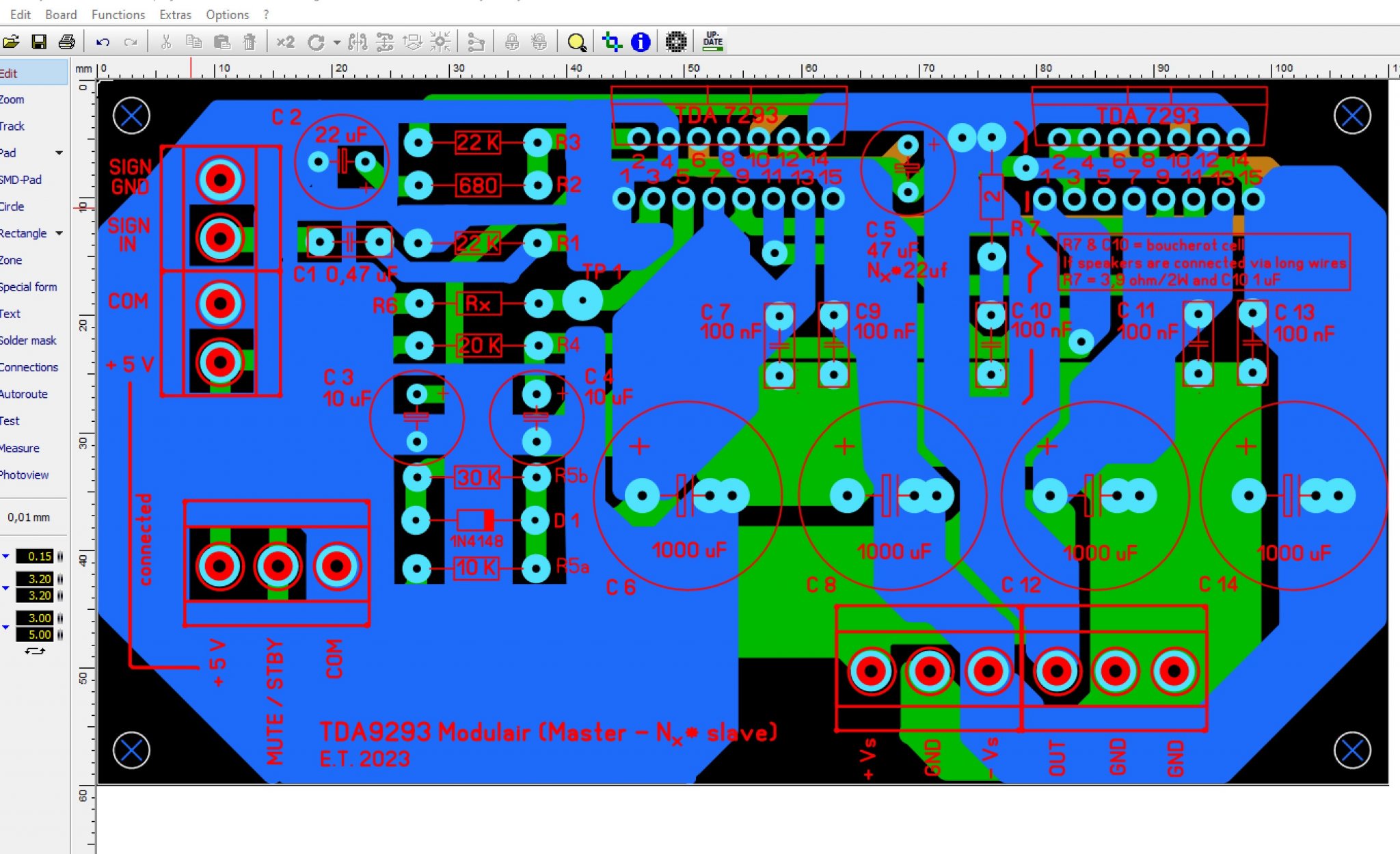

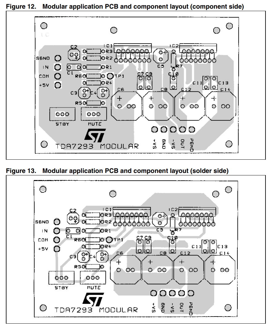

Hello everyone,
Aliexpress and Ebay modular TDA7293 PCB's seem like a crap shoot, why not just build the stock example in the ST TDA7293 data sheet?
Is there a reason I am missing that 90% of the for sale boards are not just a copy of this layout?
Thank you,
David.

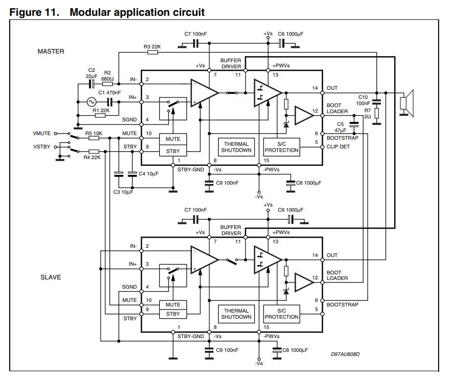

Hi David,
