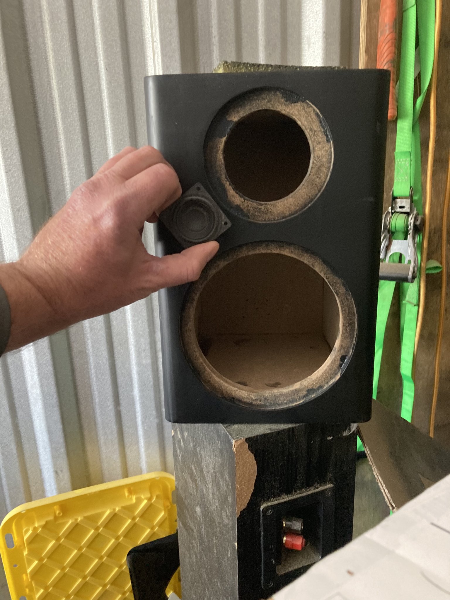

I personally would use a 3” midTweeter instead of a rweeter and a mid, but, discounting what they sould like, i like their looks, small and compact. Is the mid closed back? I wouldalso move the mid+tweeter axis closer to the edge of the woofer and mirroe image them. Get them as close as you dare. 5-10mm max, you might be able to trim the tweeter bezel or tuck it under the mids to get them as close as possible.

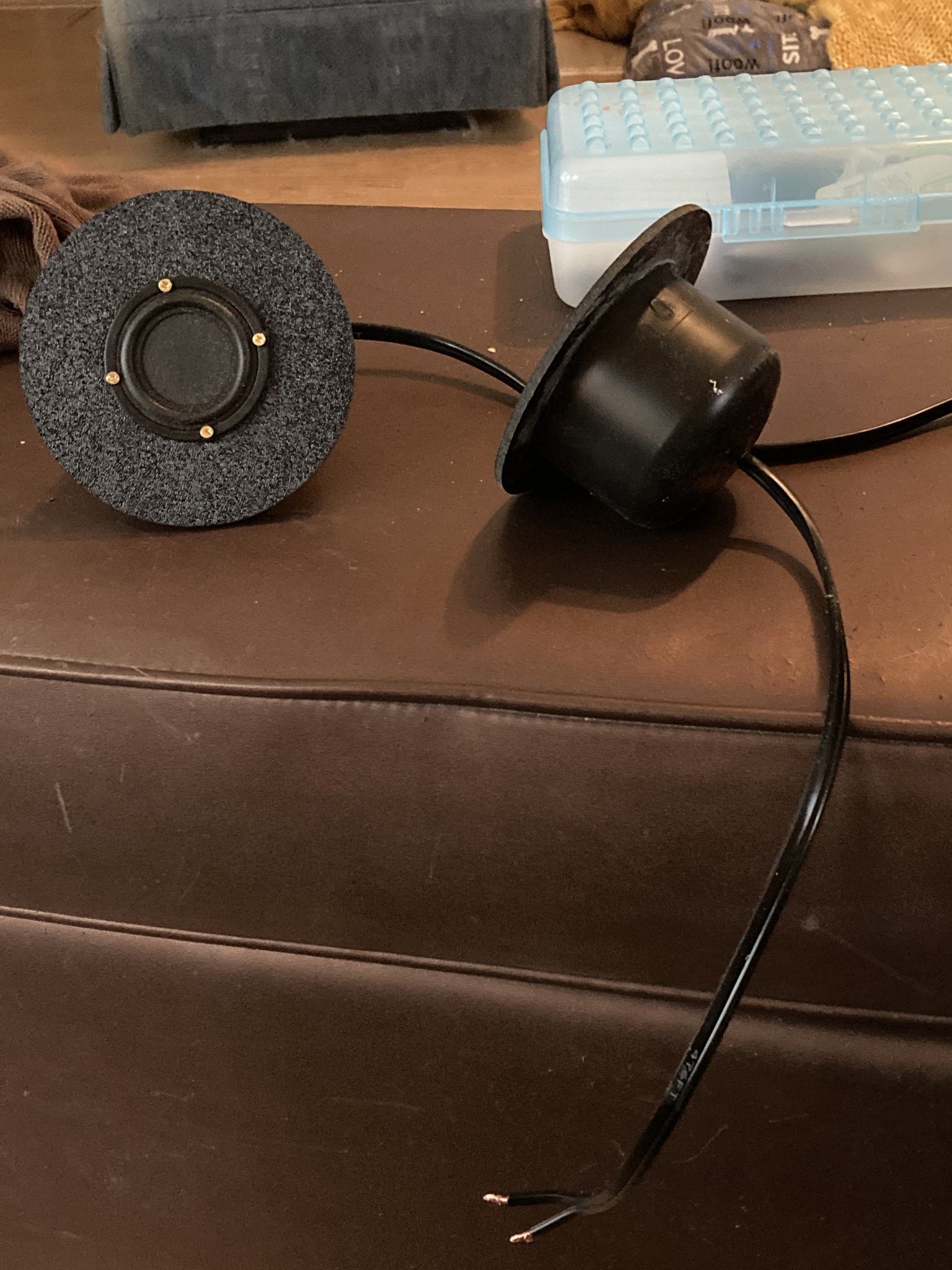

I’ve thought about running a RS100 aluminum cone fullrange if I were to go for narrow dispersion for the room. It would actually drop right into the cutout, which would be for a 1/4” pvc sheet with an appropriately sized pvc pipe end cap adhered to the back like I did with my tectonic 2” bmr’s in my shop speakers.

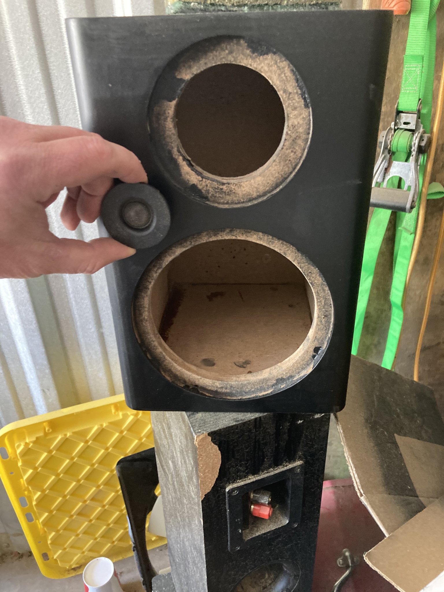

I thought I had a picture of the enclosures with the cutout and painted but an rs100 fits snug as a rug. I’m considering running the rs100 and fabricating a egg shaped tweeter capsule to mount on top of the cabinet ??

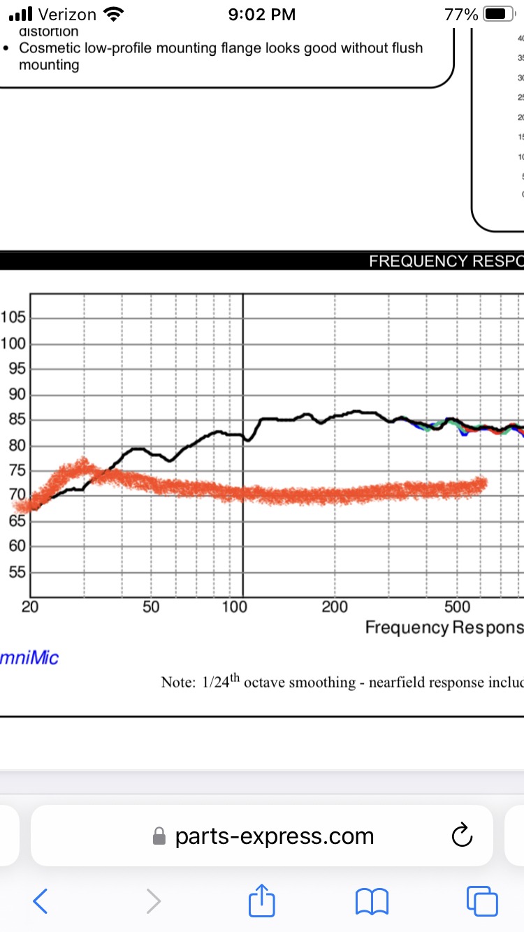

I’m thinking having the 554 pass the baton to the 1.5” around 5-600hz and then letting the tweeter do it’s thing from 5-6khz up. No real reason for the multiple of ten xover ballpark. I’m also going to use a shelf filter on the 554 to bring down the midbass similar to this doctored graph. No offense yall, I just want to clarify what I will be doing with the shelf filter. Because the shelf filter will lower the woofers overall output the overall system spl isn’t expected to be any higher than ~90db absolute maximum.
What if I went with a RS100, which would drop perfectly in this cutout and then mounted the small neo tweeter here playing around 4khz and up? I’m going to be running the 554’s hard to get lower bass and wouldn’t mind having the RS100 take over from ~200hz to remove all midrange from the highly excursion of the 554.
