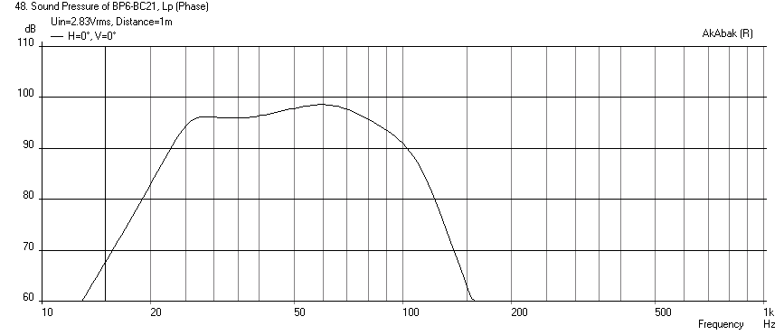

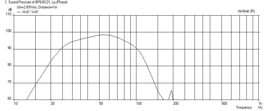

Here is what I came up with that addresses your requirements for:
- a flat to 25 Hz bottom end
- 80 Hz upper end
- a 'bump' at 60 hz (+3 dB in this case)
It will require a 12.72 cubic foot box (10.6 cu ft in front chamber, 2.12 cu ft in rear chamber). I used 6 in diam vents in both chambers. Tune the front chamber for 26 Hz, the rear chamber for 62 Hz. Use a -12dB/oct Butterworth high pass and -48dB/oct Butterworth low pass to limit excursion on low end and HF junk on high end. I used 6 in dia ducts initially but you will need larger ones (like 10 or 12 in dia equivalent or rectangular slots) if you want to keep port velocities smaller at peak SPL when pushing a kW.
Here is SPL vs Freq at 2.83V and 1m (matches the drivers efficiency rating from 25 Hz to 80 Hz):
379956d1383309322-anyone-who-can-model-6th-orders-feel-like-helping-bp6-bc21-freq-1m.png

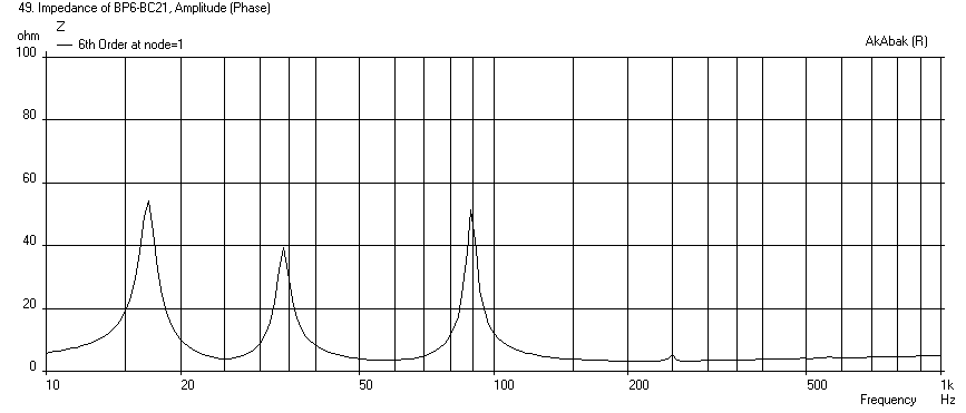

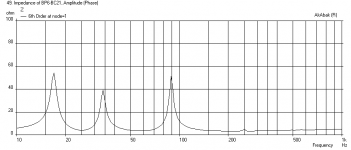

Here is the Impedance:
379957d1383309322-anyone-who-can-model-6th-orders-feel-like-helping-bp6-bc21-imped.png

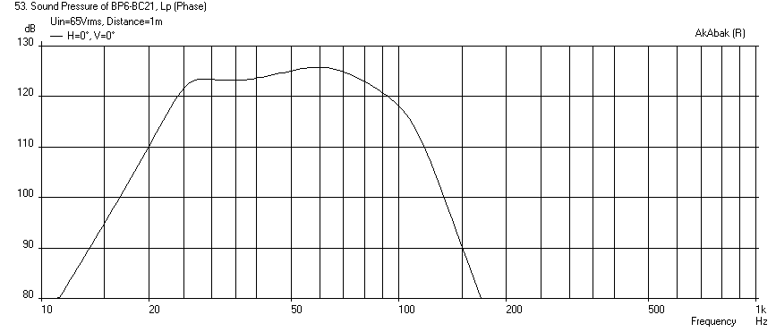

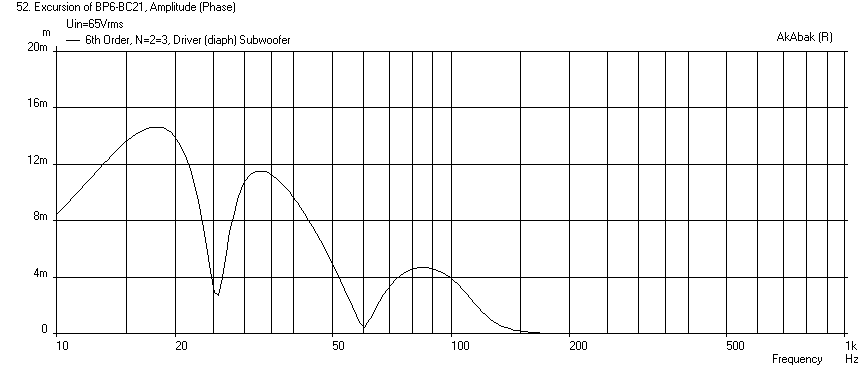

Here is max cone displacement at 65 volts rms:
379958d1383309322-anyone-who-can-model-6th-orders-feel-like-helping-bp6-bc21-max-excursion-67volts.png
Here is corresponding max SPL at 65 volts rms (assuming no power compression effects).
379959d1383309322-anyone-who-can-model-6th-orders-feel-like-helping-bp6-bc21-maxspl-1m.png

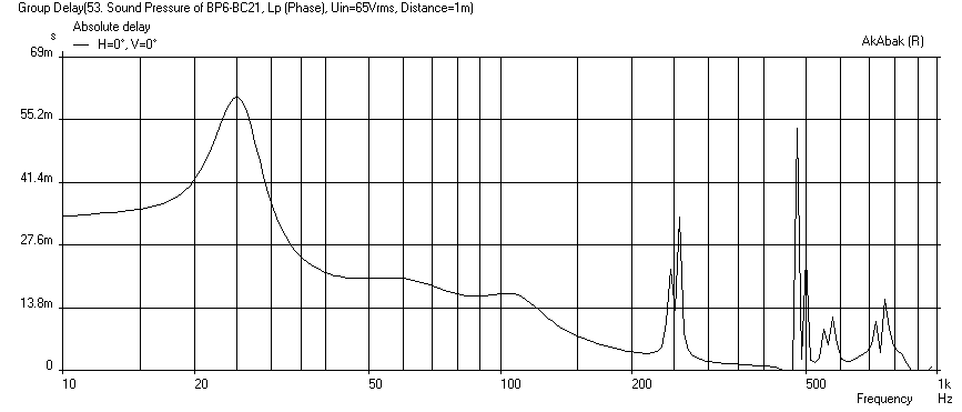

You get some wicked group delay below 40 Hz though - a problem with typical BP designs.

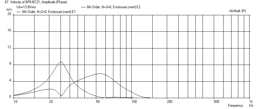

For a car, I guess 13.8 volts is max possible voltage? In that case, use 8 in dia ports and the velocities will be under 10 m/s
379961d1383310376-anyone-who-can-model-6th-orders-feel-like-helping-bp6-bc21-max-velocity.png

Here is the script if you want to play with it.
Code:
| Vented 6th order Bandpass Cabinet
| XRK971
| Nov 1, 2013
Def_Driver  'BC21'
  Sd=1680cm2
  fs=32Hz
  Qms=7.00
  Qes=0.31
  Re=3.4ohm
  Le=1.5mH
  Bl=32.5Tm
  Vas=198L
  Mms=460g
Filter 'HighPass' |Highpass filter - 12dB/oct Butterworth
fo=20Hz vo=1
{b2=1;
a2=1; a1=2*0.707; a0=1; }
Filter 'LowPass' |Lowpass filter - 48dB/oct Butterworth
fo=110Hz vo=1
{b0=1;
a8=1; a7=5.125831; a6=13.137071; a5=21.846151; a4=25.688356; a3=21.846151; a2=13.137071; a1=5.125831; a0=1; }
System '6th Order BP'
  Driver 'Subwoofer'  Def='BC21'
    Node=1=0=2=3
|Vented enclosure at front
Enclosure  'E1'  Node=2
    Vb=300L  Qb/fo=1.0  Lb=70cm
    fb=26Hz  dD=6in
    x=0  y=40cm  z=0
|Vented enclosure at reverse
Enclosure  'E2'  Node=3
    Vb=60L  Qb/fo=1.0  Lb=30cm
    fb=62Hz  dD=6in
    x=0  y=-40cm  z=0

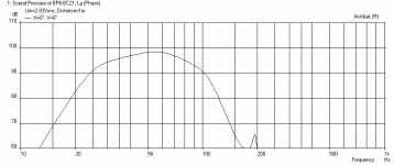

Strange that I get an almost identical curve to xrk971
In WinISD with the rear 6cuft/26Hz, front 2cuft/60Hz.
Going to 63Hz adds a dB or so to the upper bump.
12cuft is too big for a driver with a Vas of 7cuft, and
creates a large lower peak in WinISD with 26Hz tuning.
8cuft tuned to 22Hz also works for the rear in WinISD.
rgds, sreten.
When I plug in Sreten's values, the curve doesn't look as flat as above and efficiency is slightly lower, but could be passable and certainly more compact (the OP said size was not an issue though). Perhaps it is because Akabak is accounting for the internal chamber max dimensions (assumed to be 70 cm for the large and 30 cm for the small) and that the ports are separated by 80 cm and then combine in space to form the response at 1m? But this is my first time doing a BP design so I could just be wrong... I can try simulating it more rigorously with actual rectangular prisms of finite size, ducts placed in finite locations and orientations, etc.

Thanks very much for that. What kind of airspeed am I dealing with if I use a 6inch vent? If I run it across the box it will be around 30inches wide and 6 high. As I mentioned, I will only be using a standard port on the higher tuned side.
My other option is to use aeroports, which can lower the airspeed quite a bit. If I did that I'd use dual aero's for visual purposes, as one large one wouldn't look as nice as 2 smaller ones and should perform similarly. It would probably be 2 6inch aeroports. how would they compare to a simple slot port?
