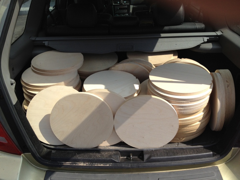

You're building a lot of holes. In 13.25" and 16" diameters. Are you planning to replicate the Grateful Dead's Wall Of Sound?
Actually, the holes are more like 14.25 and 17" and are not in my possession....

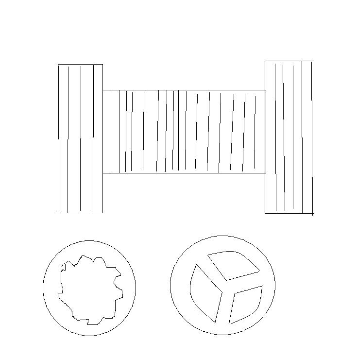

This is the concept I'm working with- wavy cutouts (I know the waves aren't significant at bass wavelengths but this enclosure might find itself used for a midwoofer later on) for full open sections, with alternating shelf-style bracing throughout, not only to brace the enclosure ( which will be absurdly strong anyway) but also to break up any potential resonances in the tube structure.
The Dumbell shape is the best I've come up with but I'm not thrilled with it. Drivers planned are creative sound Trio12 with a 15" passive, and I'll be building a pair. I haven't begun laminating but am cutting out the cores with my scrollsaw, both for the bracing style ones and the more open cross sections. I got the cutouts for free, they're baltic birch. Never would I dream of such a wasteful project otherwise!
Anyone have suggestions about alternate designs, given the type of material I'm limited to?

Perhaps a slow taper through the whole thing, a sub tower for a FAST setup you could put the mid/hi array on top.
The staggered bracing is good tho.

Slow taper would be cool if I had a lot more of the 16"s to trim down, but it would be a lot more work- I'm trying to use the cutouts with sizing as-is, thanks for the suggestion though- I know the 2 sizes is limiting, which is why the dumbell (I'll bevel the edges of the 16" sections) is the frontrunner, though I've thought that a middle section of 16"s might be cool too, break up the long tube look of the middle.

All that said, I'm okay with the material loss (got these free from a pro speaker company, these are their cabinet cutouts), and part of what I'm hoping for here is to have the exposed layer "translam" look, and to use the circular character visually.
