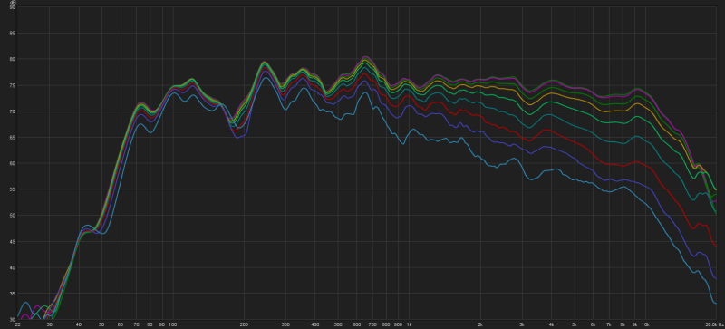

I'm using the STH100 with the Faital HF100 driver and an Eminence Beta 8a, crossed via MiniDSP at 2000 Hz (acoustic crossover point). Attached is a set of response curves from 0 - 90 degrees. No protractor, just turning the enclosure by hand and eye. 1/6 octave smoothing, no gating, this was done in a small room with lots of reflections so less smoothing just shows more hash. EQ was also not optimal at that point, I can do better. Still,I think they mate fairly smoothly.

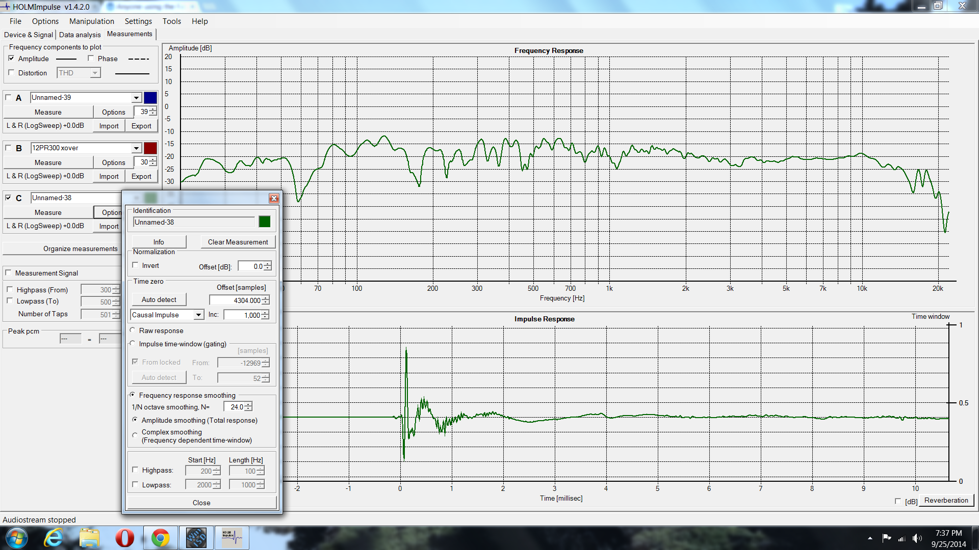

Here's maybe a better look at the FR. This was slightly below the center of the horn (centered between the tweet and mid), at roughly 36 in, mic 35" from floor, in room, 1/24 octave smoothing. Still some room to improve the EQ, I know.

Why not use the impulse gating to measure the HF? Btw, it's super easy to do miniDSP with REW now - just measure the drivers, EQ to flat well past xover, export driver EQs to miniDSP, add the DSP xover filters, use measured inverse null to time align, apply target curve EQ to input, done.

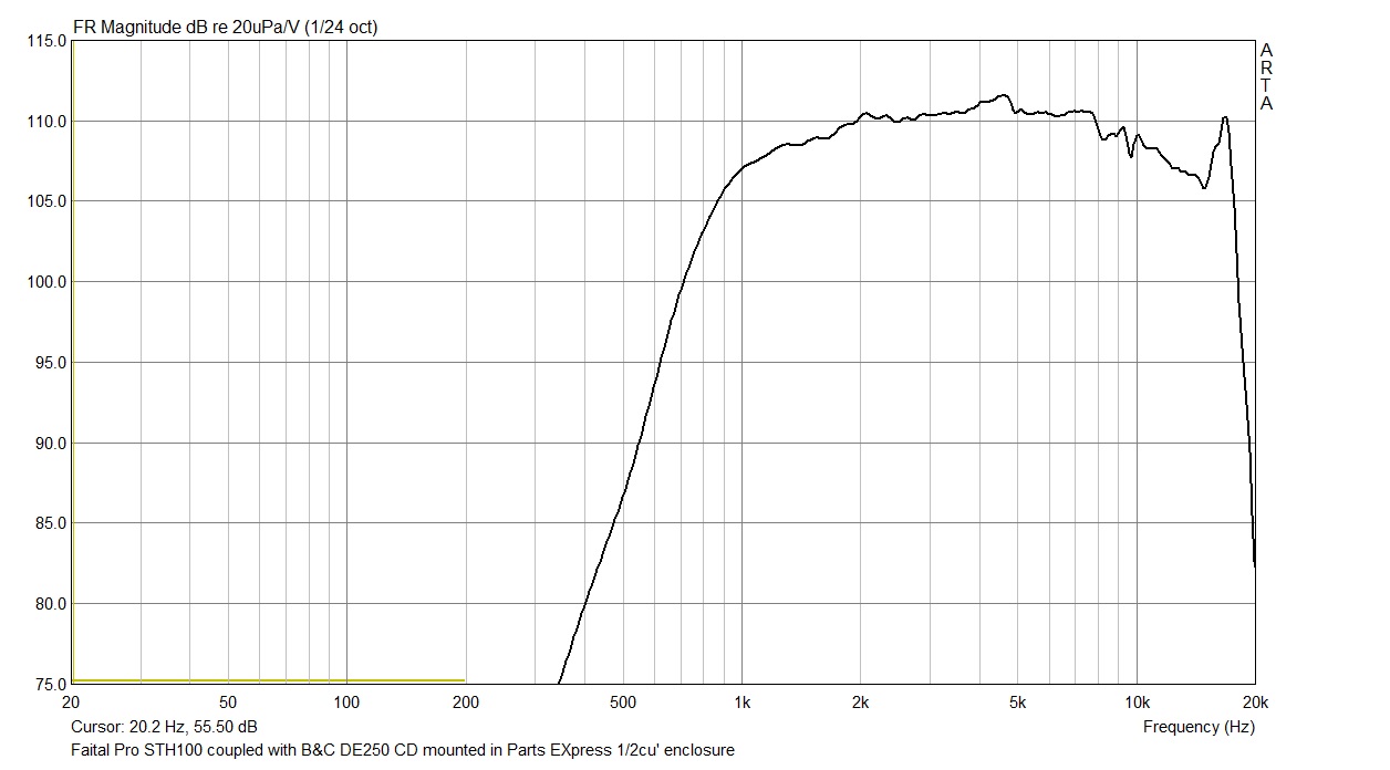

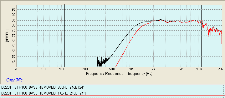

Hi Mayhem13,

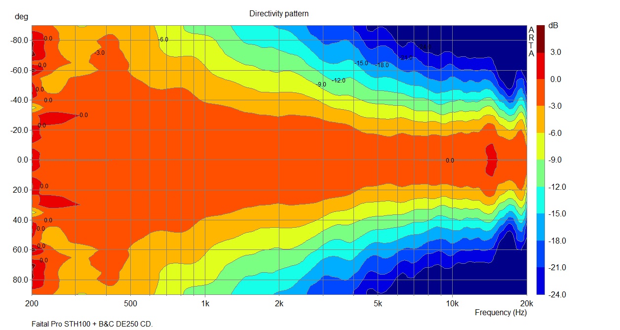

A few months back I purchased several waveguides for use in a 2.1 way loudspeaker system, one of which was the Faital Pro STH100 waveguide.
Attached is my FR measurements and horizontal directivity pattern of the STH100 when coupled with a B&C DE250 CD.
The STH100 had by far the flattest un-equalized FR of all the waveguides tested and as you can see from the directivity pattern, it has a reasonably flat response of about 56 degrees (included angle) over the frequency range of 5KHz to over 15KHz. This opens out to about 90 degrees at 2KHz.
The FR data used 1/24 octave smoothing and the directivity pattern used 1/12 octave smoothing. All measurements were made with the microphone positioned on axis at 1m from the waveguide and gated to provide a quasi-anechoic response.
Peter

@Audio Elite - thanks. Do You have any SPL measurments of this combination? I also thought about HF10AK, but finally decided to go with Beyma CP-380M, becouse i found the test of Faital Pro HF108R, for which the SPL curve was quite different than the one declairde by the manufacturer:

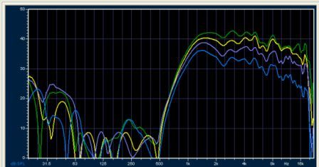

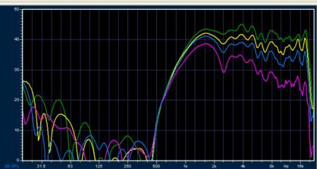

I did find the Pictures after a while.
STH100 has a longer throat so it's harder to make a passive crossover.
Because of CO diffrences I cant really say wich is the better combination, but STH100 has more pronounced highs, and FH170 maybe a little softer.
Regarding CP380, it's a explendid driver.
I use this combination in my backloaded horns with two 8G40 drivers, and have used STH100 in several cabinets, often with CP380 or CD10FE.
