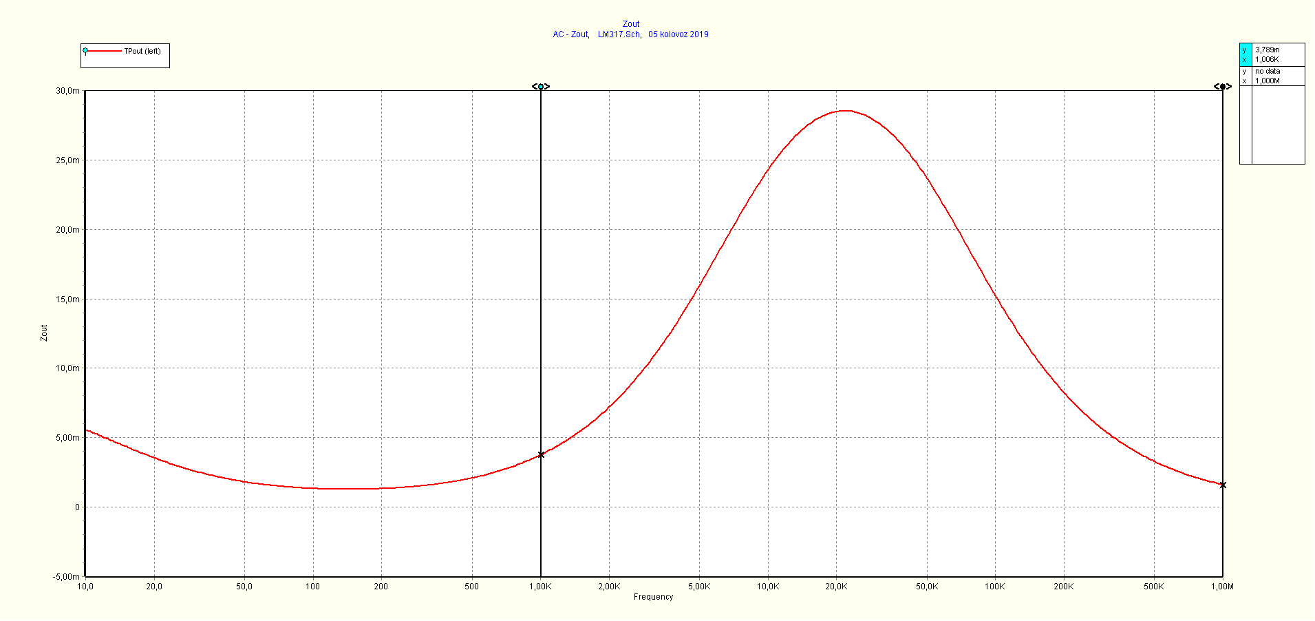

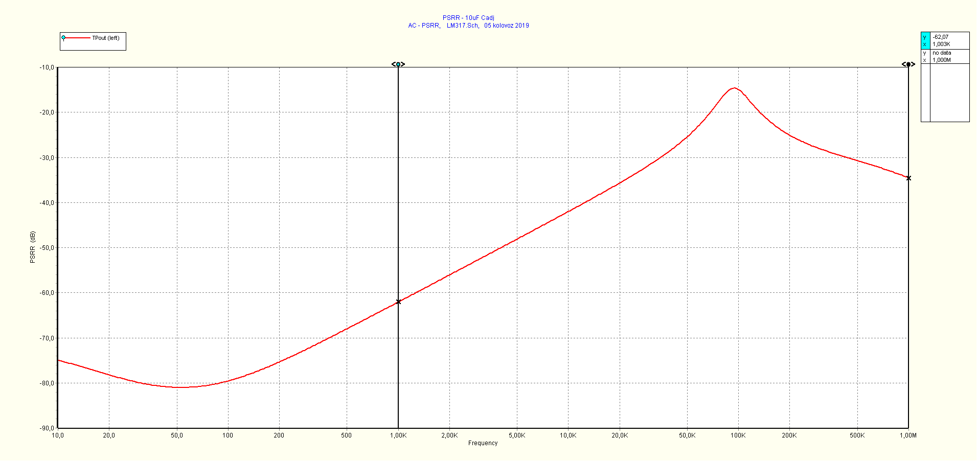

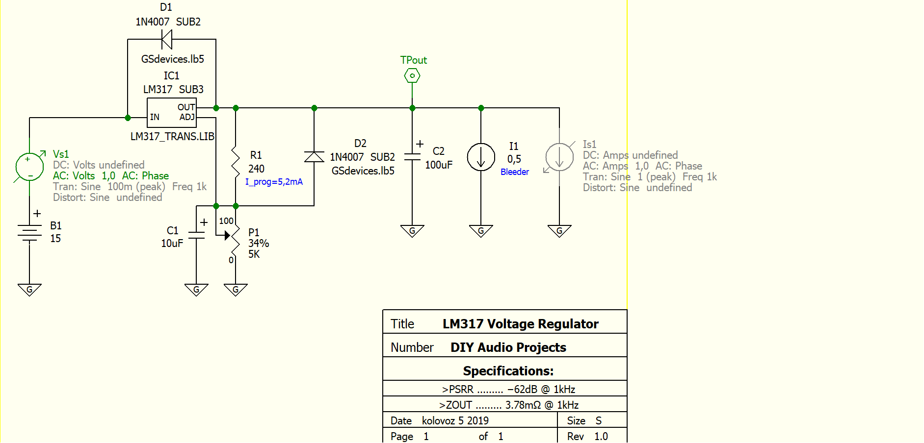

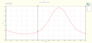

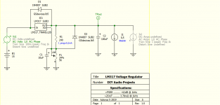

I know that is this old thread, but does someone have license (code) to register professional edition of 5Spice?
As version 2.70 5Spice is no more locked to HW...so you just need Install Code and Registration Code to your name.
I have start to using this software and is very easy and powerfull with winspice..here i try to simulate LM317 PSSR and ZOut and is very accurate.
