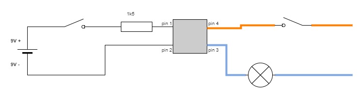

Anyone help me with using this component please ?
I don't have any experience with using solid state components, so I rigged up a brief test circuit (attached). My expectation was that the bulb would only light with the battery in circuit. Actually the bulb is on whether the battery is connected or not and it is clearly flickering. Just to check, I reversed the battery terminals but to no effect.

I've used discrete versions of these. The bulb should not light when the LED is inactive. What is the applied bulb voltage and is it AC or DC ?
You could try a simple LED/Resistor/Battery arrangement on the bulb side as a test.

Be aware of the mosfets off capacitance, especially if it's a low power bulb, like a LED one.... Seems to be missing from the datasheet, but probably some hundred pf....
I have a outdoor lamp with a LED bulb which flicker once in a while when off, the capacitance in the regular switch is enough....
Or you could have a defect mosfet relay, mosfets often short when defect, test it with a multimeter....

UK mains, 240VAC. I'm not used to reading these datasheets, it could easily be me misunderstanding it - it's possible that only the 4119 is both AC and DC capable. I'll try the battery/resistor/LED on the output for the test as suggested thanks.
Once I've proven that it works as expected I plan to use this to switch on a filtered 250VDC supply once a 100VDC bias circuit is up (for a fixed bias tube amp).

Set up a test circuit with battery/resistor/led on both input and output. Each lights when I close the individual circuits with no switch involved. Ready to test the optocoupler.

I'm no device physicist, but I could imagine that a triac simply switches on when it is subjected to an overvoltage peak. That is, your lamp will then flicker, but nothing will get damaged. I'm not sure what would happen to a high-voltage MOSFET.
What kind of bulb did you use? These devices are signal switches (i.e. low current), and they don't like to be overloaded, no matter how briefly. The part has no rating for surge current, so if you tried to switch an incandescent lamp, chances are very high that you blew it up because of the bulb's inrush current.

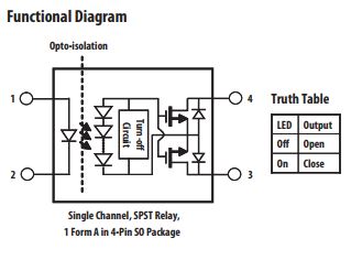

A little background: these "relays" are in fact two anti-series connected mosfets (sources connected together) which receive gate drive voltage from a series string of diodes. This series string of diodes operates in photovoltaic mode (yes, like a mini solar panel) to generate gate drive voltage when the built-in LED is lit. The LED shines through a light conductor onto the PV diode string, this light conductor allows the LED to be placed far enough away from the switched circuit to achieve the desired insulation.
A MOSFET is only turned fully turned on up to a certain current at a given drive voltage, above this current it "lets go" and becomes a current source. In this mode, dissipation (and thus heat production) shoots up and the device is easily damaged. So if you want to switch a load with a MOSFET, and it's not turned on hard enough for the highest current that occurs, it will blow up due to excessive dissipation.
The PV diode string in the "relay" is long enough to drive the MOSFET to turn on up to its rated current, but not any longer, because that would increase the LED drive requirements, the device's size and cost. That's a catch when using these devices.

If you want to go for that, a better solution would be to use a photovoltaic optocoupler, and an external MOSFET which is beefy enough to handle the load and surge. It is basically the same part, but without the built-in switch MOSFET.
