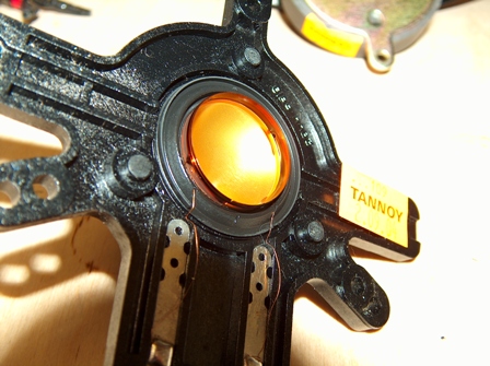

I have a ton of data on 8" coaxial loudspeakers. I can post measurements I have made between the Tannoy and the Beyma. The differences are few but do sound quite different.
1) The Tannoy uses a dome (see attached pic) with a "wave guide" while the beyma uses a ring-radiator.
2) The Beyma diaphram is Aluminium and the Tannoy is Aluminium-Magnesium
3) The Tannoy has a very low compression ratio wave-guide, and the beyma uses a higher compression ratio phase plug.
4) Both cones are polypropylene but the Tannoy is a Curvilinear profile compared to a Straight on the Beyma.
5) Both HF use Ferro-fluid but are different viscosity, the tannoy is using it to dampen the HF more
6) The time offset of the HF to LF is greater in the Beyma.
Now switching to the B&C, Eminence etc, these designs use a back-plate mounted compression driver. These designs require delay compensation for the HF to LF, for sure! Even though I have seen and heard them used in a passive situation the crossover region always suffers.
The design problem is getting a HF acoustic center into the LF acoustic center. In the case of the Tannoy they used a dome and wave guide. The disadvange is the low efficiency and low power handling. If they increase the voil-coil size the tweeter no longer fits inside the pole piece. Beyma decided a ring-radiator was a good alternative because of increase power handling and higher frequency break-up mode, but it moved the acoustic center a little farther back.
Hope this helps - 🙂
Rob
