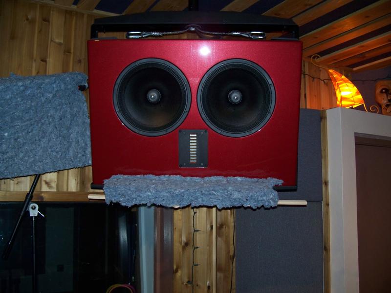

You are better off paying some more $ for Beyma TPL-150. They sound better, offer higher sensitivity and are most likely more durable for PA use. I started with the NeoPro5i for my studio main monitor project, switched to a small waveguide with a very good compression driver and ended up using the TPL-150. It worked out excellent.

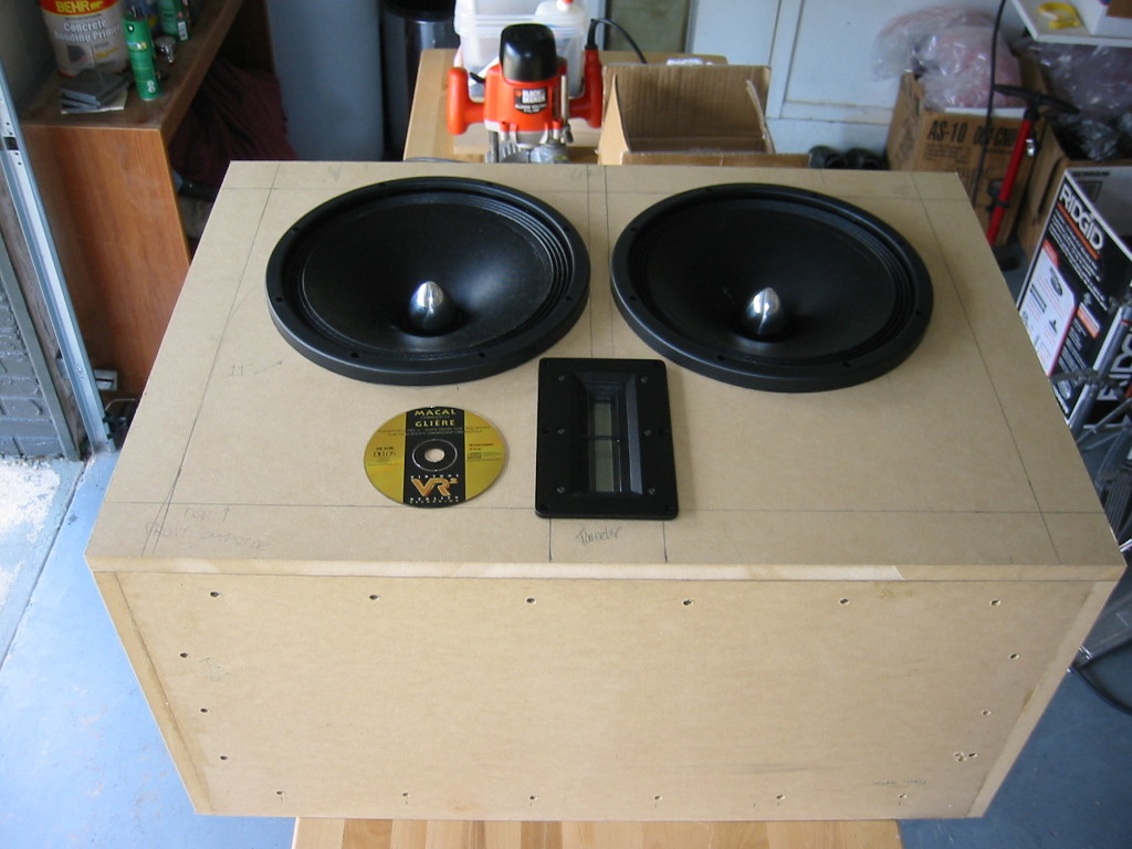

The middle photo, you can see the NeoPro5i in place before we returned it. I would more likely get the TPL-H next time even though it is more money. We are crossong at 1.8KHz, so if you get the horn and keep it above 2KHz, it will just be cruising along.

I used the smaller Neo CD2.0 in my last project, and found that they need to be crossed quite high to get exeptable performance, I ended up with a LR8 @ 3100Hz. This bigger brother can cope with a lower XO point but it wouldn't be my first choice. I never had problems with power handling but my setup is not used for PA. Also they have a very narrow dispersion pattern, which can be a good thing if you are building a line array..
