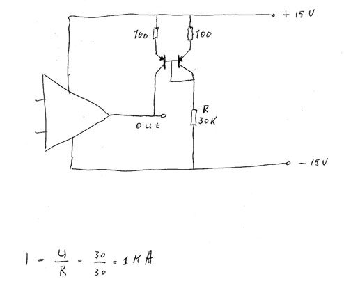

Attach the the diode with the anode to to output of the opamp,
Then the cathode(the one with the ring at it´s side) to pin 4 -Voltage.I used att constant current diode called E202 found at www.elfa.se.
I think that there are others at RS-components.
I found someone called J506 from Vishay that should work.
The article number in my catalog from RS is :290-8041

Or use the constant current source as found in :
http://www.audio.nl/tipseng.html
Any experiences? No need to shop with these parts , that is an advantage.

BTW the scheme shown by someone on the thread (sory forgot his name and can't go back now in the middle of composing this post, but many thanks to him) related to DX7711 shows a similar
arrangement for the output as has the DX706 (4 OPamps!) which I have replaced with AD827. I mention this because in the near future I would like to have a balanced output.
Have three PS, one exclusive for the clock, well enough bla..bla..bla since my fellow thread readers are much bored with somthing somewhat outtraked from the original thread 😱 😀
P.S. Yea was Klass, thanks Klass nice to retrive this part of the circuit for us, I did needed it very much 🙂
No problom supplying the schematic 😉
Update about my dx7711. I tried to put the opamps in class A with a fixed resitor (10K) to the positive voltage rail. Also put some adhesive copper tape connected to ground on the DAC.
This cleared thing up a bit.Jus a bit smoother. Not trealy impressing. I'am now playing with a brand new Philips 963SA DVD/SACD player with CD upsampling to 192kHz. Very interesting for about 420 Euro in Netherlands.
