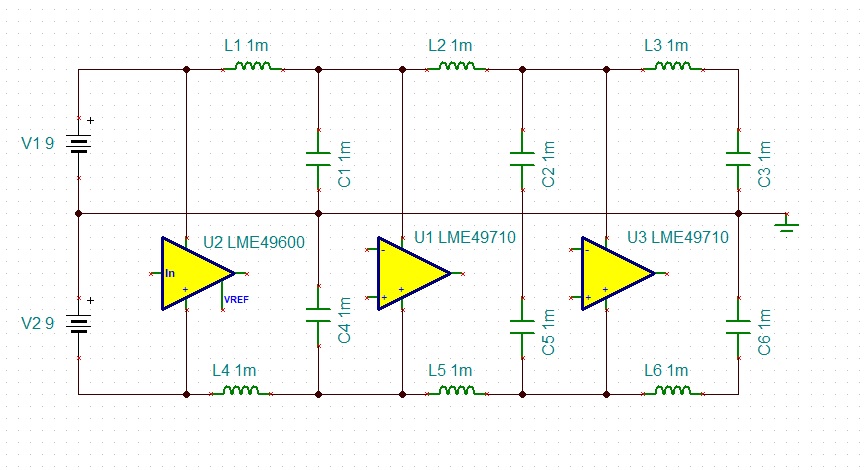

Here's the schematic, its not that complicated - you'll normally need two of these, one for each rail.
On the left that's your input (shown as a voltage source) which is the LME supply, the output to the opamp is to the right.

In my design, I planned to use two LME49710 and LME49600/BUF634 (For one channel). One LME49710 serve as voltage gain and the other one serve as DC servo, so I need to separate each one with LC filter as the schematic attached??

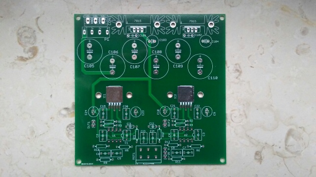

info pcb
if interest , i have some of this pcb to buid a lm49600 headamp.
the schematic is take from original datasheet and i have add a dual voltage psu on board with 7815 and 7915.
pcb is 100x100 mm. , double layer with a stereo pot in like 2x50kohm alps.
No, you'll only need two filters (so two Ls, two Cs) unless you're adopting separate L,R channel construction (when you'll need four). Both the LME49710 on a single channel can be powered on the same rails as their outputs are barely loaded.
On the schematic you've shown you only need L1 and L4 and C1,C4. L2,L5,L3,L6 are replaced with wires and C2,C3,C5,C6 are omitted.
