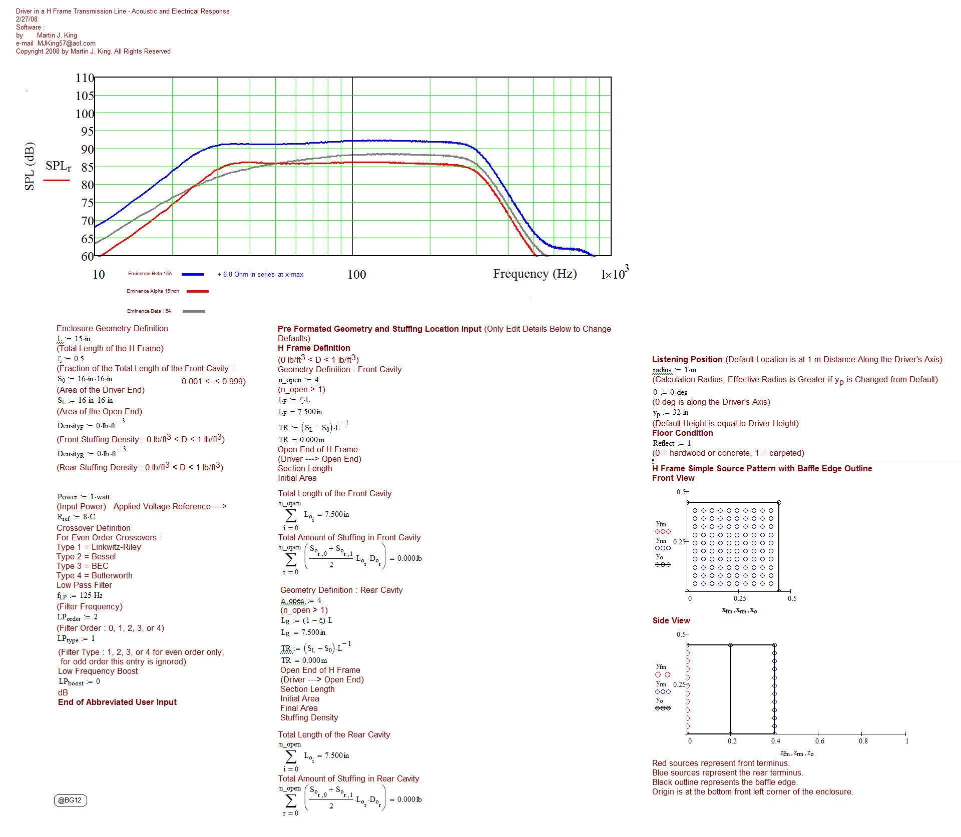

To equate the Beta driver FR-wise in a H-Frame a ~6,8 Ohm driver must be added to achieve a similar response.
What is the ~6,8 ohm driver? A 6.8 ohm resistor? I'm confused.
I am more interested getting a woofer that is defined than a few extra Hz... a dozen extra Hz, I can be persuaded 🙂
or could be a matter of a little bass, or no bass at all, more than just a few hz 😉
anyway, defined bass will have close relation to crossover phase with other drivers in your speaker
If you add a 6.8Ohm power resistor in series with the Beta Driver then the Qts= 0.585 moves up to Qts= 1.126 but at an expense of a large power loss as a undesired consequence...

That would improve the design,Yes more power but you cannot arrive at an higher SPL than I showed in the picture. No short commings..

So in this case I lose much ability in hitting higher SPL? Do I get more SPL if I use active EQ to change response instead? Or do you mean the SPL is my max sensitivity at 1watt?

A picture is IMO needed:
Note: To equate the Beta driver FR-wise in a H-Frame a ~6,8 Ohm driver must be added to achieve a similar response.
b🙂
Of course,by showing:
1. First the two drivers in the plot are (Repeating the context in the picture )at 1 W input power,but when making the Beta driver having a similar response to the Alpha:
2. You have to EQ or passively add an resistor that as a consequence will affect max SPL(SPL at xmax), as shown in the picture.
Both ways works in a similar way when it comes to SPL loss (i.e. at mid-band SPL): Using an EQ will not improve max.available SPL compared with when adding a
passive resistor.
b 🙂
I am still confused with the graph... In the blue line, this is Beta at xmax... The driver cannot play louder than that level at any volume? In that case, the Alpha can go higher in max SPL than the blue line Beta?
