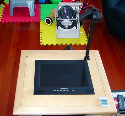

here you can pick them up here for a little over $700. there is no way your
going to find an inexpensive uxga 1600x1200 beamer. they tend to run many
thousands of dollars. I already have fresnel lenses that will cover the
complete screen. size doesn't matter that much to me. i have been building
15" lcd in to coffee tables, end tables, etc. the 20" Dell would fit into
my 15" table projector no problem at all.
actually the price is quite cheap compared to the alternatives. i have a
couple sgi 1600's that i just started to make into a projector today.
they are 1600x1024 wide 17". i'm mounting them in solid hardwood
chests, so they will look better in the living room.

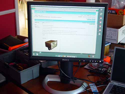

picture of my dell monitor

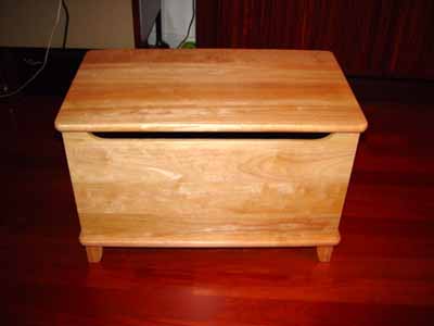

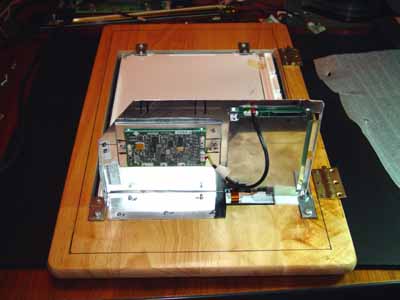

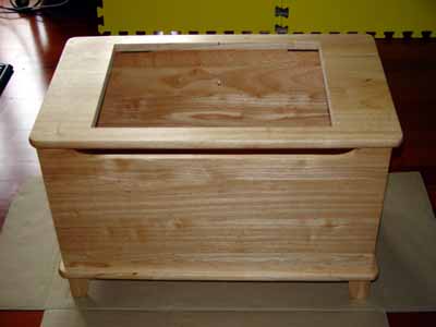

last pic. as far as i got tonight on this project. mounted the
17" lcd as the associated boards.
anyhow, would be fun to try a 20" monitor. let me know
if you can dig up any info. thanks, tony
