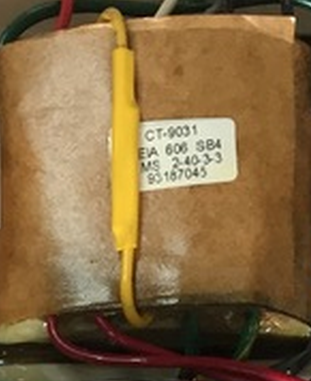

Anyone recognize or know how to determine who the manufacturer of this HV tube power transformer is from this label?
It was in an off name amp a buddy had and I wanted to reverse engineer it and figure out the voltages and such but he sold it before I got the chance. I really liked the look of it. This pic is all I have left to go by.
In case the picture gets blurry on here, it reads:
CT-9031
EIA 606 SB4
MS 2-40-3-3
93187045
Thanks for any insight you might have.

I do not recognize it, but do you happen to know what sort of equipment it was originally used in? Sometimes I have figured out certain transformers by digging into the specs on the equipment itself.
606 is the EIA code for Schumacher Transformer - perhaps they would have records of it if it's not too old. Do you have an idea of the manufacture date?
Tom got it already; but for future puzzles:
> EIA 606
EIA issued maker-codes. Problem is that EIA 606 is also a wiring spec. "EIA 606 transformer" finds links that look authoritative.
"The "606" EIA code is for Woodward-Schumacher Electric. They are still in business as Schumacher Corp."
