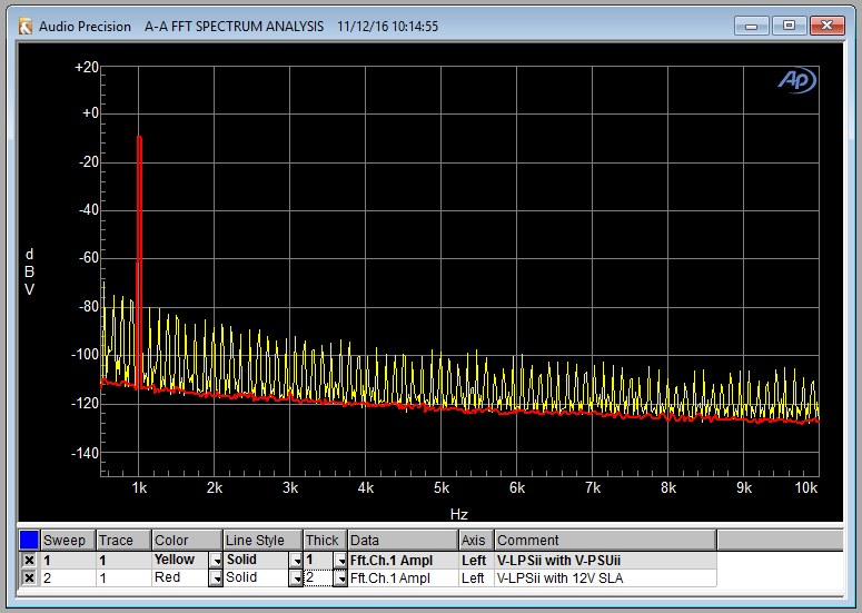

The Musical Fidelity power supply must be ditched.

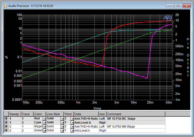

The VLPS also has a 7809 regulator and a diode to prevent wrong way insertion -- this is going to hurt overload margin as you can only swing a little over 2V output. At a minimum you would like 20dB overload margin vis a vis 5mV. With gain of ~42dB @1kHz the VLPs should be able to swing an impossible 6.2V.

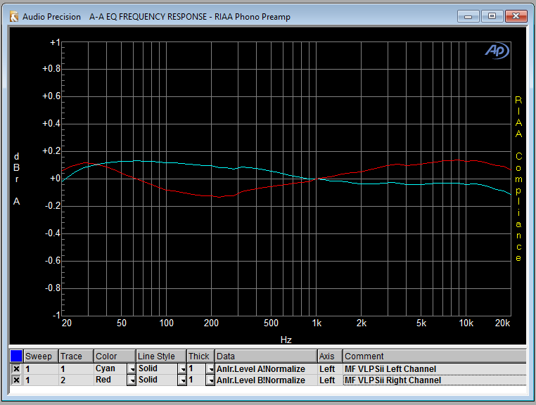

RIAA compliance is excellent.
Lastly, don't replace the NE5534. It's an excellent performer.

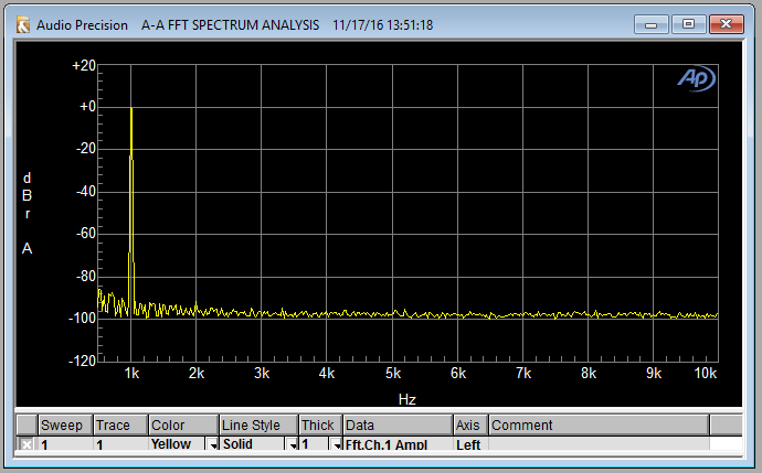

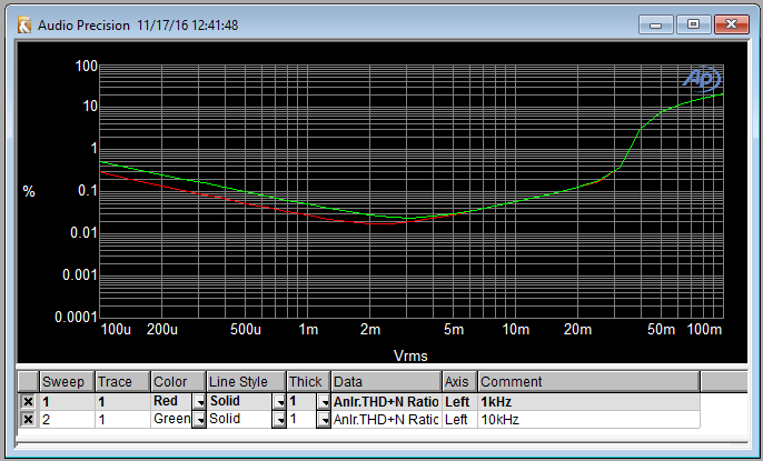

Some pictures of the MC pre-pre
THD with 500uV signal, gain is 16dB so the reference, dBrA is 3.2mV.
And the pre-pre can probably take over 4mV input before it runs into trouble. Should be able to handle most high output MC carts.
