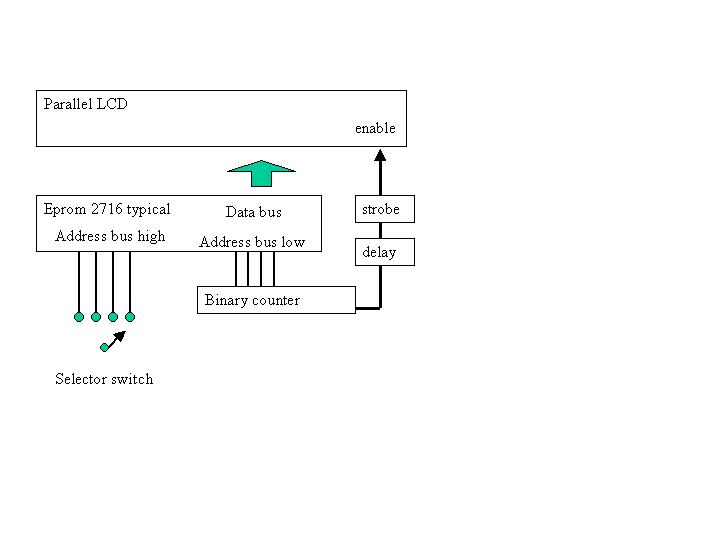

Hello everyone, has anyone constructed a LCD display for a preamp? It should just read "input1" when that is selected, or "input2" when no. 2 is selected and so on. Pretty simple right? Not.
I looked into this, and from what I could figure out you can get a serial programmable LCD module and program it pretty easily from your computer to say something on startup with the free software.
But using it detached from your computer to display "input1" or "input2" is another matter, to do that you need a controller chip with some inputs and outputs. And to program the controller chip you need to write source code in "basicX" or something else. And to write the source code you need a development kit. This all costs over $100. So before I go out and try this, I want to know if anyone has any recommendations on how to create a LCD display for a preamp.

the MC you could order as free sample, a programmer for a PIC16Fxxx is possible to build for 5$ or so. Software you need is free. I made something like that with a Pic16F876 and a LCD with HD44100 (7€) and try now to connect a PGA2310 (.... free sample) for volume controll. In case you want to go this way mail me. For the extended high end version for those with enough money look here:

you want to do this with a pic processor and a parallel LCD
cuiz they are both much cheaper.
search for lcd and pic and display on the web, there will be
some projects almost exactly what you want
this is trivial for a pic programmer -harvardian?

this one: http://www.sprut.de/electronic/pic/projekte/brenner5/index.htm
but there are many similar to this in the net and also plans for a clone of the in circuit programmer ICD.
