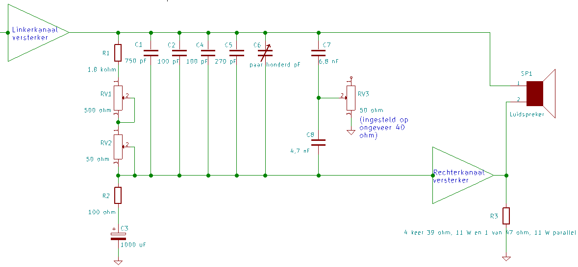

Hi All
When you want to build a circuit and be able to play with the Resistance of a Resistor, you buy an Adjustable Resistor, or in 1 word - Potentiometer.
There are many kinds, in many sizes, and in many stores.
Adjustable Capacitors on the other hand, I can't seem to find.
I would like to buy some, in order to be able to play with its value when it's connected to a circuit, and then see the effect on the result.
Anyone knows where can I buy such?
Thank you very much

You mean a Variable Capacitor. They exist, but the available values are way too small be be of any use in the audio electronics realm. There are, or at least used to be capacitor substitution switch boxes, which had a rotary switch and a bunch of different value caps, in a box with alligator leads. That's something you could build yourself...you know, DIY! 😉

Trimmer capacitors are still available, but usually have values of a few dozen picofarads or less, for example:
https://nl.farnell.com/w/search?capacitance-max=50pf&st=variable capacitor
Mouser has some trimmer types with an unusually large capacitance:
Find Electronic Components | Mouser Europe
Variable capacitors used to be available up to a few hundreds of picofarads. This shop in the Hague is specialized in antique electronics, maybe they still have them:
Radio Twenthe – on- en offline electronica winkel, verzending na vooruitbetaling
If you need more capacitance, you could combine a switchable capacitor bank with a variable or trimmer capacitor for fine tuning.

Thank you very much..
I will try to email the store on the second link..
(altho it seems that as you 2 both showed, there's mostlikely not going to be any bigger capacitance)
OK, I guess for audio this is not really possible.
I might build a small switch box with several capacitors and a code switch, and use it carefully (turning off the circuit before changing)..

Nice ideas, thank you.You my also use DIP switches.
I wonder why bigger ones are not manufactured..
3nF is about the largest you get off the shelf it seems, the size of a shoebox and rated for kilovolt or so.
If you want more capacitance you've have to get it made, and it would be huge and probably quite microphonic if you go for small plate separations. The hum pick up could be quite a serious issue too with all that surface area
Variable capacitors are made for RF and RF power applications. Often they use vacuum variable caps for high power since air is all sparky and dust collecting, and you don't want your transmitter taken out by a vaporizing insect.
Switched capacitance is the way to go with audio, definitely!

You can use the Miller effect: make an inverting amplifier with a gain of -A and connect the capacitor with value C between input and output, and you will see a capacitance of (1 + A)C at the input. The inverting amplifier could be made with two op-amps, one that acts as a buffer and one connected as the usual op-amp inverting amplifier. The trick is to keep it stable with two op-amps in the loop and to keep them from clipping.
In principle, you could use a fixed capacitor and tune the gain -A with a variable resistor.
As an alternative, you could make a non-inverting amplifier with a gain adjustable between 0 and 1 and bootstrap out a part of the capacitance. Basically the same trick but with the opposite sign of the gain, leading to a reduction rather than an increase of the capacitance.
