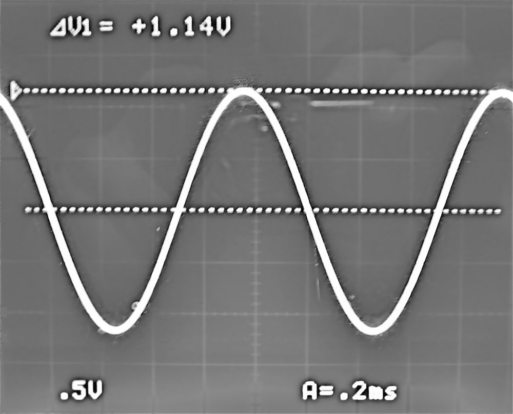

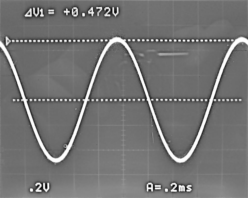

Well, I've measured the iPod Classic's headphone out and the iPod Dock's line out on a scope.
The picture shows the iPod Classic in an Apple iPod Dock, both in front of the scope used.

Turns out the level via iPod Classic's headphone out into a high impedance load is Up ≈ 0.47 Vp (peak) with my European model (probably output level limited due to EU regulations).
This means Urms ≈ 0.332 Vrms and thus Lu ≈ -7.3 dBu.

The level via Apple's iPod Dock's line out into a high impedance load is Up ≈ 1.14 Vp (peak) with the Dock powered by the iPod (similar, but not identical to a direct out condition).
This means Urms ≈ 0.8 Vrms and thus Lu ≈ -0.3 dBu.
