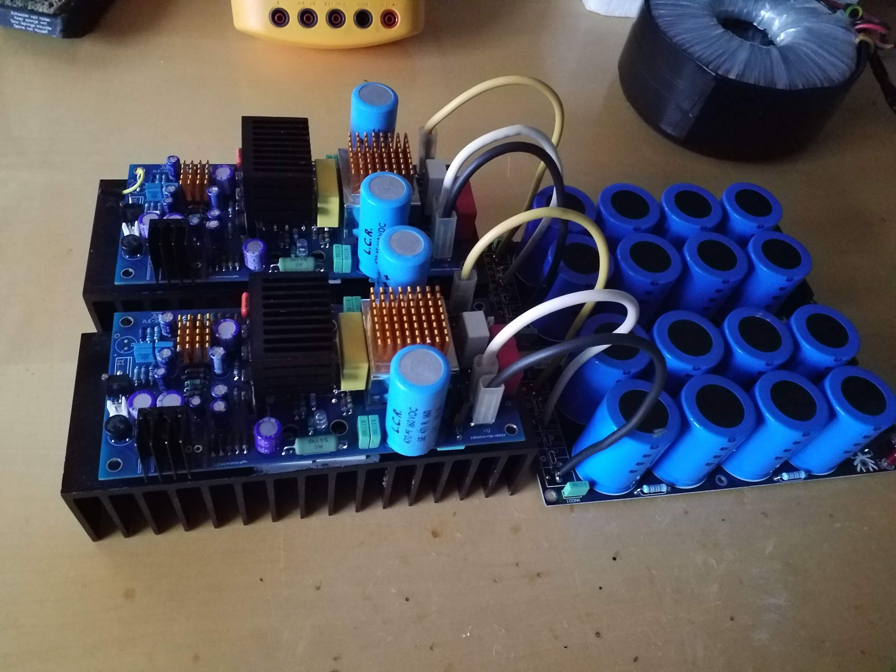

I found this while quickly looking through a sellers items on ebay:
2x500W amp with onboard suppy
Anyone know what it is? Is it any good?

It looks like a iraud 7 amp, with smps and speaker protection, I'm sure it can do the claimed watts, but distortion will likely be 5% or more at those levels,
Who, their right mind, cares about power at those distortion-levels?
Apart from looking good in the listing that is.
I was mainly curious. I have two L20D boards with both SMPS and a linear supply to choose from.
Haven't gotten around to testing the amp though.
Your ld20 boards are similar, the prospect has an added input buffer, lf356 I believe, for inverting to bridge mode.
From what I can see there are transistors between the chip and outputs so these might have extra drive. I also see two opamps so it might have in input buffer too. These could be better than evaluation board types.
