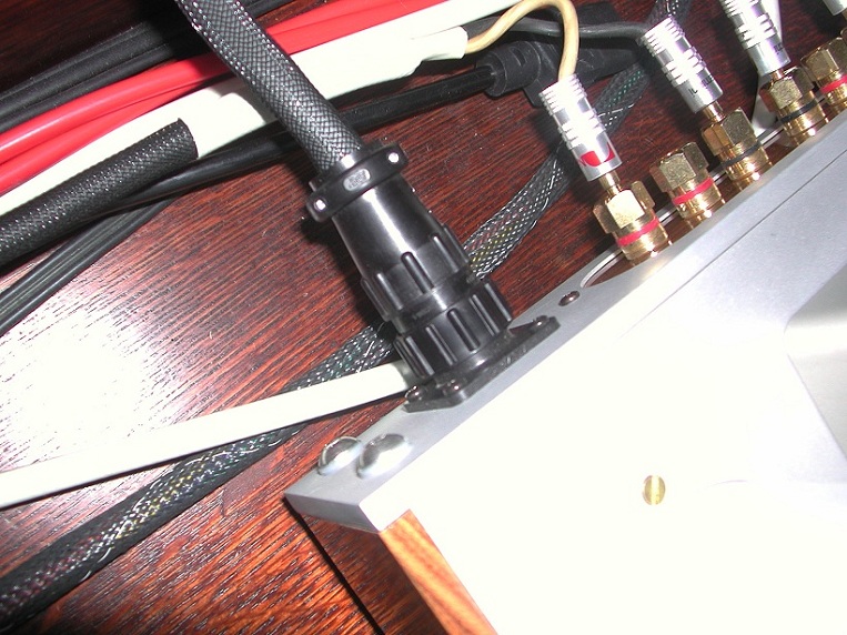

+1 on the Amp CPC series. The series 1 CPC connectors are rated for 600V (AC or DC) and 13 amps. Affordable, and easy to use. I'm using a 9 pin on my Tubelab SE running up to 400V B+ with all of the pins used. Been using it for months without issues. They have a variety of shell sizes, std and reverse sex, gold contacts, etc.
+2 on the CPC series. I've used these between amps and remote power supplies with great success. At first I thought there should be no problem running parallel wires for more current, but I can see that if one connection started to go high resistance the situation is unstable and soon you might have a single wire handling all the current. Still, if the current was within the limits of a single line, paralleling should lower resistance and work reasonably well. I wouldn't do it if the total current exceeded the limits for one line.
cinch's jones series seems to cite 250v AC max for there plugs so i think i'd be afraid of flashover
I built my 845SE using a Cinch Jones connector on the umbilical between the amp and power supply. The connector carries the HV which is 1100 volts at 200+ mA DC, the driver B+ which is 500 volts and all the filament and low voltages. The amp has been in south Florida humidity for 5+ years with no issue. The pins adjacent to the HV pin are not used.
aha, so there 250v rating is quite modest if you take care to isolate adjacent pins. then thats indeed a optionI built my 845SE using a Cinch Jones connector on the umbilical between the amp and power supply. The connector carries the HV which is 1100 volts at 200+ mA DC, the driver B+ which is 500 volts and all the filament and low voltages. The amp has been in south Florida humidity for 5+ years with no issue. The pins adjacent to the HV pin are not used.
