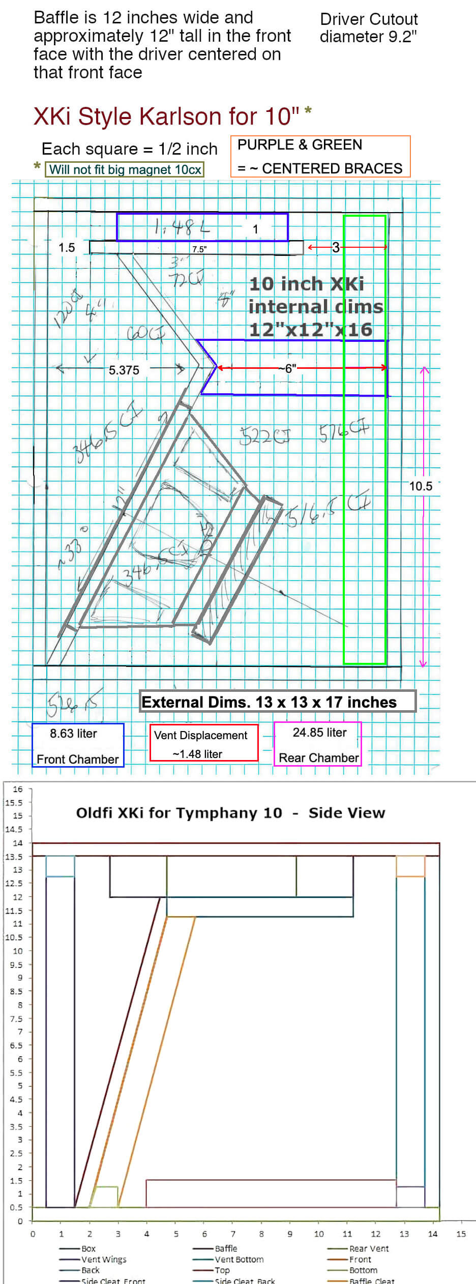

anyone here care to help design a cool "K10" ?

A rear chamber for a K10 is probably less than 1 cubic foot. Front chanmber shape, aspect, venting details are some of the variables.
A high tuned "Karlsonator" might be interesting. A smoothing stub can be added to the front chamber of K-type, but probably I'd just want to retain some "hit".
Oldfi designed an XKi for my Tymphany10 - if I could get someone to cut onc for a reasonable price then that might work with the clunky 10cx and other 10cx.
I do like the idea or a squat box as my "Tiny Ten" sketch as have not tried one.
fwiw I think there's more front volume in the "Tiny Ten" than Bruce's XKi - but the latter might play smoother (?)

My smaller "K18" was made like the 2nd K12 and with a baffle lay back of about 23 degrees from vertical. It had a pretty smooth response.
