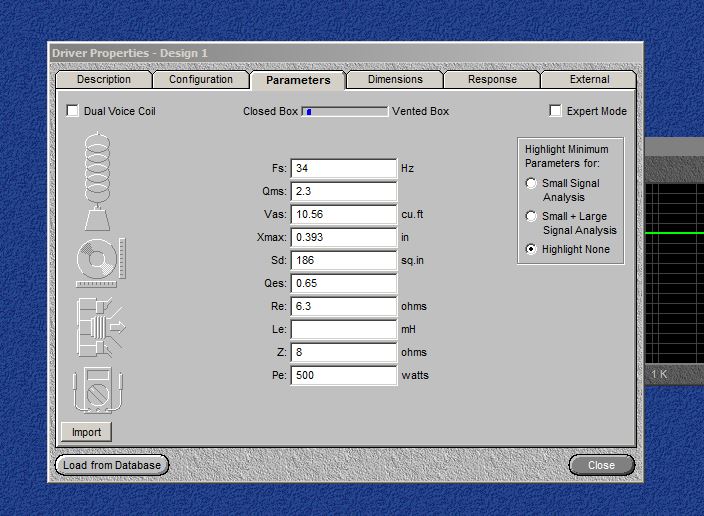

Thanks for the compliment. It is for a part set up,, house party dj, guy. I saw those parameters on the seismic site,, what is 1.2k square centimeters? Are you hose parameters complete enough to put into bass box? I feel like I was missing a couple when I tried,,,can't remember which one,,, something using mh.
sd and le are what I'm missing I see. xmax as well. Is it wise to leave these out when using a program such as bassbox?
Don't worry about Le, has no effect on figuring out sub box designs.
Sd = 1.2k cm2 translated into how most would state it - 1200 cm^2
Regarding Xmax, that's the great unknown - if it's like the other cheap 18" Pyle, probably around 10mm one way.

I am gonna build an enclosure as close to what the original dimensions were. Entered everything into bass box and doesn't model well at all (imo) for a subwoofer. I'll be loud though.
I just dialed in the numbers and recieved -3 dB @ 33 Hz. The TS Parameters tells you it requires a good sized box if you are aiming for a flat response. It is not unusual for manufactures to use a small box in order to get a bump at certain frequencies. Observe what the VAS says. A woofer offering a VAS of 299 litres is not going to give you a flat response in a box smaller than 299 litres.

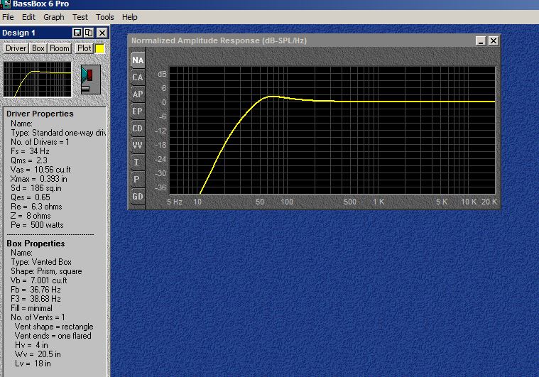

Thanks for that pro audio insight. I was actually thinking about that,,where was this gonna be playing at. I came up with a newer vented plan that I think is going to work well for the guy that wants it built. His budget is pretty much nothing and after much sketch time, I will be able to do it with one sheet of mdf (bracing from some scrap I have). Maybe not the very best that can be done,, but maybe the best that I can do with what I'm working with.
I see your chart has a cabinet gain of +3 dB from 60 – 80 Hz. A lot of commercial bins tend to offer a boost in that region to attain what many consider punchy bass. The whole idea of making your own design from scratch is attaining what you want (or in your case the client's needs) than what someone else wanted.
You have Bass Box Pro, which can give you precision measurements to get the wood cut at the lumber mill. If that box is going to be in heavy transit you definitely want to use wood and stay away from MDF.
Thank you to everyone who chimed in and offered advice. In the end the guy just wants bare bones, cheap as possible box. I have already got it built. 23"x 28x 22" box,,,slot port,,1 sheet of mdf was all i had to work with. I'm sure it will sound great to him. oh well. Still fun to build something.
