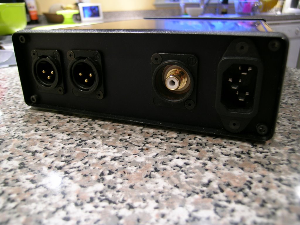

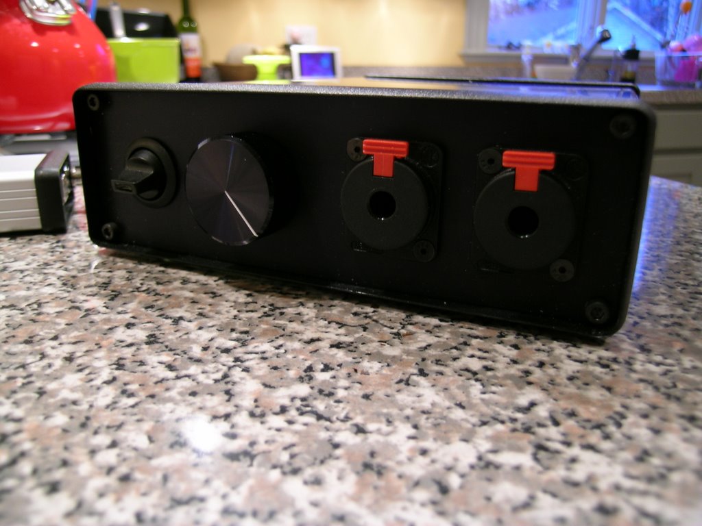

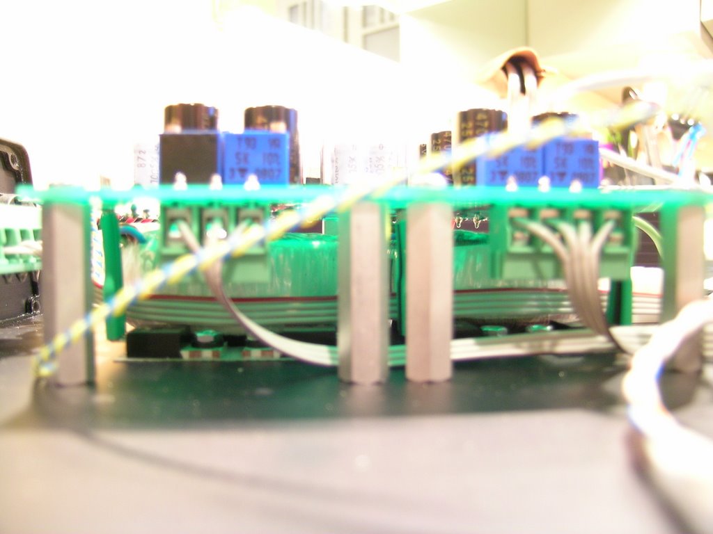

Okay, this build was done in a Hammond 1455 case a long time ago (~2009). I think it was the 8"x6"x2" version.

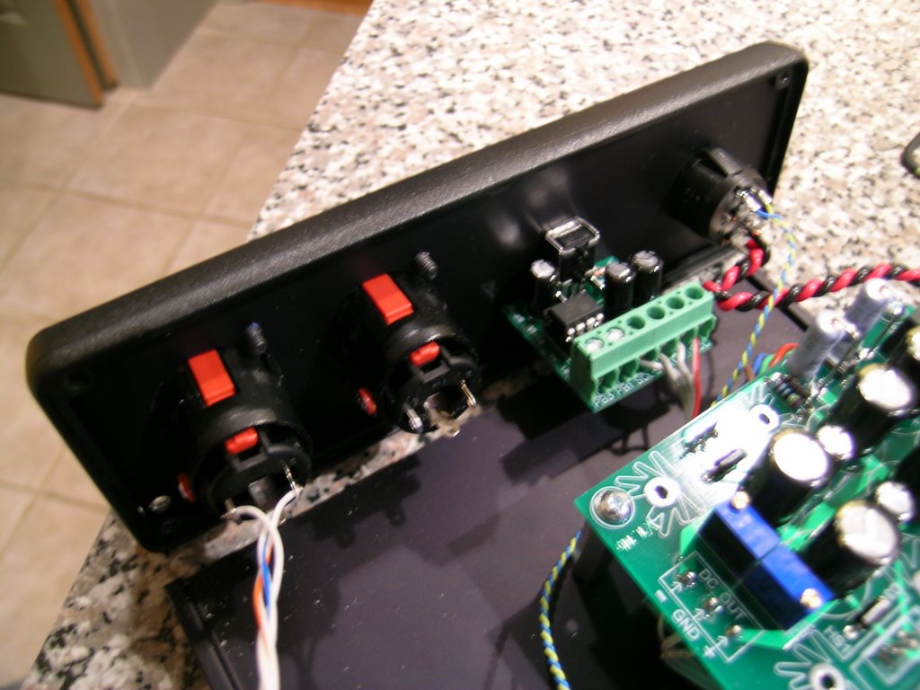

The DAC is a Buffalo (first version) and original IVY. A single S/PDIF input is on the rear panel, along with balanced outputs, both using Neutrik connectors. Two headphone jacks are on the front panel; currently only one is wired to the SE outputs, but the idea was to eventually wired them for balanced headphone use.

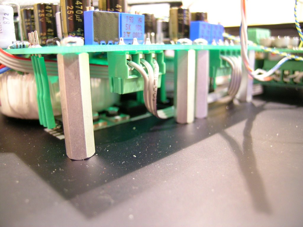

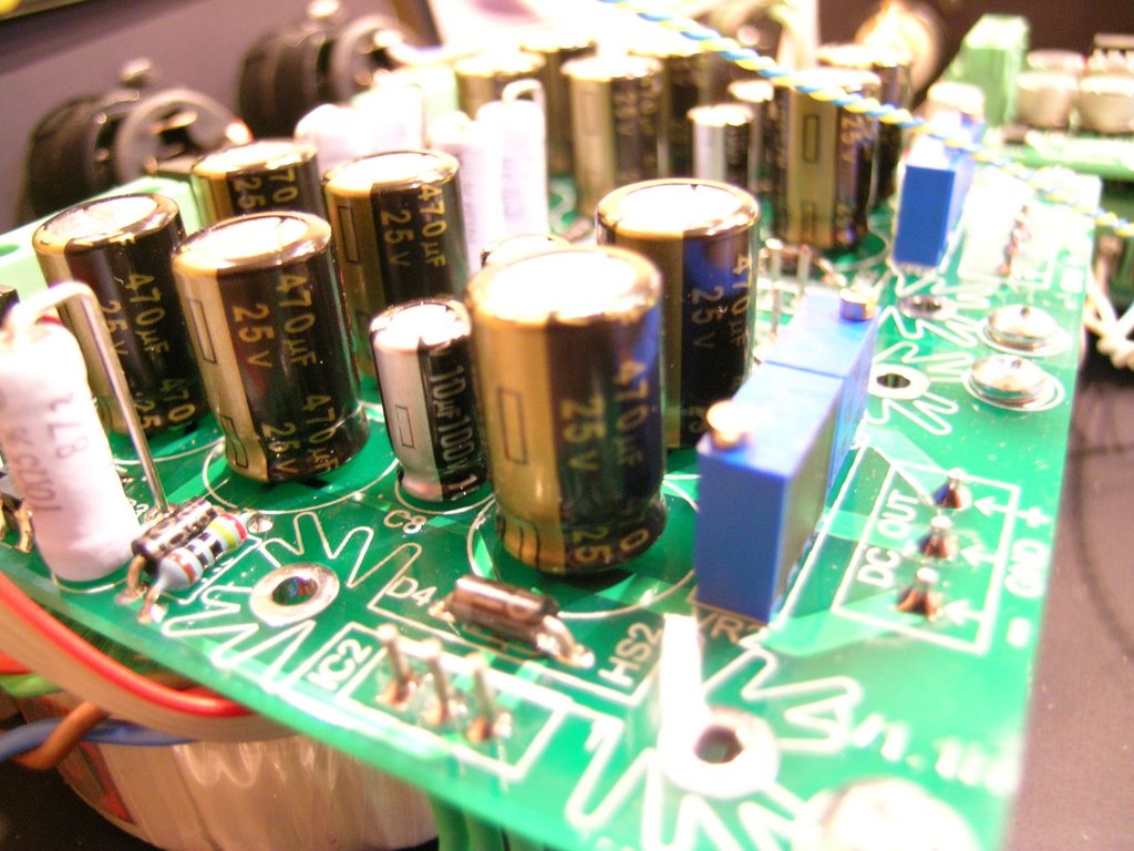

Power supplies are lightly modified LCDPS and LCBPS. I had to use lower-voltage EL caps to make it fit height-wise. Transformers are Amveco 62000-series, mounted below the power supply boards. I case-mounted the LM317/337 regulators and extended their pins to reach the boards.
The unit is mains-powered, but lacks a fuse, which is a big no-no. I never bothered fixing it because I do not actually use this DAC. I used one of the power supply standoffs as a grounding point for mains earth, though the mounting holes are isolated from the supply, so this was just convenient.
The power switch is a Mountain switch with integrated LED. I actually removed the stock LED, put in my own two-pin bi-color LED, then refilled the switch void with clear epoxy. I wired the LED to the LOCK and MUTE LED+ pads on the DAC. Since the DAC has pull-downs for the LED, there was a ground available when the LEDs were off. Basically, the switch is RED when muted, and GREEN when locked.
There is also a Volumite on the front panel for volume control.

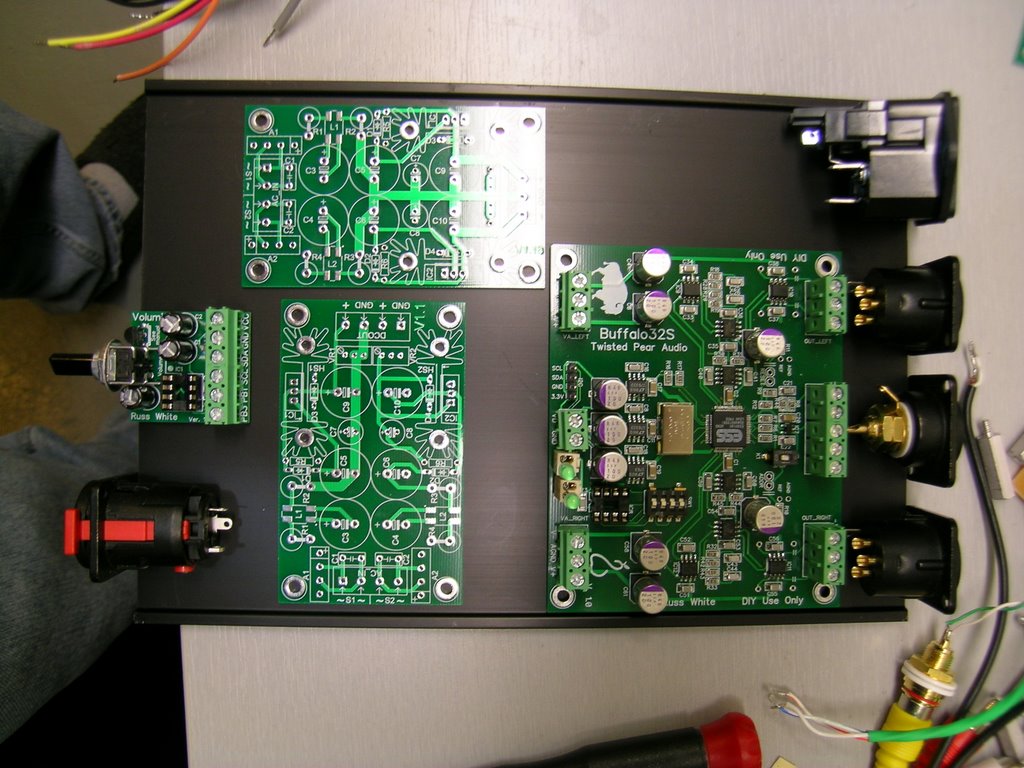

Here is a test layout in the same case with the Buffalo-32S, which was about the same size as the current IVY/Legato. There would actualy be a little more space since the Volumite would be replaced by a simple panel-mount pot for volume with the current generation DAC.
Note this one has a fuse 🙂.
It was never built, however...
Thanks Brian... This gives me a ton to work with. That was the size I was looking to make it. Interestingly enough I have a buffalo 32S and a Placid PS so I can probably make all that fit and mount the transformers underneath
Can I get away with 25 VA 9+9 VAC for the dac stage power transformer and 35 VA 15+15 VAC for the output stage power transformer on the Buffalo 32S ?
It will depend somewhat on the input impedance of what you are driving, but it should work fine in most circumstances.
