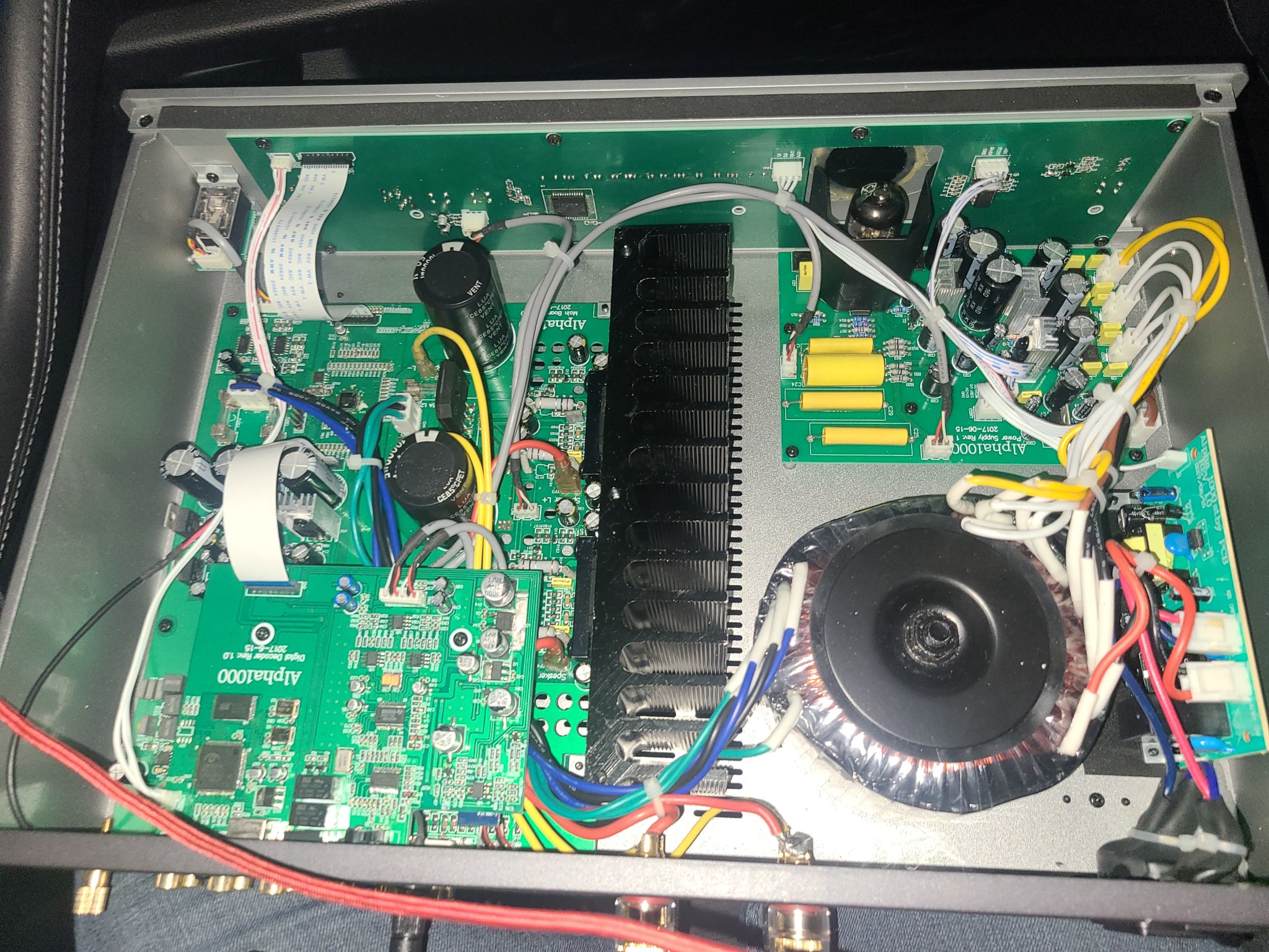

Anyways, here's a pic of the inside of the amp I bought. It's called the Alpha 1000. I'm not too familiar with amps and such, but it seems to be built from generally pretty good parts? Not sure. How'd i do? (Paid 100 bucks)

4. It looks messy, the wires near the heat sink will go early due to heat damage.
5. Capacitor quality, check if reputed makes are used, and 105 degree rated, or 85 degree.
6. What is your issue, if any?

Seems to be something like a valve on the front side, and there are two chip amps on a big heat sink, and I cannot see vents below the heat sinks.
The rest of it is normal quality, nothing special, the use of flat cables to direct board connectors is not good for long life.
Check out the price of new 3886 and 7294 amps, $100 new is about right here.

Like I said, pretty generic, and you did not say how it sounded.

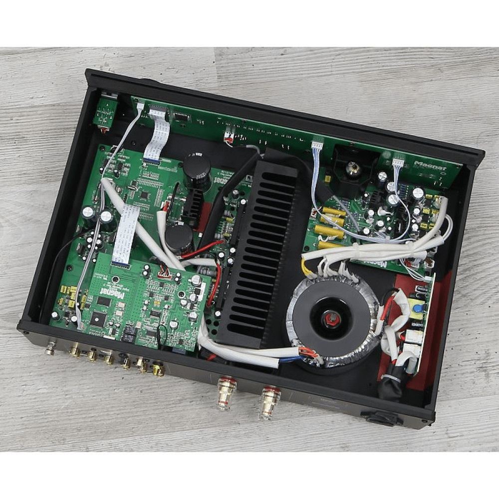

Your amp is a generic device most likely made by the same manufacturer as Magnat and in this case, the clone of a Magnat Ma-600
Wow. That's a carbon copy of what I have with a different badge on the front. Everything inside and out looks identical. Thanks for the info!Magnat Ma-600

It has a valve pre-amp, EC88 in the Magnat, which is priced above Marantz and Cambridge Audio...!

Just obtain a spare tube, supplies can be erratic, it is a wear item.
Do give it a clean and tighten, as it was obtained used, though it looks clean enough. Particularly on the heat sinks, do not over tighten those fasteners.

Enjoy the music, do not let it get too hot, bad for electrolytic capacitor life, and that of the chip amps.
