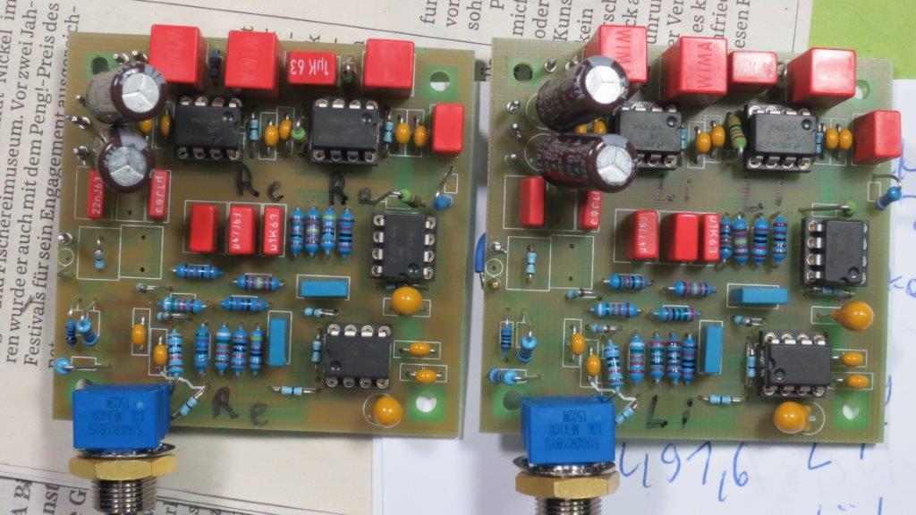

I have built several LT-transforms for subs - thanks to Siegfried for his great work for diy!!!!
The problem is, and thats why it is not much used, you have to measure and calculate every unit individually.
First calculate any driver and its closed enclosure individually - there are a lot of programms ( unibox etc ) online - what sound pressure I need? what is the
closed enclosure volume etc. For this calculation the TSP-Parameters of the manufactors are enough!!.
Then build the enclosure!
After the driver has worked at 20-30Hz ( open air ) at 10W for a day or longer
, put it into the enclosure.
Then measure its DC-resistance - not with a multimeter, but precisely - I used a precision current source with 10,03mA.
The next thing is to measure the impedance curve of the speaker.I used LIMP of the ARTA Softwarefamily - be sure, that the comparing resistance is exactly.
Than go to SB-Acoustics website,they have there the mathematics, that you can determine Fs and Qtc from your measurements.
After this you should use one of the different excel-spread sheets to determine the values of the needed components ( capacitors and resistors ).
In my design I used one capacitor exactly ( 100nF - buy 1% or measure ) -
the other capacitors are 3 in parallel - just calculate and measure - you can acieve less tan 1% tolerance.
The resistors are 2 in Series - just use 1% E96 or E192!!

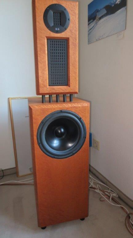

The Speakers in my Box are Scan Speak Revelator - 25cm - very good and
expensive Speakers.
Instead of a volume of 200l they have 47l and a fs of 15 and Qt of 0,5 ( by LT-Transform ).Before the LT-transform I used a HP-Filter with 15Hz and low ripple, because of subsonic frequencies.The Subs are powered with ICEPOWER 125ASX Modules with an upper limit of 300Hz ( minidsp 2x4HD ).
Acoustically they are overwhelming!!!!
Just hear " hell freezing over" from EAGLES " hotel california" and you know , what I mean.
It is a closed System with very low ringing - just simulate in opposition a bassreflex with this drivers!!!!
So: LT-transform is not for commercial use because of much individual measure and calculation.
For DIY-use it is an tool - giving a extremly good bass from moderate volume of sealed enclosure ( but with a lot of work!).
