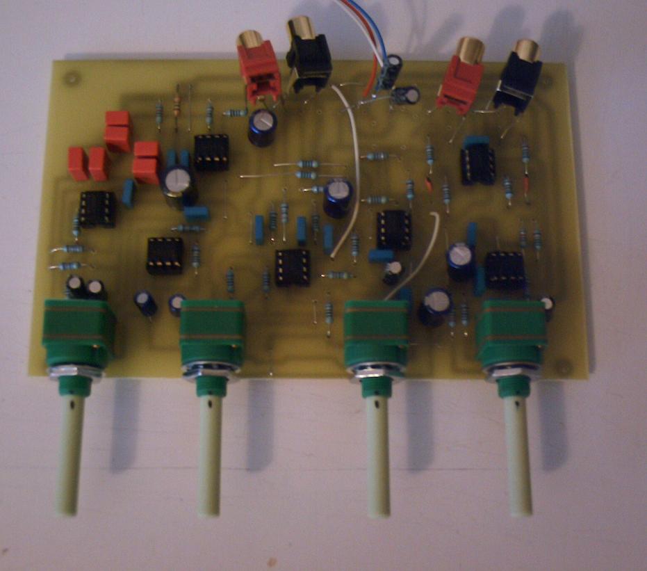

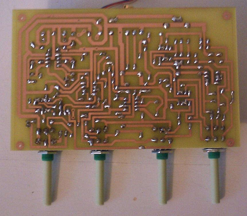

Update on this... I prototyped the design and have to say I am very impressed. It's far more useful than "conventional" tone controls due to having continuosly adjustable turnover frequencies and a "return to zero" curve... meaning that it doesn't boost frequencies outside the audio range.
If I ever incorporated the design into a future amp build I would definitely look to using FET opamps and eliminating the electrolytics... but even so... built as published with NE5532's it's excellent.
The only FET opamps I had available (needing 7 of them) were TL072 which often sound better than 5532's particularly as a quick swap in a CD player I/V convertor and filter, but not here... the 5532's are pretty faultless to me 🙂

I've sat on both sides of the fence when it comes to eq and tone controls... so thought it about time to experiment a little.
I agree with you, some recordings do seem to benefit from a little correction in the right places... and doing it "right" is vitally important.
This tone control stage doesn't wildly accentuate or attenuate in an all or nothing way as most seem to do... it's far far more subtle than that, and makes a real difference truth be told.
I am sure you find yours is similar too.
I would seriously consider adding this to a future complete amp project... it's that good.

Some may be wondering what the tone control stage actually does in Self's pre-amp. Attached is the measured curves from my build on my own DIY pcb design, 8 yrs ago. Similar to the original in layout, but not in tracking.
It provides the normal boost/cut but with variable turnover frequency.
Snag now is crackly pots. Mooly, where did you get yours. Are they conductive plastic?
