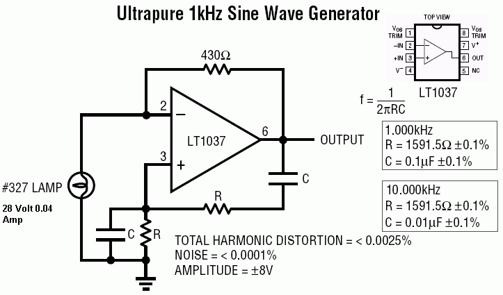

Hello Steevo
There is also this very simple but very low distortions sine wave generator.
You can replace the LT1037 by a low distortion Opamp.
Bye
Gaetan
Bye
Gaetan
Hi latala i would appreciate any help, circuit and tips aid in building one.
the low distortion signal generator look good, Do i need to be carefull about the PCB layout for that design to get the performance.
Steevo
Steevo
